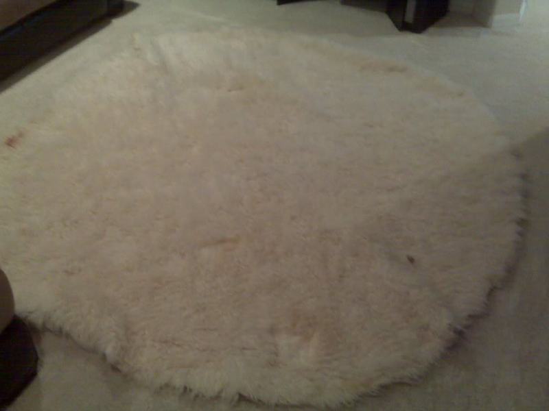

I don't do a lot rugs. Here is a rug that I need some recommendations on cleaning. Medium urine smell from a couple of oversized rat yorkies. Couple of spots, but mainly urine smell and some spots.
Maybe some aussie chaps can chime in. Sorry for the cell phone pics, in advance.

Its probley lambs wool with a poly backing. :lol:
I'd wet clean as you would a wool rug. Their cheap rugs.
Dont forget to groom it when your done.

Just vacuum real well, pretreat the urine spots with a enzyme product and pretreat the rest of the carpet as needed. Pre-agitate. Clean it with 200 PSI and go for it. Then post groom and dry.
The mineral content of the urine can damage natural fibers, so they may not come out.

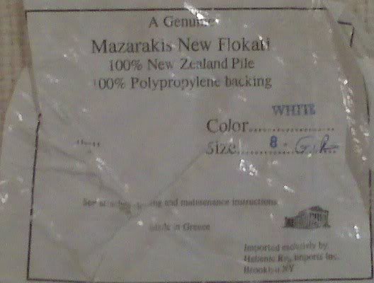

Washing in a tumbler style washer would damage the backing, and cleaning with a wand or rotary will damage the face fiber. Soaking and roller agitation would be the safest and most thorough way to clean this type of rug.
I seem to remember something about Hellenic Imports having to recall a bunch of rugs for some reason. You might check into this and see if the customer can turn it in for a replacement.

I have used a wand on these type of rugs for years and have never damaged the fibers. :shock: I just use low pressure and groom it right after cleaning and they look good.

Some with strong backings can be cleaned in a commercial washer with gentle setting, but not all can be cleaned that way.

I have cleaned a bunch of these- My preference is on the floor, laid out flat, clean with an upholstery tool.
However, these were the top quality Flokati, not ones with a cheap poly backing.
