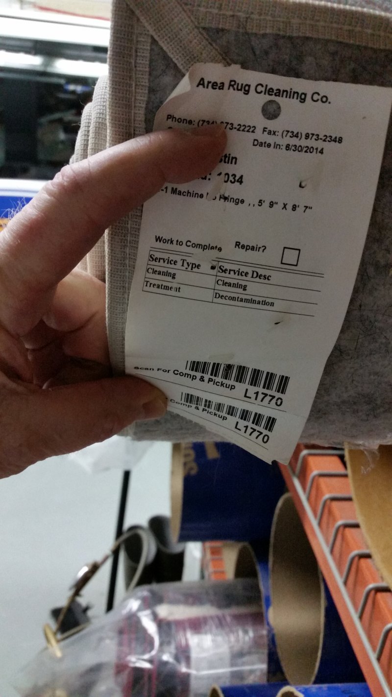

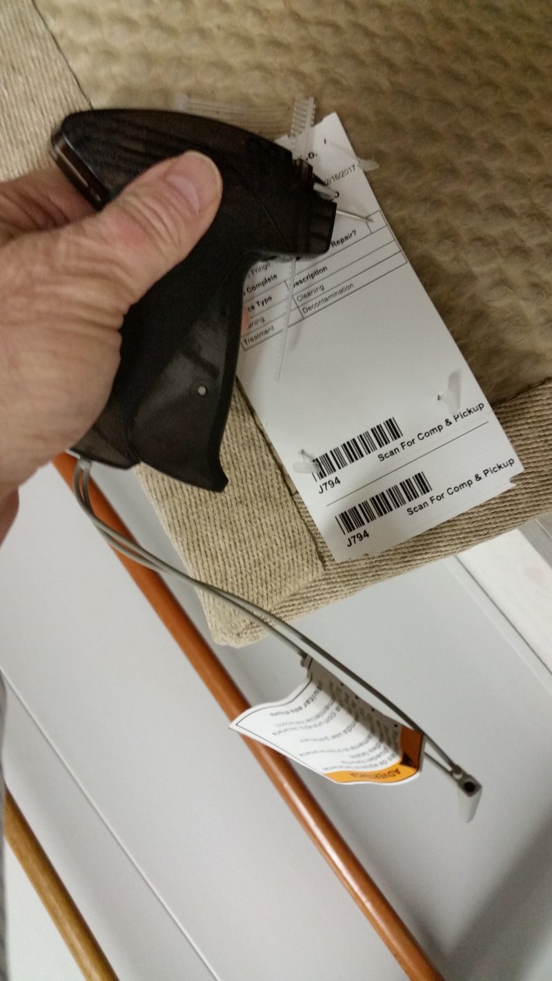

We print our own Tyvek tags. (But of course we have our own software and printer) We shoot at least 4 fabric tag fasteners in each one.

Try 800.352.7510 for information if you like this standard one.
28,154
I do like that standard one but it would be nice to have that reinforced grommet sized smaller so that it could be used with the fabric tagger. It would be nice to either have it in duplicate or just have a numbered tear off to leave with the customer. Using a couple of plastic tagging wires on each would probably suffice.
