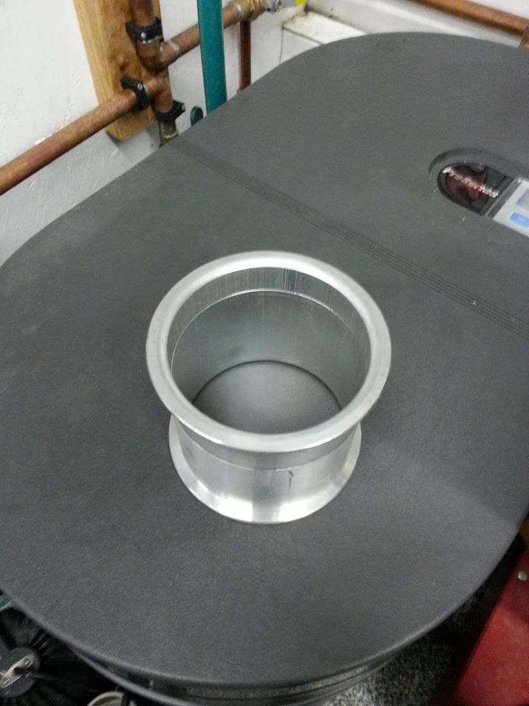

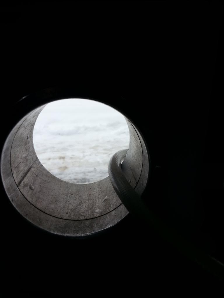

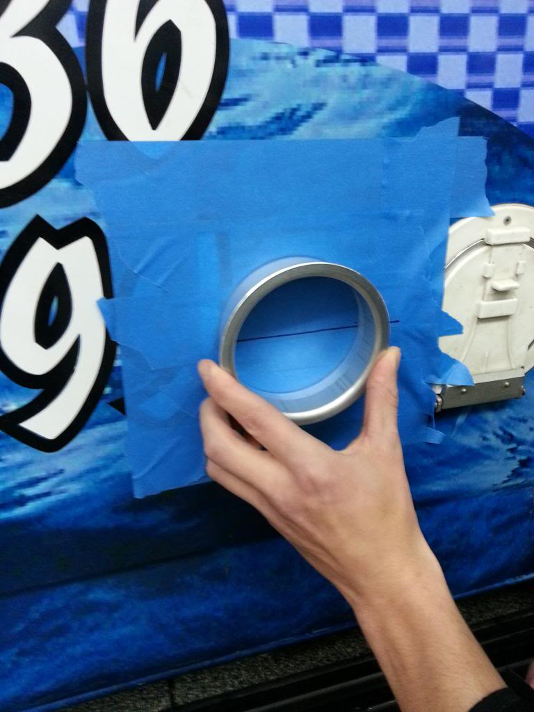

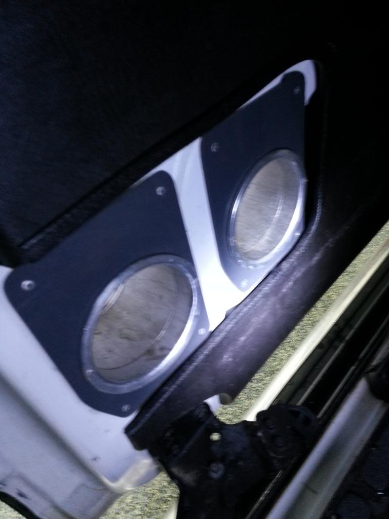

Going off the picture on the 1200 it has the same vacuum port and about in the same location...turn it and re-plumb it out one of the back barn doors.......

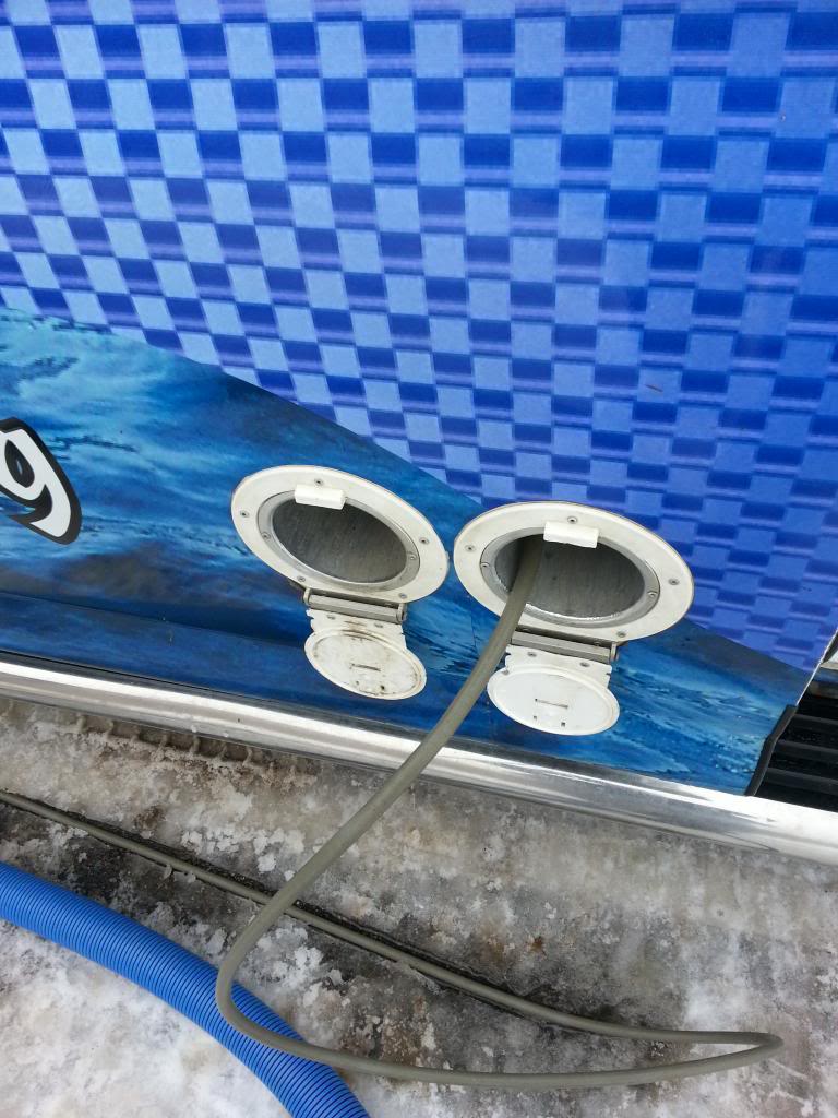

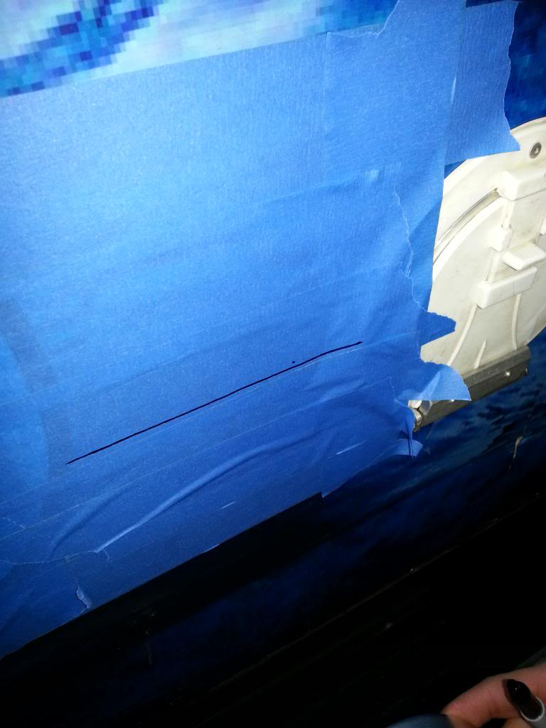

I thought my response was targeting the heart of your question. If you put the pork hole immediately opposite to the hose reel, you can't open the door. If you put it at the other end of the door, the slack created allows you to open the door and not create stress on it.

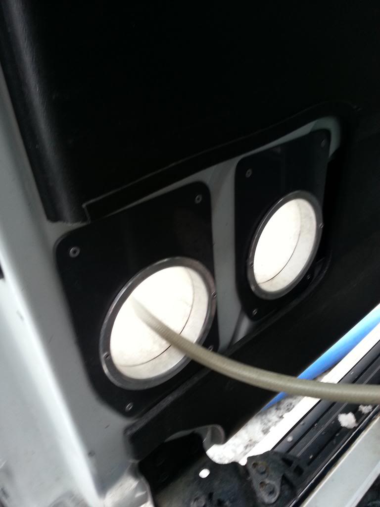

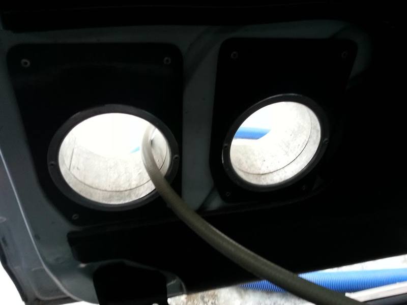

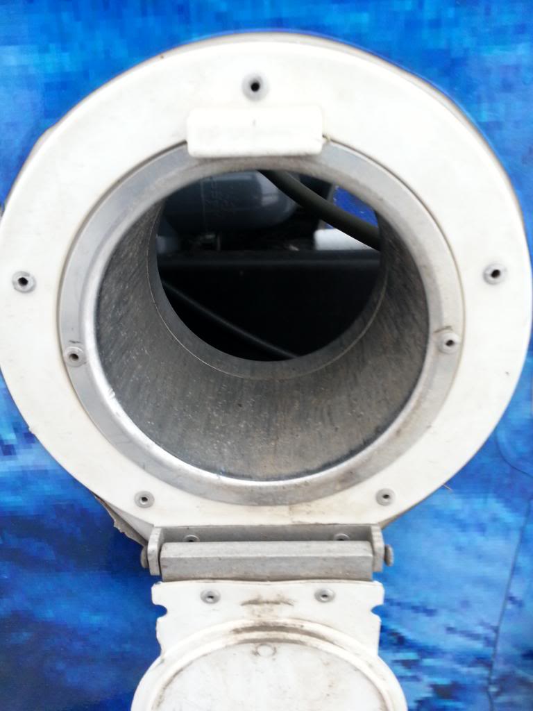

  • Jim, the cds ports are on top of recovery tank, on pro 1200 they are at bottom right side (very close to the end of the sliding door front side. Trying to avoid running from back door.
  • Fred, the side step is a possibility though it will have an extra bend (a little loss of vacuum) and may force me to put the chemical jug somewhere else. Working with a standard size van (a necessity in S.F.) and trying to maximize space, as I have the baaaaaaad habit of carrying a lot of chemicals and equipment with me.
  • Mark, that is very neat and thanks for the pictures. Is opening or closing while hose in create any issue? What's the distance from door to where hookup is?

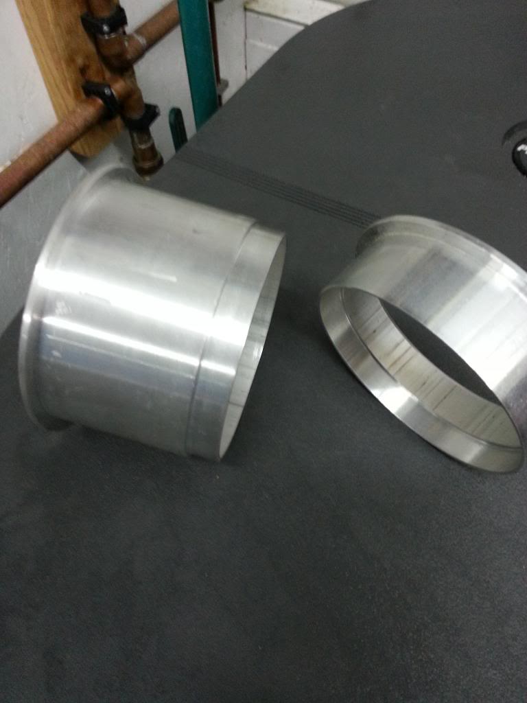

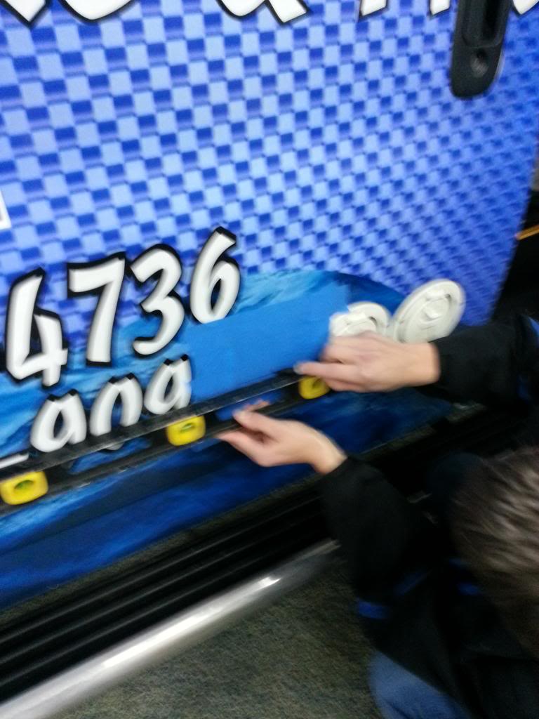

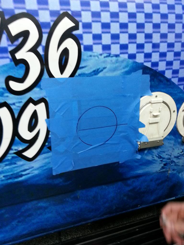

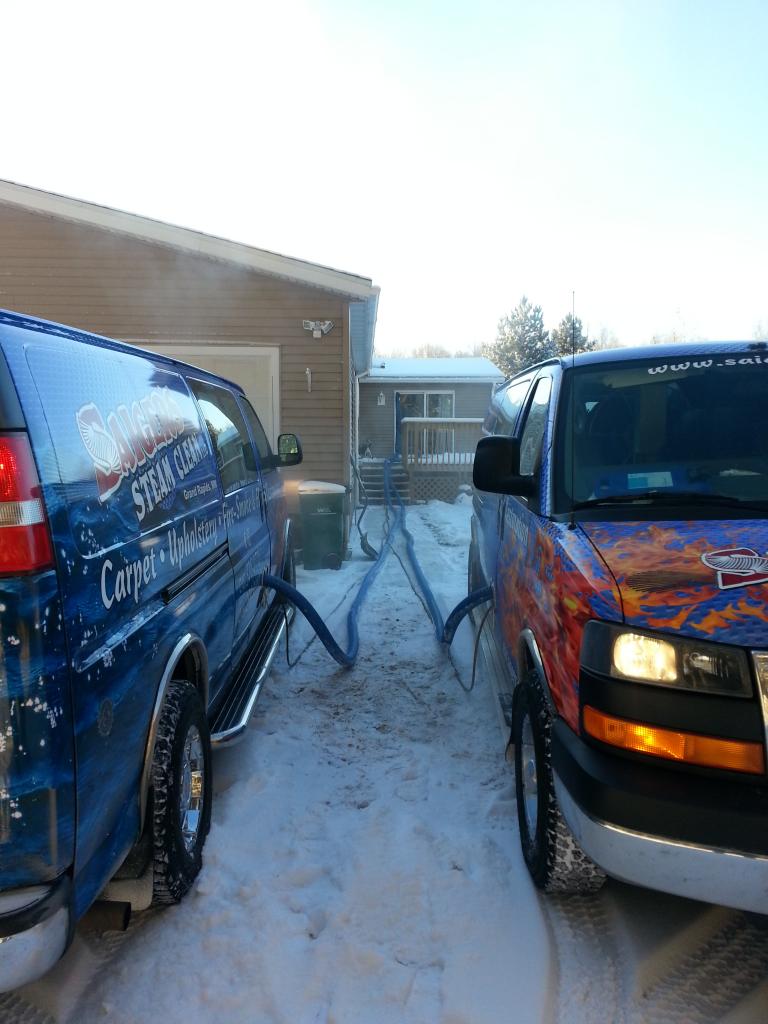

Hopefully you just got a chance to see the videos posted (while you were both posting your threads)
The videos will maybe help with all the ideas mentioned.

yours is right where mine on the 570 is...its a tight fit...and I am not sure you going to get enough bend out of a hose to go into a port hole and still have a moving sliding door....if you manage to get a bend in it then I would put a travel loop in the hose so it can roll with the door.............

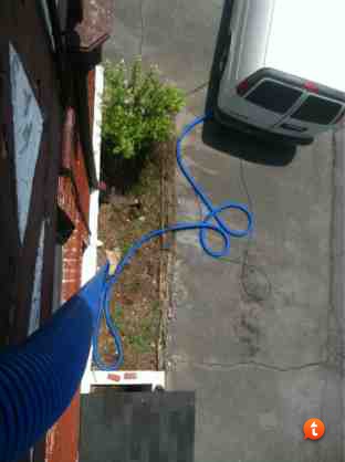

a circle......hook to the vacuum port....run hose hose down the floor put about a 2 foot circle in it and put it threw the hole.......wala...a travel loop........it will move the hose freely with the door and nothing will bind up........
