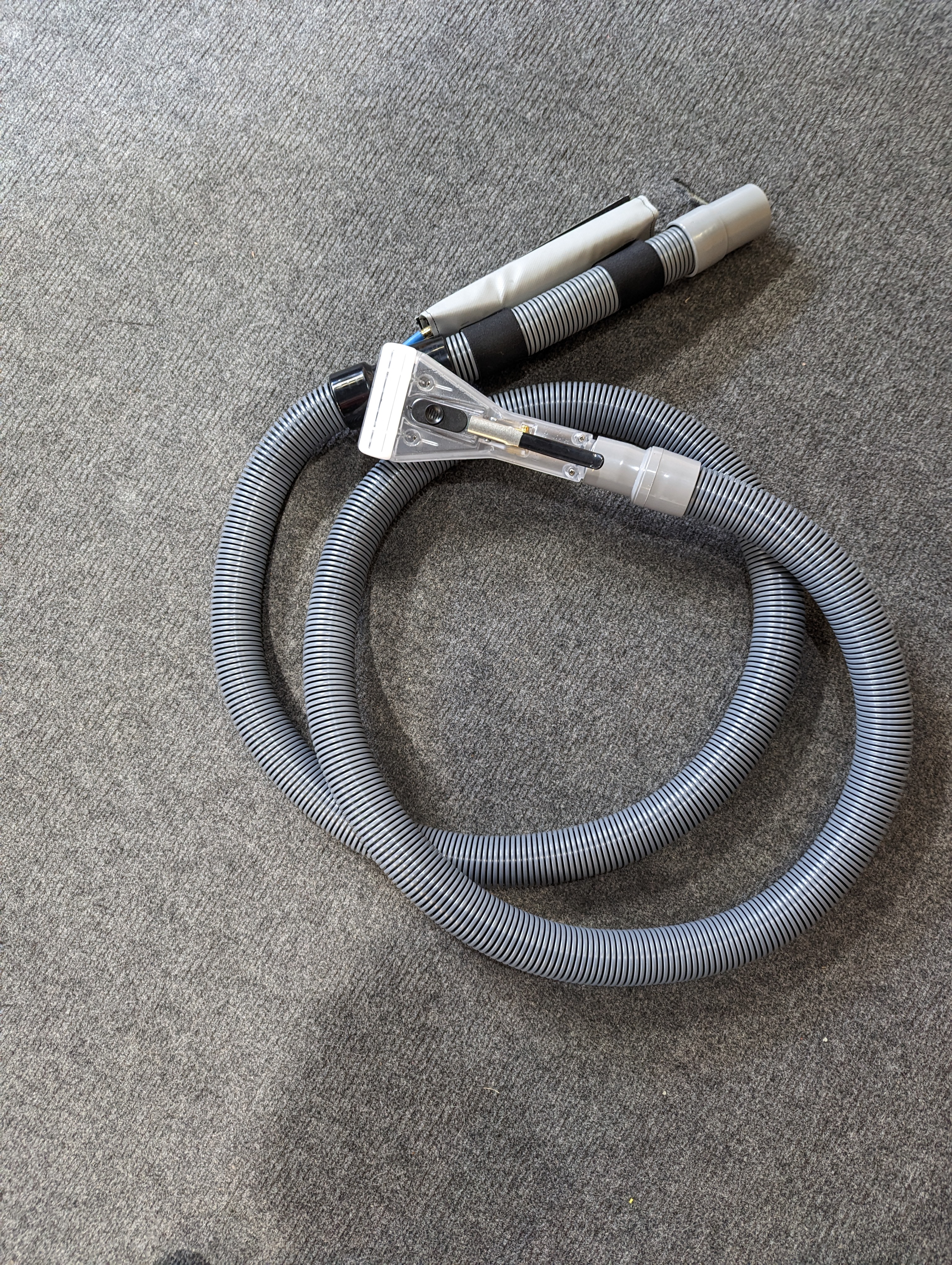

Just received my new Sapphire Upholstery Pro today. So easy to use compared to the Rotovac Shear-dry. Liking the clear head. Actually looking forward to my next upholstery job. Always fun to play with new tools.

The hose length sucks. I changed mine out to 18’. The hide-A-hose solution line sucks aswell… changed mine out to a stainless steel braided…
I also added shrink tubing to any and all connections inside it. The needle valve has a mind of it’s own… don’t expect to set and forget.
The vinyl wrap on the needle valve is useless…
I had a new one made up….
Other than that, I love the tool now, and it’s a money maker for me!

I had a new chunk left over of1.5 I bought (50’). I used 32’ of it for my pool.
There was an 18’ piece left….
After using it at that length, I’d never go any shorter.
Using it on giant sectional sofas, a guy can wrap all the way around, and not drag the connection with them.
Also particularly useful when doing commercial offices, you can bang through office chairs like nothing. (Office chair, and 2 client chairs per office), all the while leaving the connection @ the door.
Surprisingly useful…
