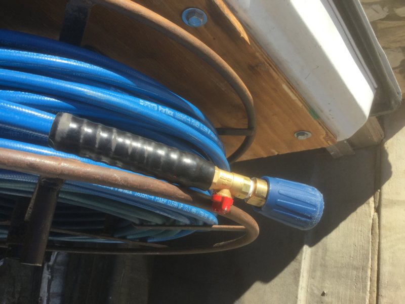

100 foot parker with bend restrictor spring and rubber sleave, Joe valve and female brass with plastic protector.

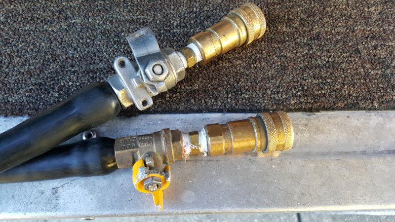

I use what Mr. Warrington posted.

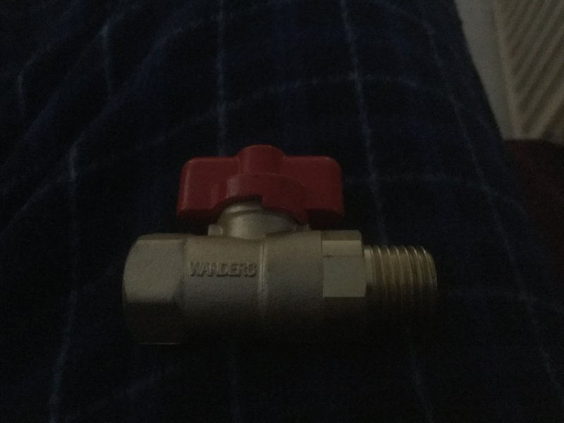

The problem with the red and blue ball valve have is the screw holding the handle comes out in 2-3 weeks and I have to glue it back in. After that they are good until the handle breaks off. The yellow Parker ones the plastic handle grinds down too fast for me.
Sometime I have to take them apart and put some pipe dope in them to keep them from leaking.
