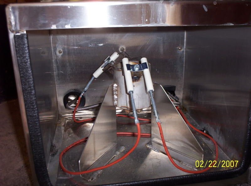

Here are some more pics of this unit...after having it for a day I like it alot(not in love YET)
There are some things that you have to tweak to get it to run with "our" low flowing TMs...
1.Bigger jets....duh
2.some 3/8" hose(which i will soon get more)
3. turn up the pressure a little more(if you have glides and 2" hose)
Also if you were to put it in a van, you will want to get an exhaust made up...cuz woooo the heat out of this thing..

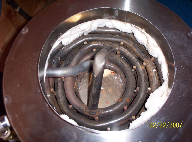

this is the top, it has that plate welded there cuz it can and does shoot some flame out the top..
picture of the burner...unlike little giants with multiple little jets this has to larger in there 1 for 1st stage(180k BTU) 2nd for 2nd stage(360k BTU). it looks like a mini hot air balloon flame
picture of the 2 toggle switches, the flow sensor and inlet water, propane inlet on the bottom(wished it was else where, to easy to kick) also they send a regulator and a psi adjuster for the propane flow...
all in all i think this unit will work wonders, once i smooth out the kinks that come with any new purchase...and needing to make it fit your needs

My only concern with "black pipe" gas pipe coils is....can they degrade and rust or anything like that?
I noticed they charge a LOT more for a stainless coil, what size is that pipe? and how many feet of it wrapped there?

explain the flow switch?? well if you don't have the proper GPM it wont fire the flame....i had 2 03s on it and fired, until it had engine lag from the vac then it didn't, so i bumped it to 2 06s and was firing just fine...oh and i went 3/8s from the machine to the heater..
it is schedule 80 black pipe, it'll take quiet some time to rust through...and yes YOU MUST PURGE before you clean..you could probably drain it after the days jobs and not have as much...
I think he told me 200' coiled in there..i don't remember that total number...i know when i first hooked it up, it took a little while to get flow out the other side. I think its either 3/8 or 1/2"
