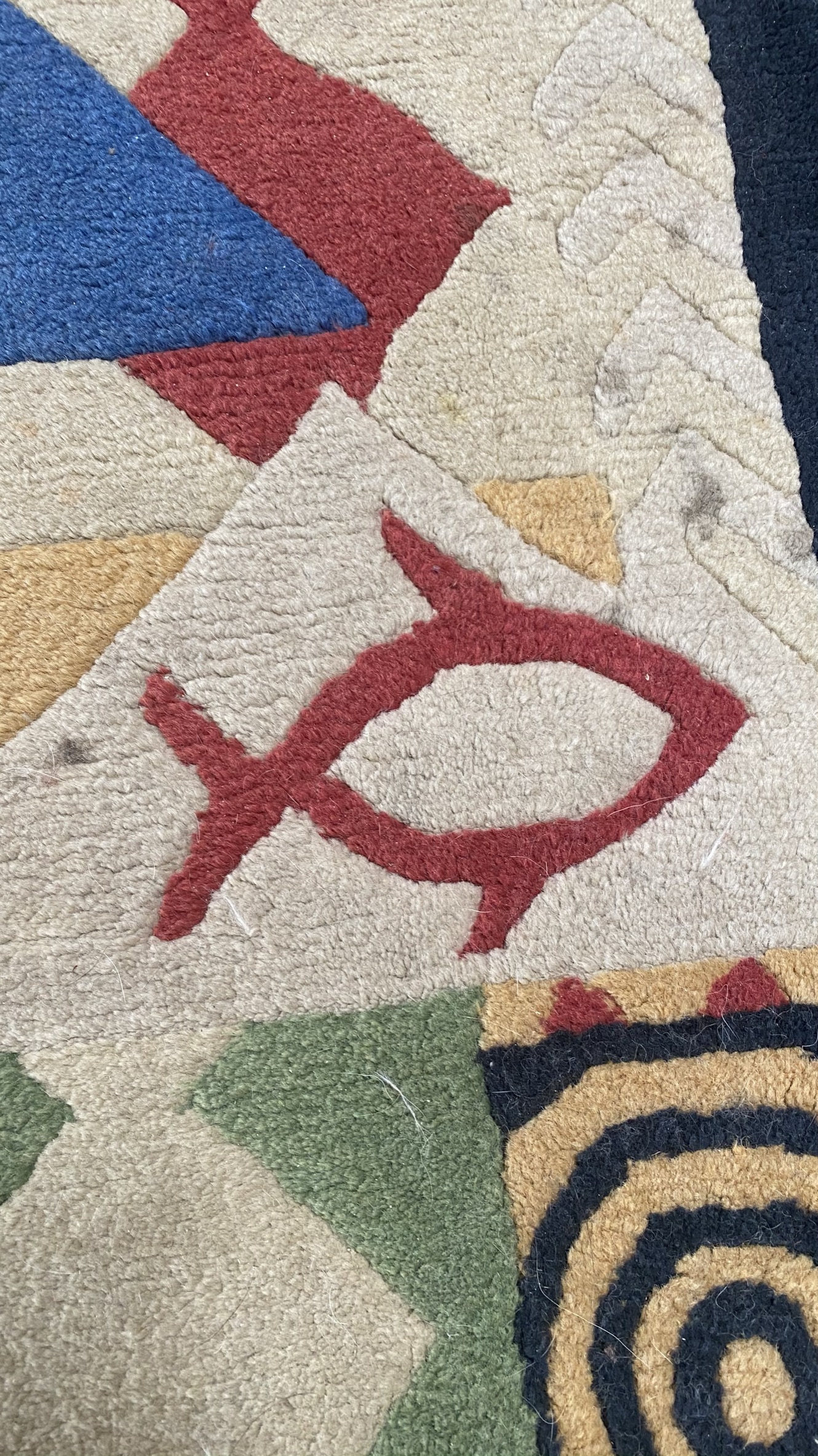

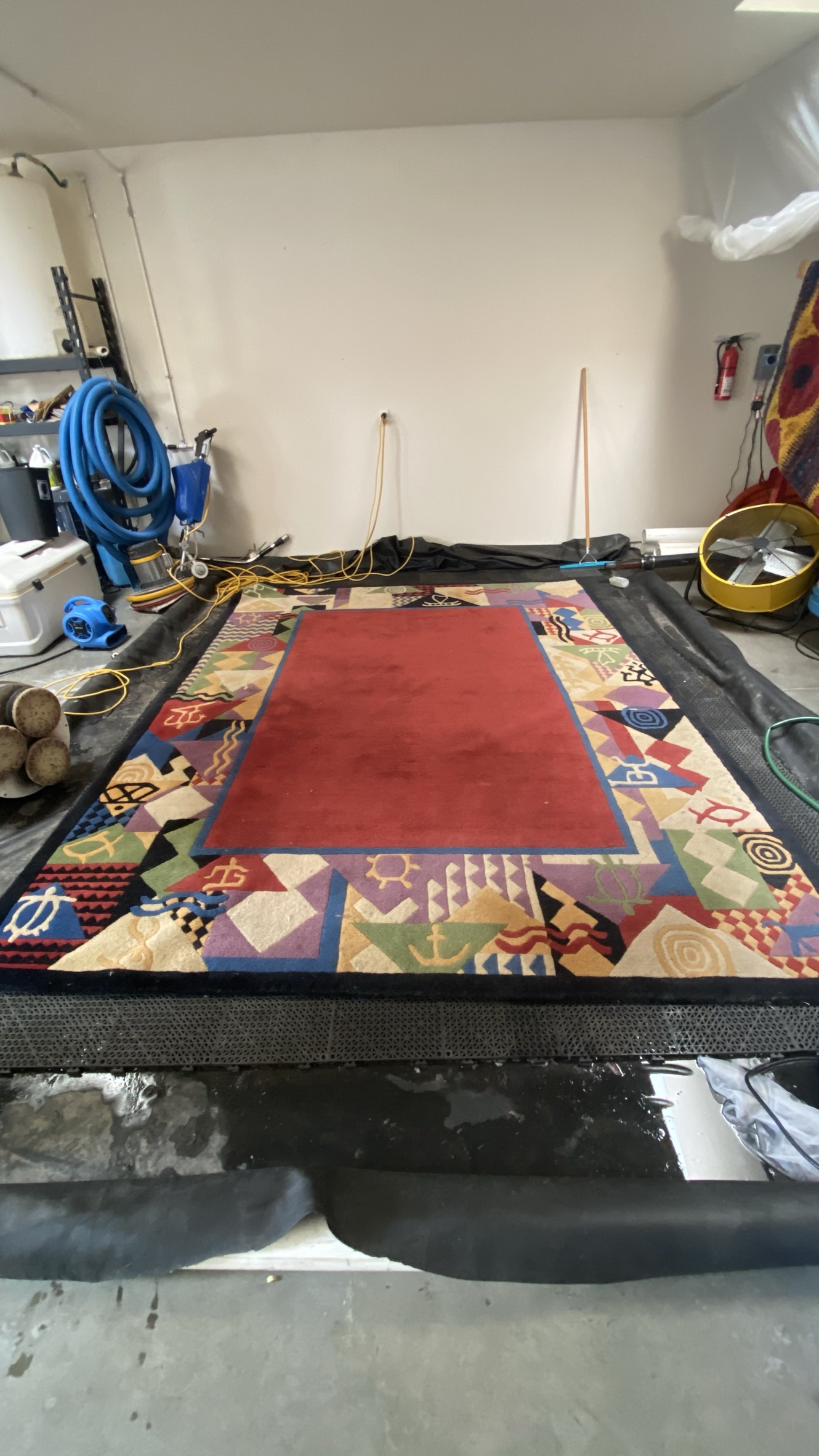

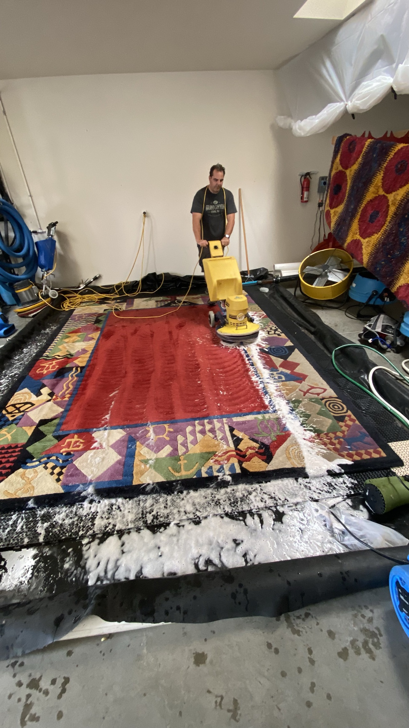

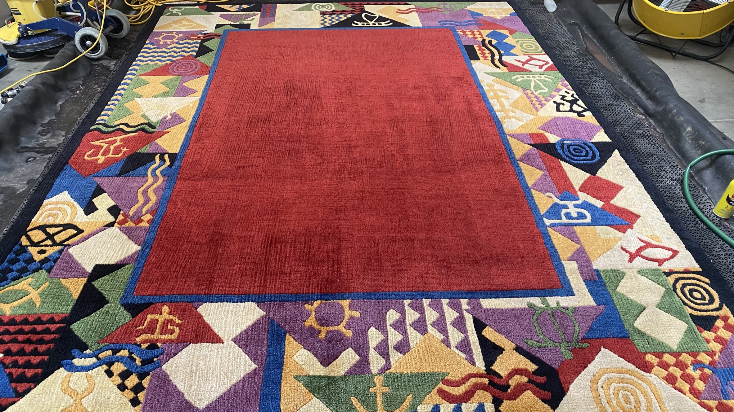

I cleaned a couple of rugs today with the stuff. I'm pretty happy with the results. I mixed it at 5 oz per gallon and applied it with a Cimex. Had some good scrubber bubble action going on. The last rug was too large and heavy to hang on the rack so I had to dry it in place in the pit. Here are some before an afters. It brightened up the rug pretty nice. I rinsed with a Hydramaster acid rinse specific for oriental rugs.
BEFORE:
AFTER:

Actually, Now that I think about it, I used 3oz per gallon, not 5. I was not thinking straight when I got home. My arms were worn out from flushing rugs. They can be a lot of work. Even at 3oz per gallon I probably used too much. But it worked good.
