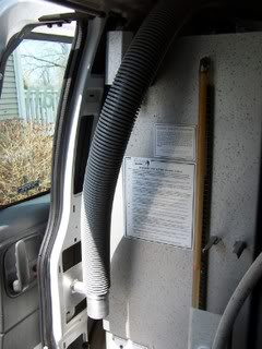

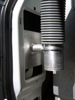

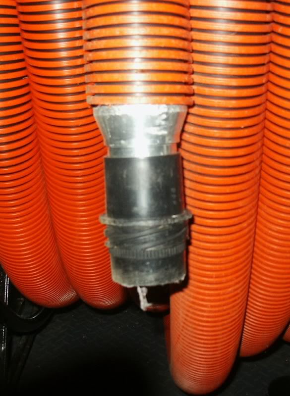

Here is a GG 2.5" Reducer:

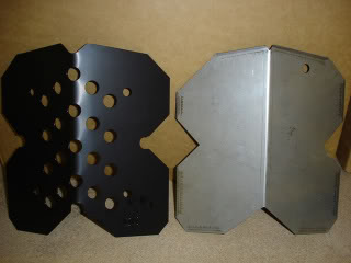

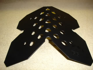

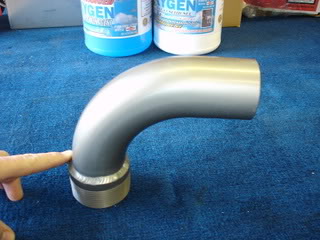

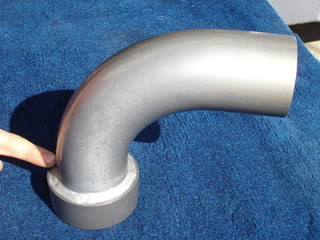

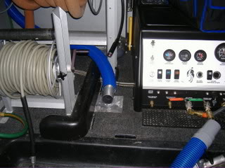

And a few other Butler parts to help with airflow:

Greenie,
Send me those smooth bend lid hook ups. Are they for the larger blower? Just put it on my card...again. I will call in the morning to make sure you got this message.

I appreciate the help.
But those are not "reducing cuffs" like we use on 2"-1.5" hose. Perhaps nobody makes them......

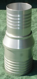

Your looking for something like this right?
I haven't seen one made for 2.5" to 2"

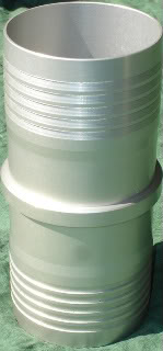

Here is what most are using since most people use cool cuffs
Reducer
Then put a Male On that
The you can hook up your 2" hose like normal (running female to male)

One final note for Dale, you don't actually "need" any cuffs, the machined reducer I posted above can be inserted directly into the raw vacuum hose, this applies to both hose diameters, it would be a semi-permanent connection and very secure, it would also be very compact and hardly even visible.

A simple reducer for 2.5 to 2, as per Greenie's instructions.
take Greenies aluminum reducer and jam it into the 2.5 hose
take the 2" coolcuff adaptor and jam it onto the reducer
It ain't coming off!!
Oh, when I say jam, I mean hammer! It took a fair bit of effort to fit it together. But it works great.

Or you can soak the hose end in a bowl of boiling water for a couple of minutes and simply slide the reducer into the plastic hose with little effort. Like the way we would put hose connectors into cuffs when it's 3 degrees outside. Praise Allah for coolcuffs.
