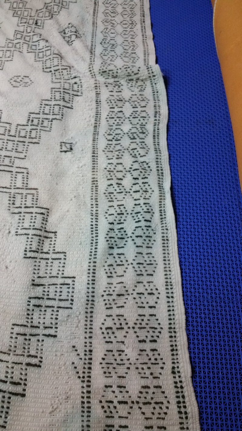

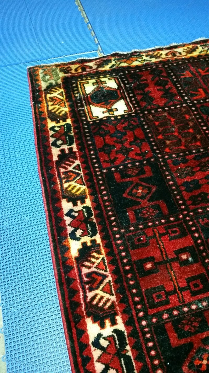

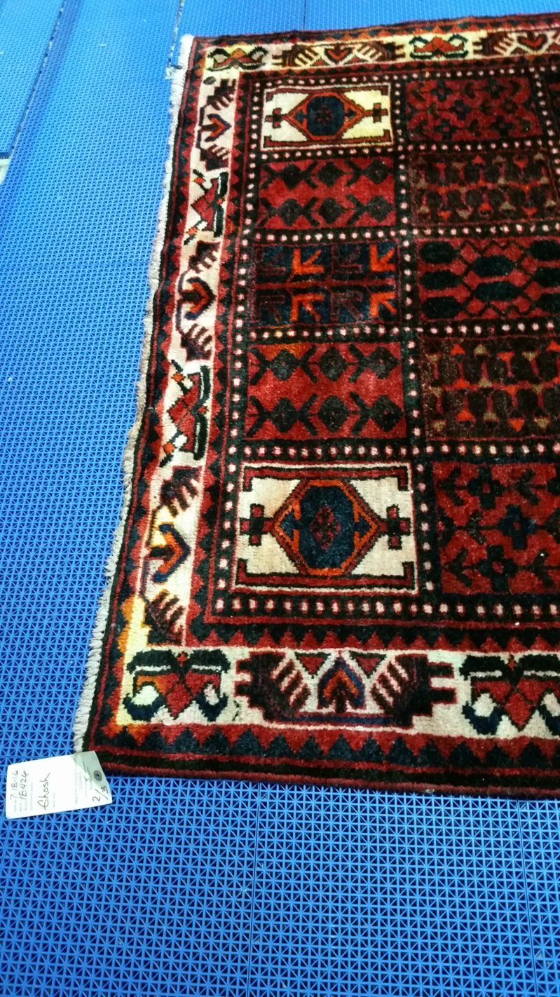

The red dye run is worst in person. the yellow of the white areas is where I used Magic. The white rug is the back of the rug cuz the dye run shows up better.1470348807902.jpg

I might have to send my tech to the rug summit with the rugs for retraining and trying to solve this problem.. On the white rug-- since stain 1 and red 1 wasn't removing the dye-- he used a mixture of vinegar and dish soap-- because that's what the internet said to do :hopeless::oldrolleyes:
