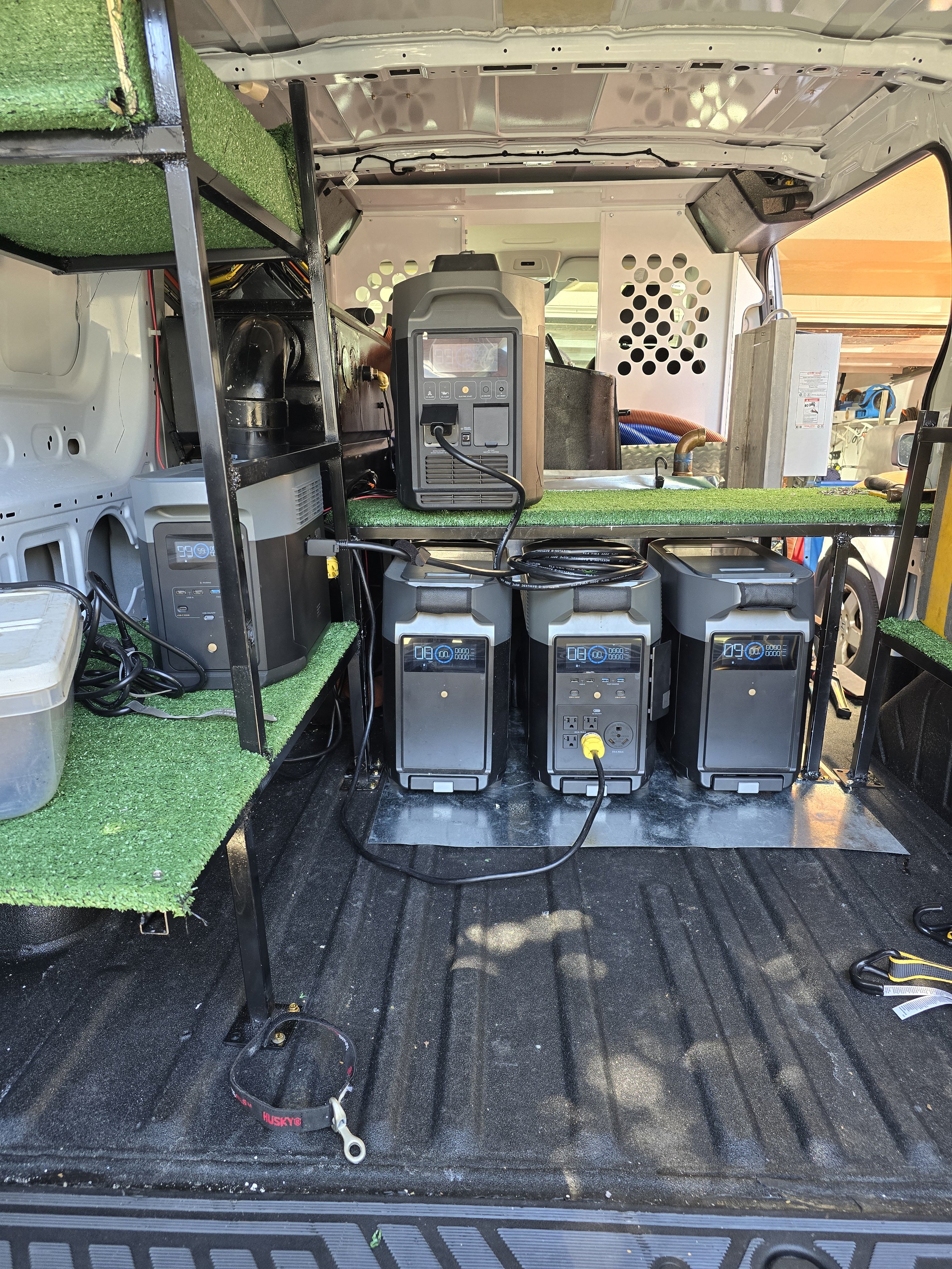

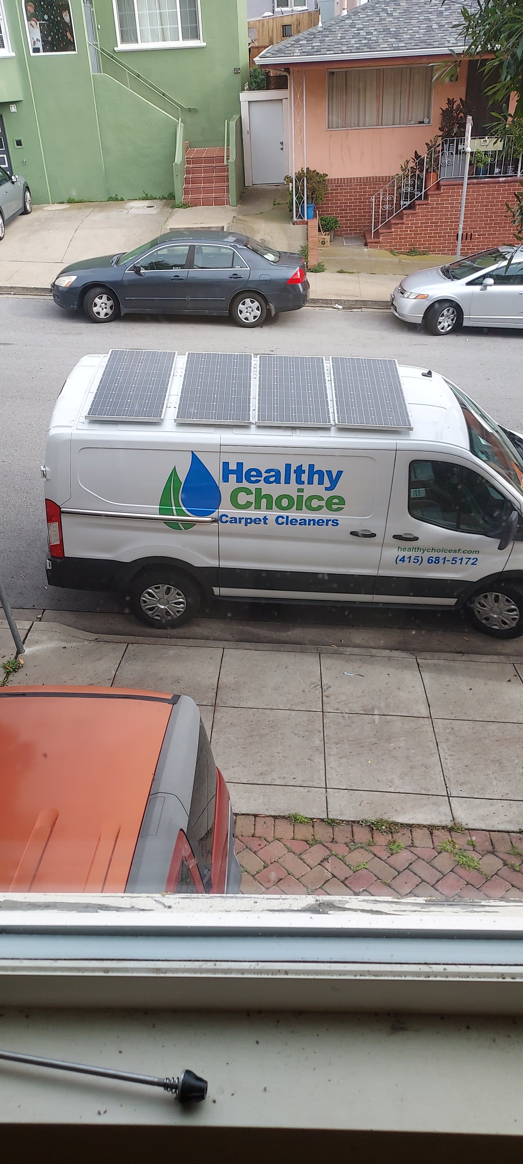

Ok, Thought I built the 1st hybrid solar cleaning machine.

8 blowers (vacuums) !? mine only has 3 and the suction is higher than my 370.
with 8 vacs, I would think his battery packs would be depleted after an hour. ( only a guess. did no math and pulled that number out of my ass haha)
I didn't see anything about heat. On the front of the machine it says something about cold water. Lack of heat is the biggest problem with electric truck mounts. Takes an enormous amount of electric power to generate truck mount style heat. Would probably still need a propane or diesel heater.

Solar is a very dilute energy source. I can't imagine that those 4 panels on the roof of the van even make up for 10% of the systems energy during use. And one would need a seriously epic/heavy/very expensive battery bank to get through a small job. I know its a hybrid. I just wonder how much the off grid aspect really supplements operating costs vs the initial investment..

I'd like to see the floor space it takes up with batteries, lectro mount, waste tank. 8k wt generator (for "long run" time*)
*being the cynical mofo I am...I suspect after the first hour and half long job (IF the batteries last that long) the rest of day's jobs will be running the generator to feed porty vacs.
Unless the van alternator feeds a "fast charger" to get an 80% charge in a 20-30 minute drive to next job, you'll running the gen on every job

That would make more sense, if they put a serious DC to DC charger off of the van's alternator recharging between jobs. Still the whole idea seems a bit loopy to me. Guys need like 6 to 10 fully charged 100 amp lithium batteries to run their RV air conditioner for one day in the desert. A tm demands serious juice.
I do have expensive battery packs which are charged by my solar panel on the roof of my shop and can also be charge at ev charging stations.
But you are correct, solar not as good as gas. This was a vanity Green wash project. But haven't had to pay for fuel yet on my EV van.
you can see the setup in my photos. I could have redesigned to save more space. but this is 1st version.
Probably correct. it won't be my main van.
My van is an EV, so I don't think it has an alternator nor a way to power one. however I can charge my batteries through a 12 volt outlet on the van. nice touch but sorta lame. but all the little bit help.
