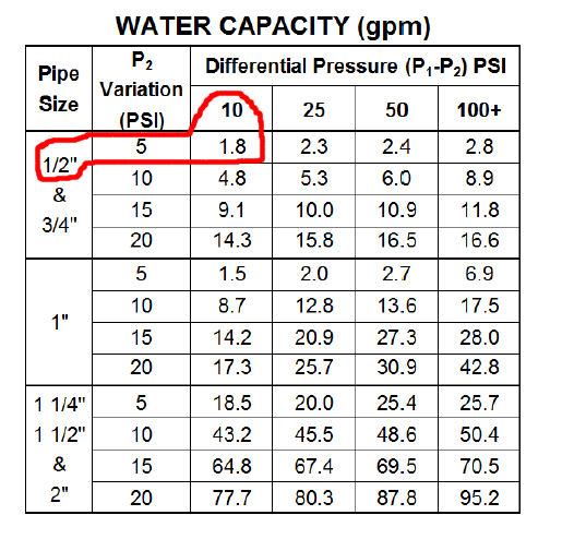

I have attached the datasheet for your reg. At a differential pressure of 10 psi (like 25 in, 15 out), your reg has a capacity of only 1.8 gpm, and that's at a pressure reduction of 5 psi (the 15 psi out will drop to 10 when flowing 1.8 gpm). So at the very low well-water pressures you are operating very close to the limit.
So, setting the reg to work properly at that low pressure, then adding the pre-regulator when the inlet pressures are normal is a good solution (in my mind at least).
