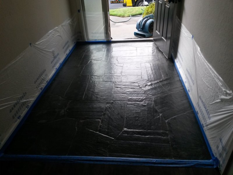

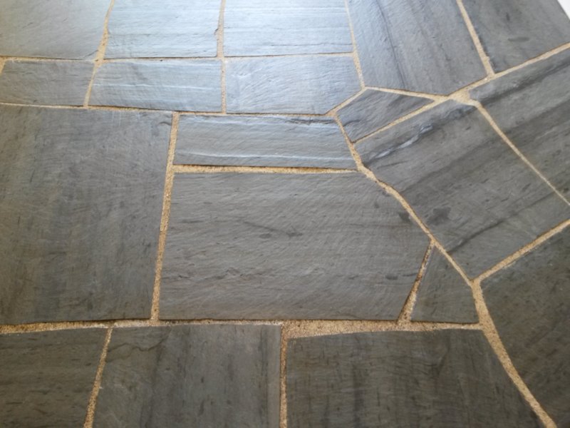

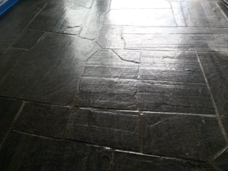

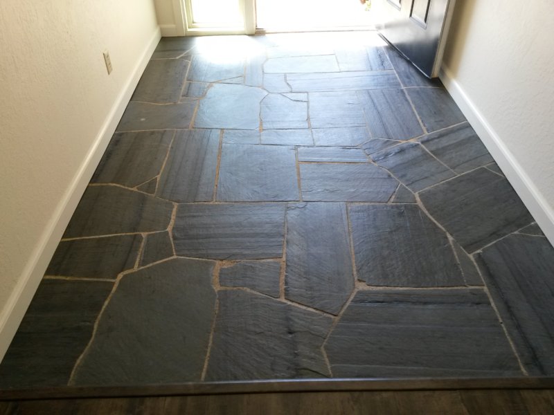

Not fun work but it has to be done at the right price...20 years of Mop N Glow on a slate...price it rght

I priced it by time since it was an entry, under 3 hours of work for $500, as you can see on the after pic, those high ridges had to be touched up with paint stripper and acetone after I took the picture

Nice job, what stripper did you use, if you don't mind me asking.
