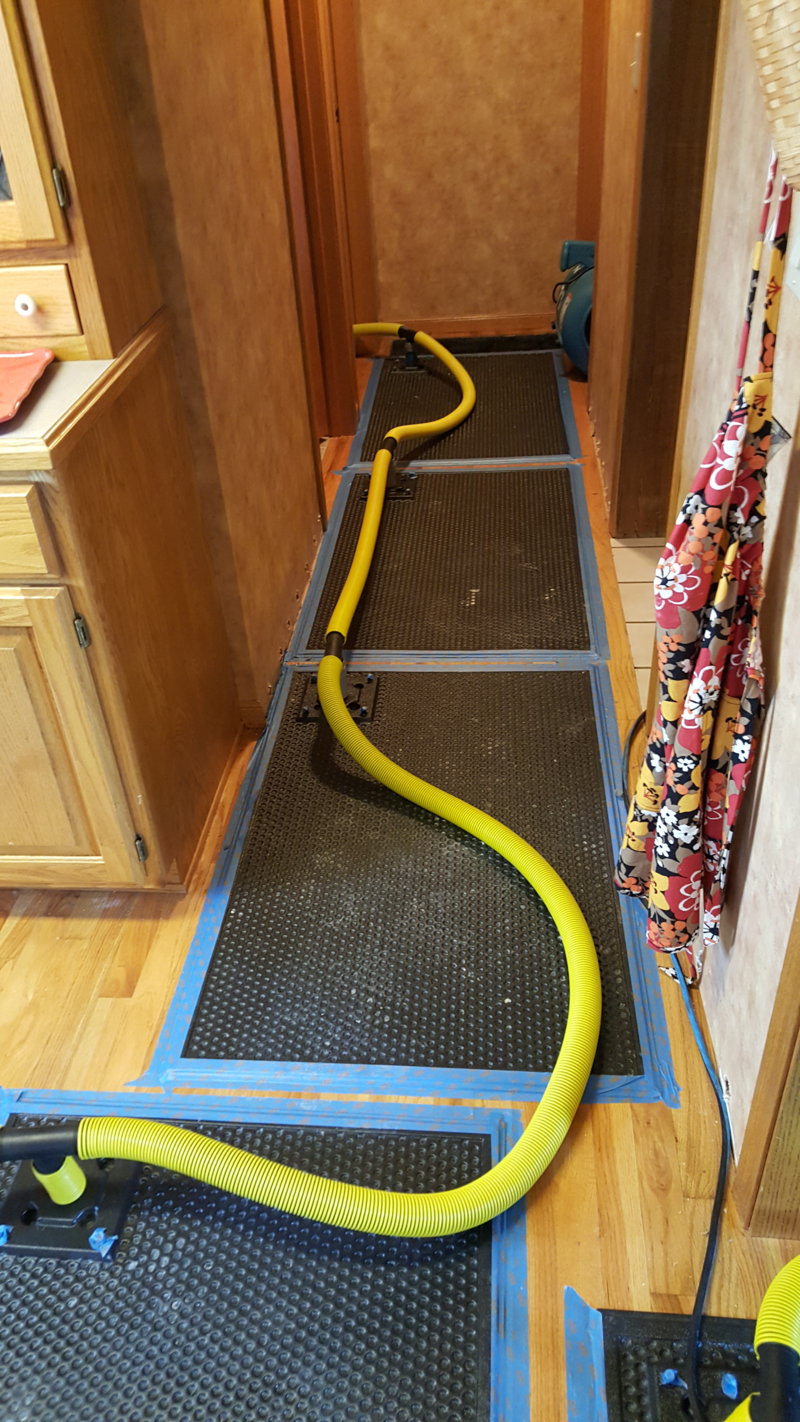

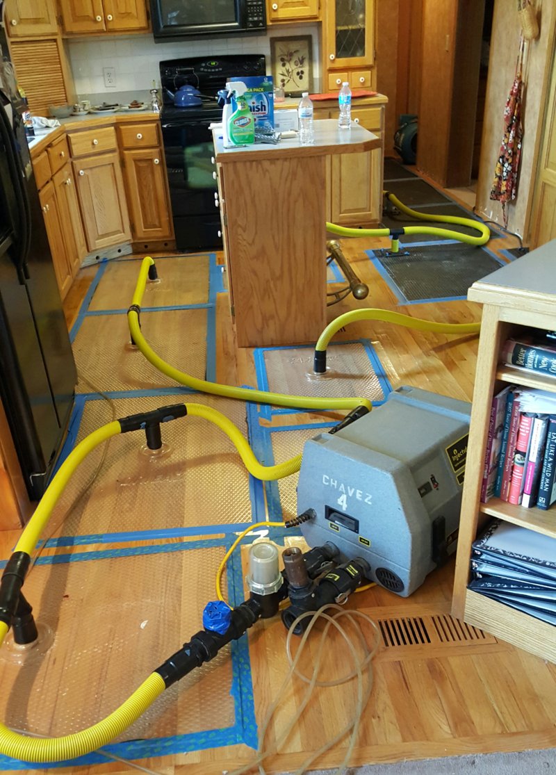

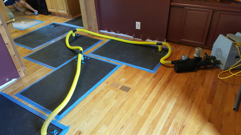

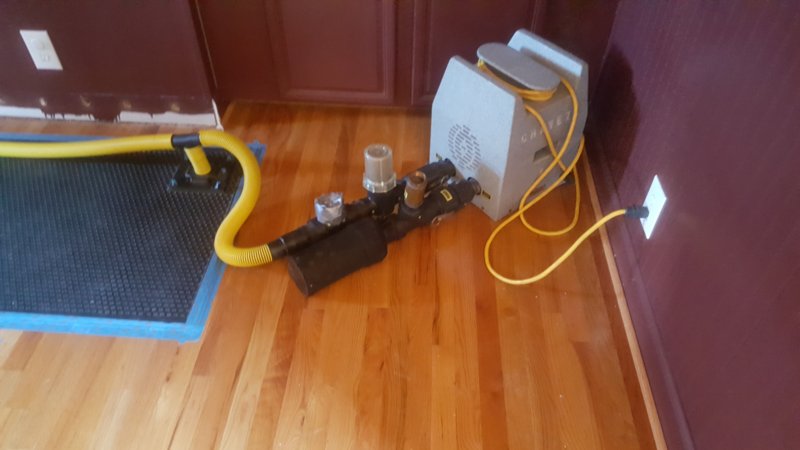

Homeowner was having new siding put on. As they ripped the old siding off the pulled a pipe loose under the kitchen sink. Wet a couple of small areas in the living room carpet. Wet out the kitchen, entry, hall hardwood, then dropped into the return air and down into the basement. Down stairs it damaged the drywall ceiling, walls, carpet & pad in the family room and den.
The garage got blasted as the main water flowed down through the fiberboard duct work.
This is the 3 Injectidry's and floor panels setup.

View attachment 17635 View attachment 17636 View attachment 17637 View attachment 17638
Positive or negative on the injecti dry?
Negative. We're pulling from the top.
We may need to positive pressurize the cabinet box frame.
I don't speak English well enough.

Nice job Richard, your single point mats look much neater than my 8 point mats.
The vacuum mats will pull up to 3 feet in either direction length wise but should not be placed more than one floor board width wise. I tilt or stagger my mats to get better coverage on the width of the floor.
I also loop the vacuum hose back to the power head so I get equal negative pressure on all mats.
Putting painters tape under your Dr. Shrink or Preservation tape will make it less likely you pull finish off the floor when you pull your mats off the floor.

How old is that power head?

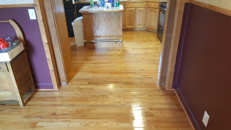

Provided the floor planks aren't too wide and you have access under the floor the cupped edges will lay flat quickly without the need to refinish. Unless the tape used to hold the mats down pulls some finish off the floor.
Adjusters like to replace the floor because if the floor is not properly dried and the raised edges are sanded off the floor will crown when it finally dries. When the floor is properly dried it can be returned to a pre loss condition for a fraction of the cost of replacement and much less house hold interruption.

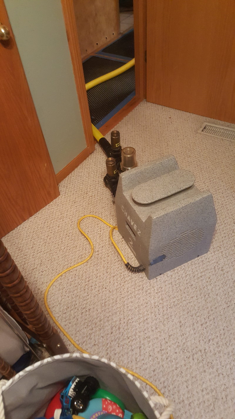

Sheet rock ceiling, wet insulation above....above that is a belly type liner. wet insulation and plastic barrier.
Heat and tenting upstairs only with the 2800i ducted under the sheeting. its doing good, we shifted some panels and kept her running.
I think that particular unit was a second generation Injectidry. I believe there was one style before we bought. We have two of the older style and three of these smaller units. None of the tall ones yet.

Rarely? It usually does. Rarely that it doesn't. :headscratch:
You have morons for adjusters. Not only is there the cost of the floor but collateral damage. Floors generally go beneath the cabinet. So move the cabinets and the granite counter top? :eekk:

How do you dry the hardwood under the cabinets (besides the holes with forced air)? I always feel there are too many unknowns with hardwood. You cant dry between the black felt under the floor, what if there are 2 subfloors?
I wish there was a hands on class with just hardwood floors........

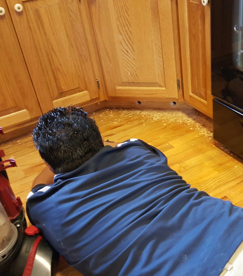

Same way, through the holes. Butt the panels up as close as you can get to pull beneath them.
Lots of things we have done. Pull the toe kick, removed the bottom board of the cabinet (replaced with luan board), pulled the drawers, pulled the cabinetry.
We use extra long probes for the mms2 to check the back drywall.
I agree many things can impede the drying. A few days after this job we had one that ran for two days and nothing. She didn't budge, insurance man was apperceive of the effort and it was pulled.
Most dry now and then you run into one you can't. We have one currently drying they setup this AM.

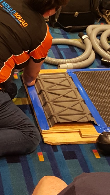

This is a new Hardwood floor Drying Concept that Barry Costa has been experimenting with.
He said by doing what we (the industry) are doing currently is putting too much stress on the wood. The heat is actually pushing the water molecule deeper in into the cells locking it in.
He is advocating using moisture to evenly wet out the wood keeping it out of stress. He suggests using moist heat from the exhaust of the injectidry.
The exhaust is branched off and sent to rafter mat (from Homedepot $1.97) which is taped down on three sides leaving the opposite end of the ducting in, open.
This hot moist air cause evaporation yet keeps the hardwood floor out of stress.
Using this push pull you’ll get better results while keeping the wood from stress fractures that the high heat is giving it.

My HP 60 I power head puts out an exhaust of over 100 degrees and climbs as the floor dries and the exhaust moisture drops to within a couple degrees of the ambient air.
How is this not stressing the finished floor?
That exhaust air is likely too hot to be safely pulled through the power head without potential damage. Especially as the floor dries and the exhaust temperature is no longer decreased through the evaporation process. (Just a thought).
