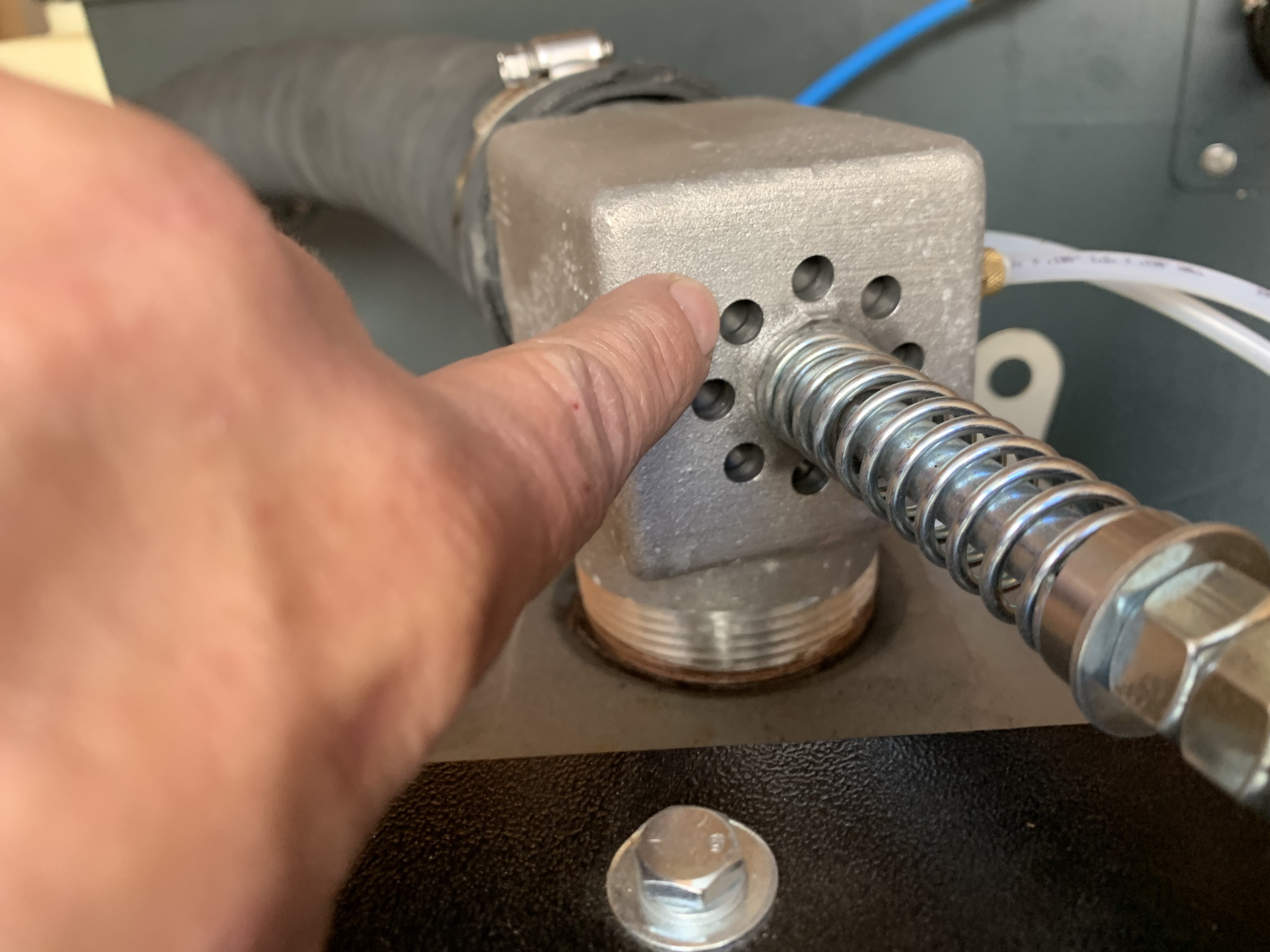

Started machine up today and blocked
Off vac port and it was sucking air (refer to picture). Also last step chemical would not prime. Please help

That's your vacuum relief valve. It's supposed to be sucking air when you block your vac port. Prevents your waste tank from collapsing. Should be adjusted so it starts sucking air at around 14 inches hg. No idea about your Chem feed.

Thank you.
