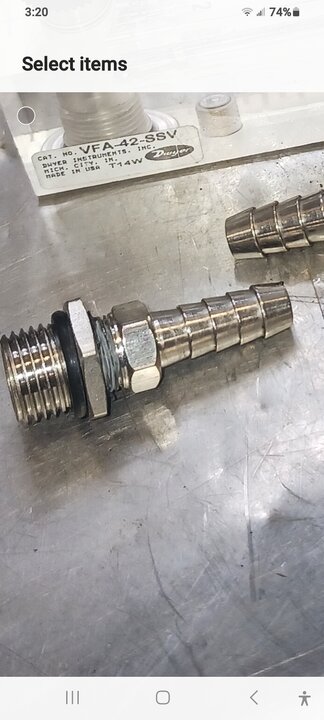

I just got the stainless hardware for the chemical meter. This weekend I'll install it and get it all working. Much appreciated bud!!!

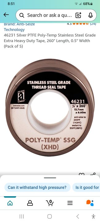

You're welcome. Be careful when installing the parts . The orings are the seal so snug up don't over tighten and crack the acrylic. I pre installed the hose barbs and tighted them using special teflon tape for stainless steel (its infused with nickel ) a must for stainless on stainless
