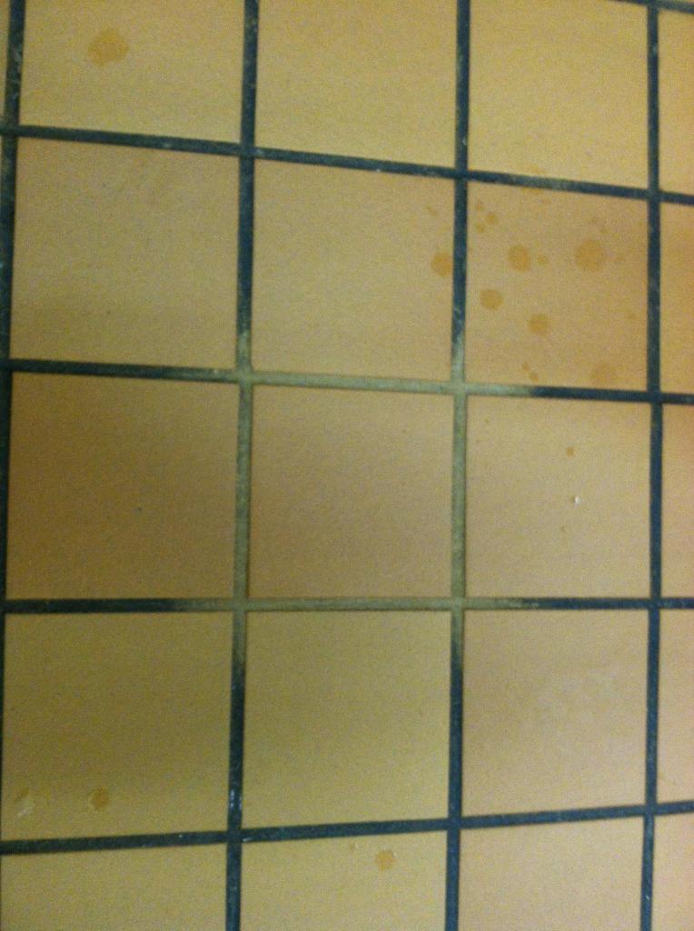

thats because the grout was not dirty in the first place...this was a warranty job where the 95 year old home owner could not keep the TILE clean.

If you're using the little blue wiffle bat to seal grout lines then you should definitely switch to Jim Martin's new tool which will make it even easier and you'll get better coverage and a proper seal with it.
The little wiffle bat really comes out blotchy/ spotty at best we have found

I'd love to see a video on color seal, especially 1inch tile
Here you go -
Worst case, about 200 sq ft/hr around toilets & under partitions. Open area, at least 500 sq ft/hr. Material cost under 10 cents/sq ft. Average selling price (after cleaning) about$1/ sq ft. On a maintenance contract, mop with mild alkaline, spin it at low pressure & temp. Touch up around urinals or high lines in a couple minutes by mixing up a shot glass full of original color from core colors on truck.
