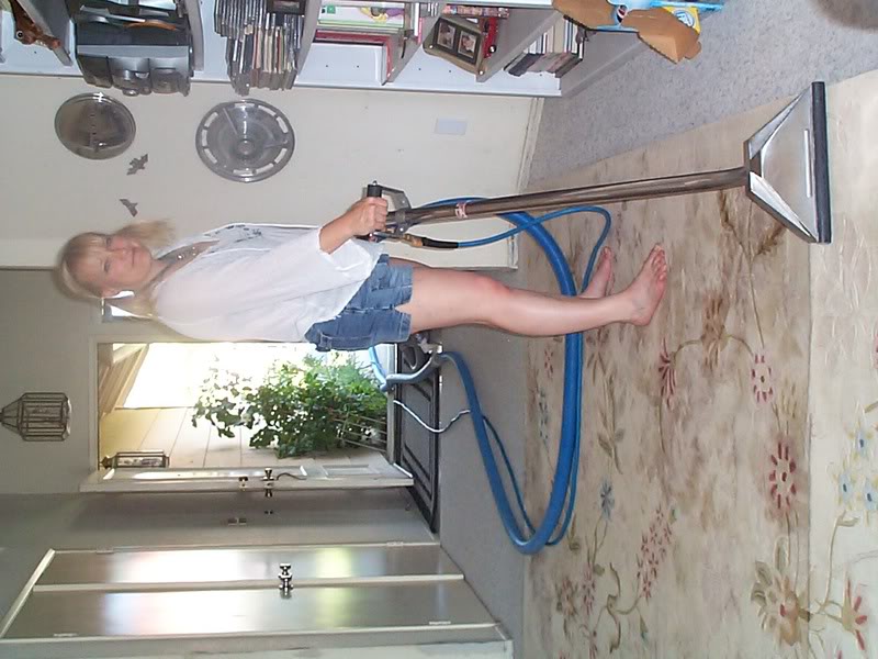

Todd,
You think Teflon glides are overpriced, but you'll pay $900 for a rotomolded plastic wand?? How long until it starts to collapse under the heat and hg's of that Geni? Most plastic upholstery tools last about 6 months with big TM's before they collapse, I'm wondering how long the rotomolding will hold up under regular use.
The Evo glide is Delrin not nylon. I've used Delrin glides extensively, there biggest downfall is snagging and roughening over time. if you run one, it's important to sand it regularly to keep it smooth because it won't burnish over like Teflon does. Here's a pic of me using a Delrin glide:
We've done some tweaks to the Evo wand, those who have them and want to be testers should give us a yell, we have 12" tweaks done and 16" tweaks in progress.
Take care,
Lisa
