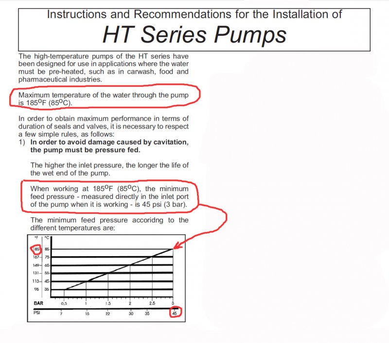

Keith - not wanting to rain on your parade, but just a word of caution. If my info is correct, you're running a General HTS2215S, but the following applies to all pumps. When a pump draws in water it creates a low pressure pulse. If the water pressure feeding the pump is low, or even a partial vacuum (if the pump is drawing uphill for instance, or the inlet piping is too small) the low pressure pulse can cause cavitation, which will shorten the life of the pump, or, in extreme cases destroy it pretty quickly. Here's the biggie though - as the solution temperature increases it cavitates much easier. In order to counteract this as the solution temperature increases you have to pressure-feed the pump inlet. Higher temperature = more inlet pressure needed to avoid cavitation. The pump guys call this NPSH (net positive suction head). All the pump manufacturers tell you this in their literature - I've included the relevant snippet from the General HT-series manual. I believe your Apex draws from a waterbox, right? Not much pressure there except maybe a few inches of head from the waterbox height above the pump.
Not saying your pump will self-destruct instantly if you run it at 165 inlet temp, but you should definitely be prepared for shorter pump life before rebuild/replace. As usual, nothing is free. :(

I am talking 165 TO the pump, the rest happens after..
Yup - the higher the inlet (water to the pump) temperature the more tendency to cavitate.
According to General's table above, to completely avoid cavitation and maximize pump life if you fed it 165° water you would have to pressurize the inlet to about 35 psi.

You guys lost me, the pump is rated at 180 degrees and I'm only giving it 165 degrees with the pump on the base of the frame..
If you read General's text (above) it actually says the pump is rated at 185° if you pressurize the inlet to 45 psi. Fine print indeed!
