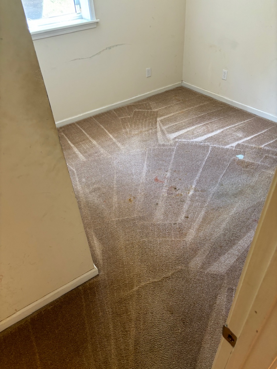

Now you’re calling me a liar which I don’t take lightly. There’s no evidence of a litter box in that room and the dark spot don’t smell like fecal matter
But to make your judgmental ass feel all bubbly inside🖕🏻, I offered to not charge them after I cleaned it because I told them it would come out more presentable than I expected since they’re selling the home
I cleaned a total of 9 areas of carpet and tile in this home and the seller was happy with my cleaning.
So hall-monitor Fred, did I do it better? Should I repent for my wicked evil ways of doing business?

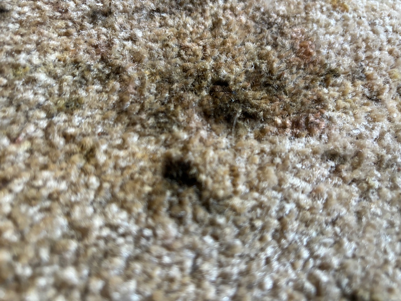

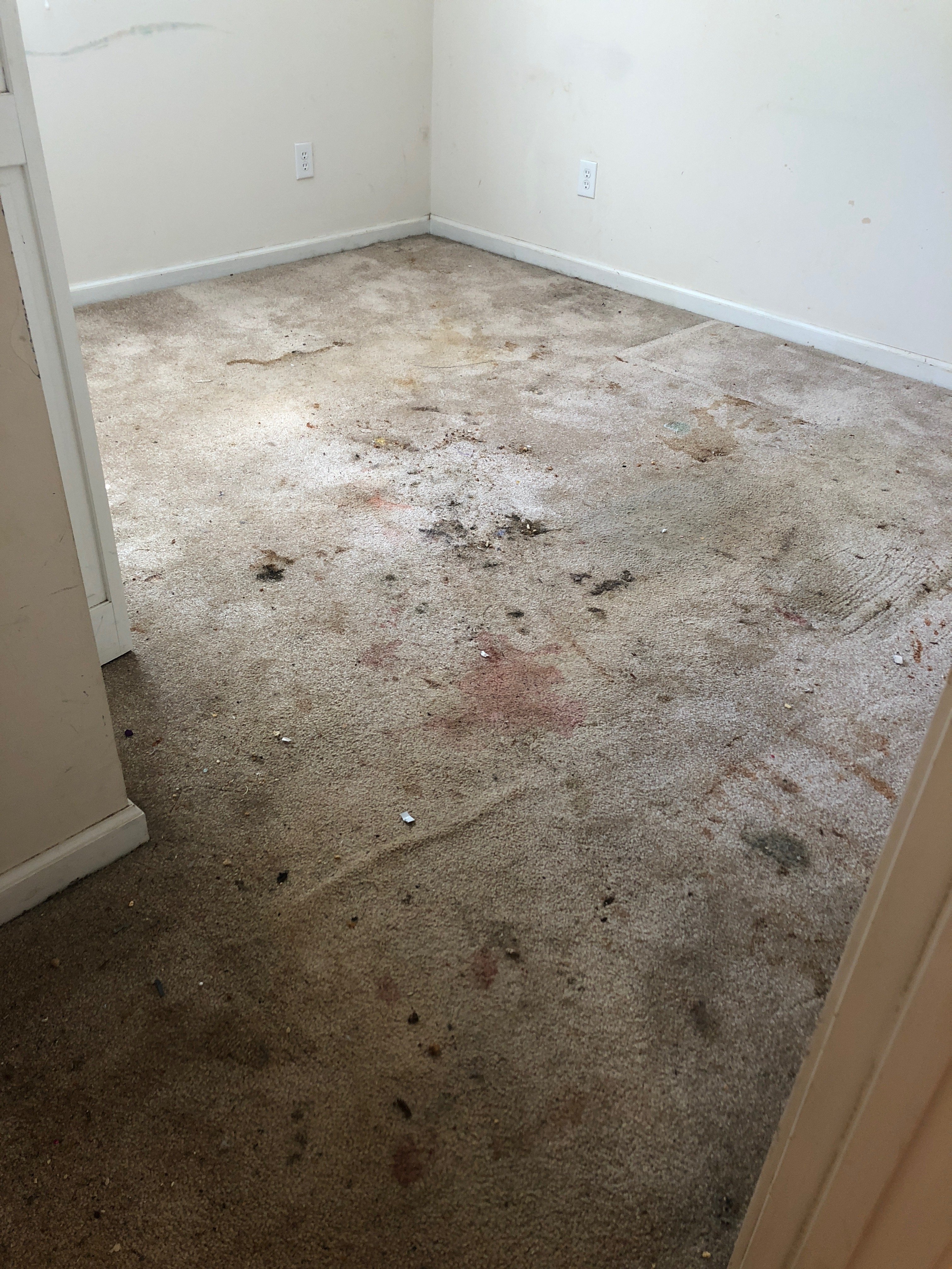

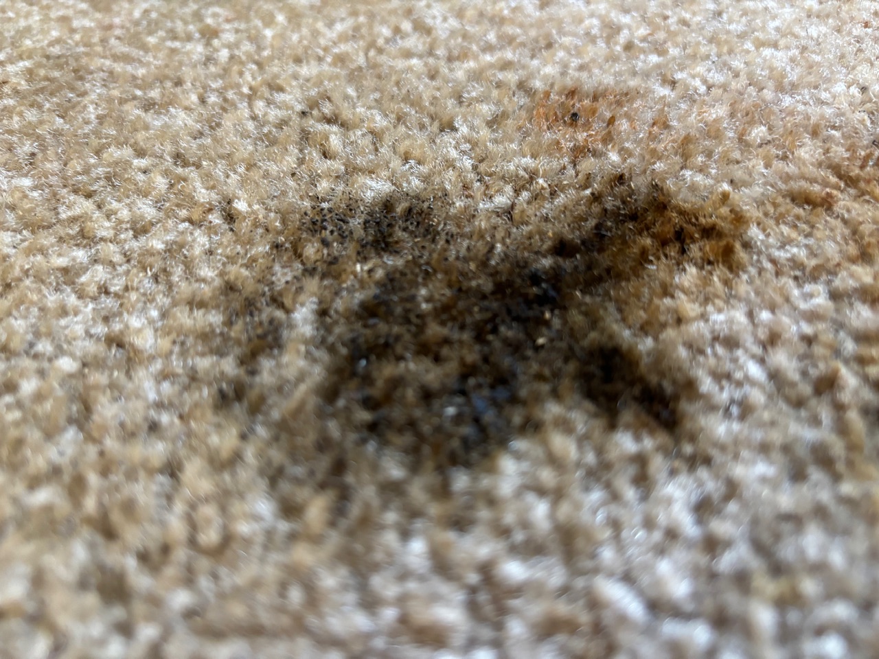

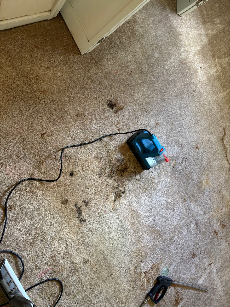

View attachment 127352 View attachment 127353 View attachment 127354 View attachment 127355
Looks good.
Nice work man!!!

Yes I would after I cleaned it the way I did today. And I tell the customers all the time that sometimes I can’t make it look new but I can make it “barefoot status”

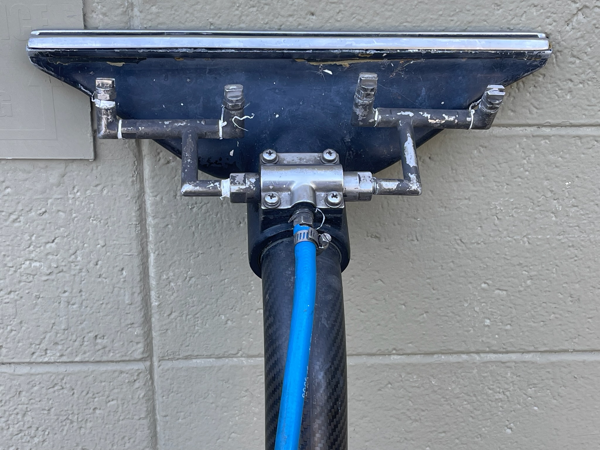

I'll have it on my site as soon as I have the new Glides for it.
29" Westpak S bend.
Flat Face Glide
Rejetted
Extender Benders
InLine strainer
Assist grip choice
$435 delivered.
Nice. Let me know when they are ready, I'll order one. Slowly I'm addressing the most ridiculous part of my operations one thing at a time. I want to relegate my hand tool that I've been cleaning stairs with to spotting asap 🙃
