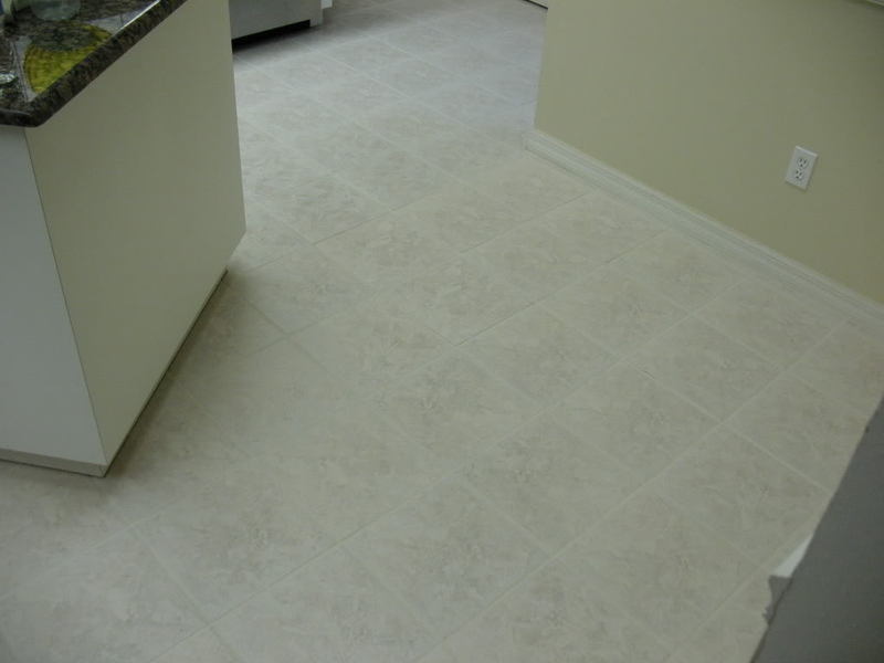

this is why you color seal

Before
after cleaning
after colorseal

Chris Bolin
did you try acid etching when you got the uneven results? i just wonder because I can usually fix that with acid but I did have one floor that ended up like that and acid made it worse.

Look around in the Hard Surface room Jay, loads of info and no it does not come off.

Bryan C
We clean with an acid and citrus boost mix. It degreases and etches. That grout was stained beyond help. Did a demo clean and a demo seal. Highest price but only one who did a demo. Sold!
