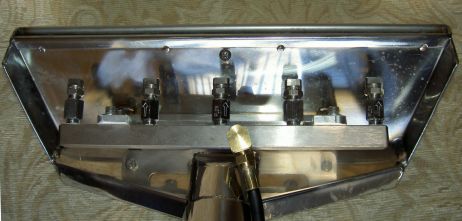

We have both a 14" 4-Jet and a 2" Tube 5-Jet (shown wo GG):
You can have it your way !
Both of them have more uniform angle-jet spacing than the Titanium.
Larry
