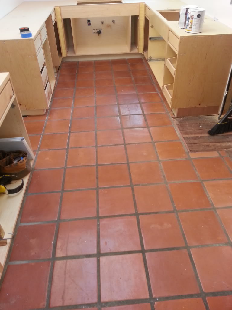

just these 70 or so feet took 2 hours to strip.
I'll go back tomorrow to apply 4 coats of wax/ finish
pretty much have to charge $10 a foot to make carpet money stripping Saltillo tiles.
20 plus year old floor, never dealt with..

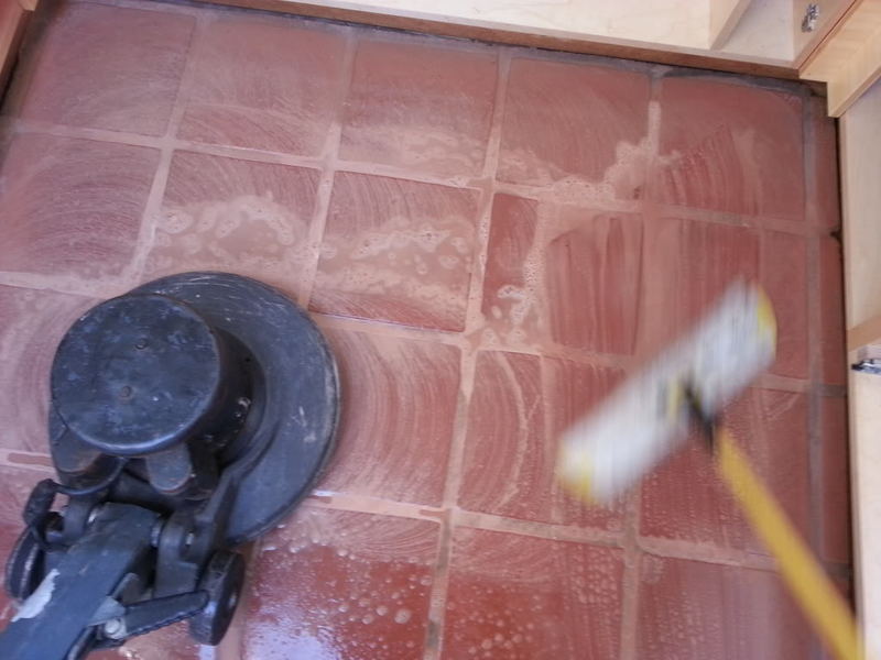

soaking in Zep stripper
Went over and over and over with a Malgrit brush and a black pad..

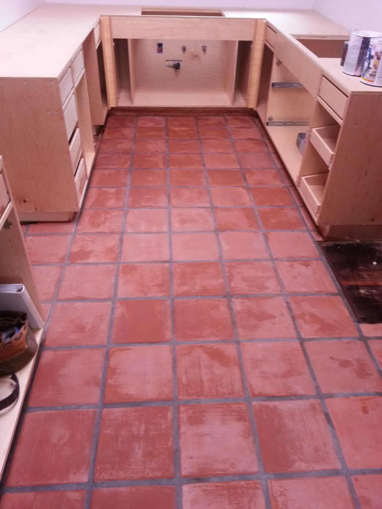

fully naked and drying..

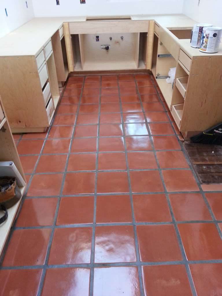

dry and ready for some wax..
one coat pre-sealer, 3 coats "finish"
116,966
more what?
she paid us $650 (75 sf) and that was $300 more than her budget called for.

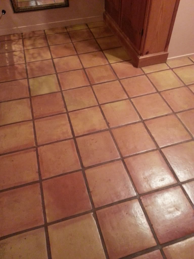

I like the flat look also. Too shiny and you are blinded at certain times of the day.
116,966
No idea Kip I moved on in these floors ten years ago and have only cleaned them.
116,966
Its a house brand product called Brilliant Shine. Its the janitorial shops highest solids product
