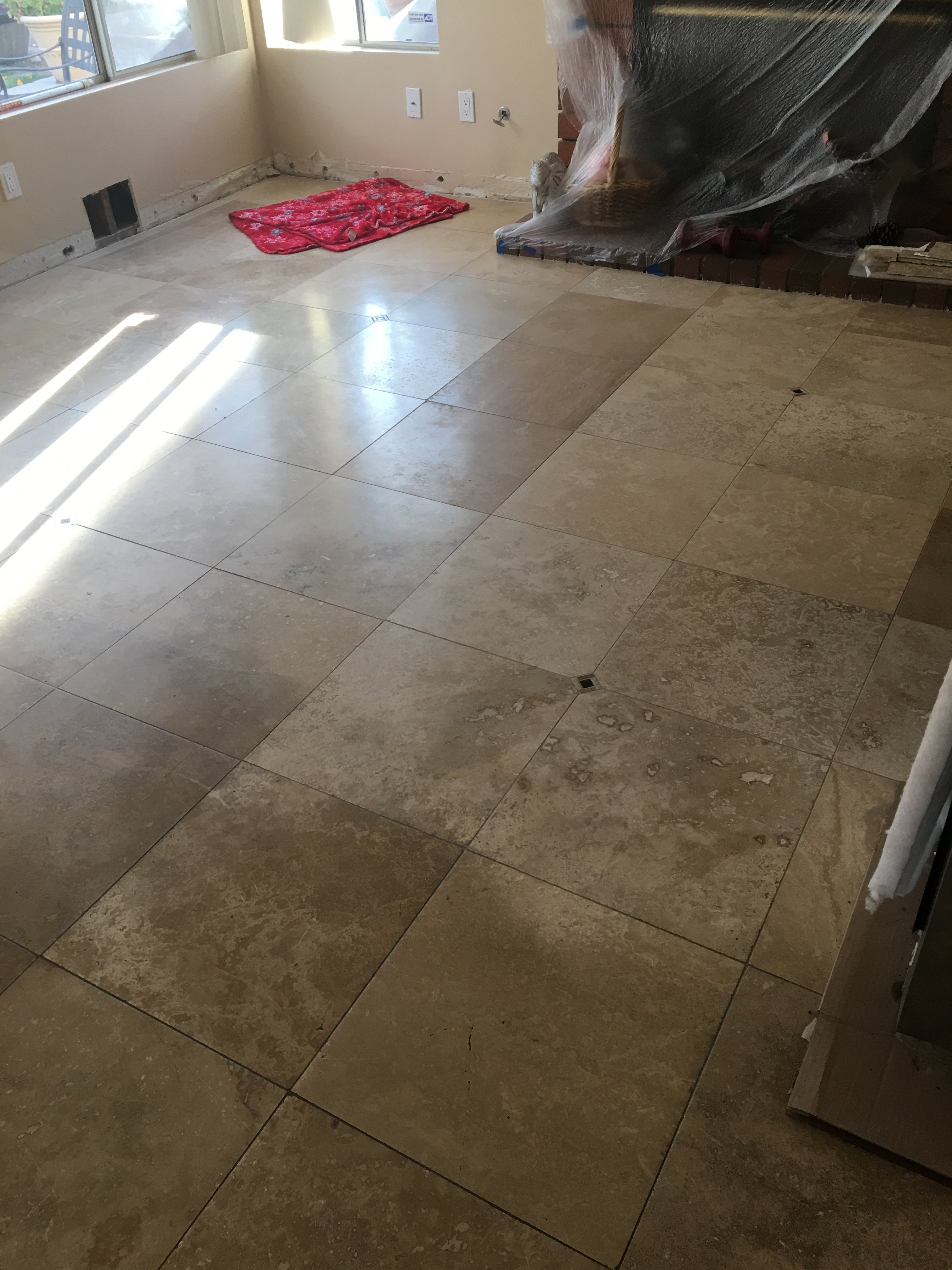

Lady calls and had a flood, everything is dry.
She got a contractor to come in a quote her for new floors, but she wants to try and save money.

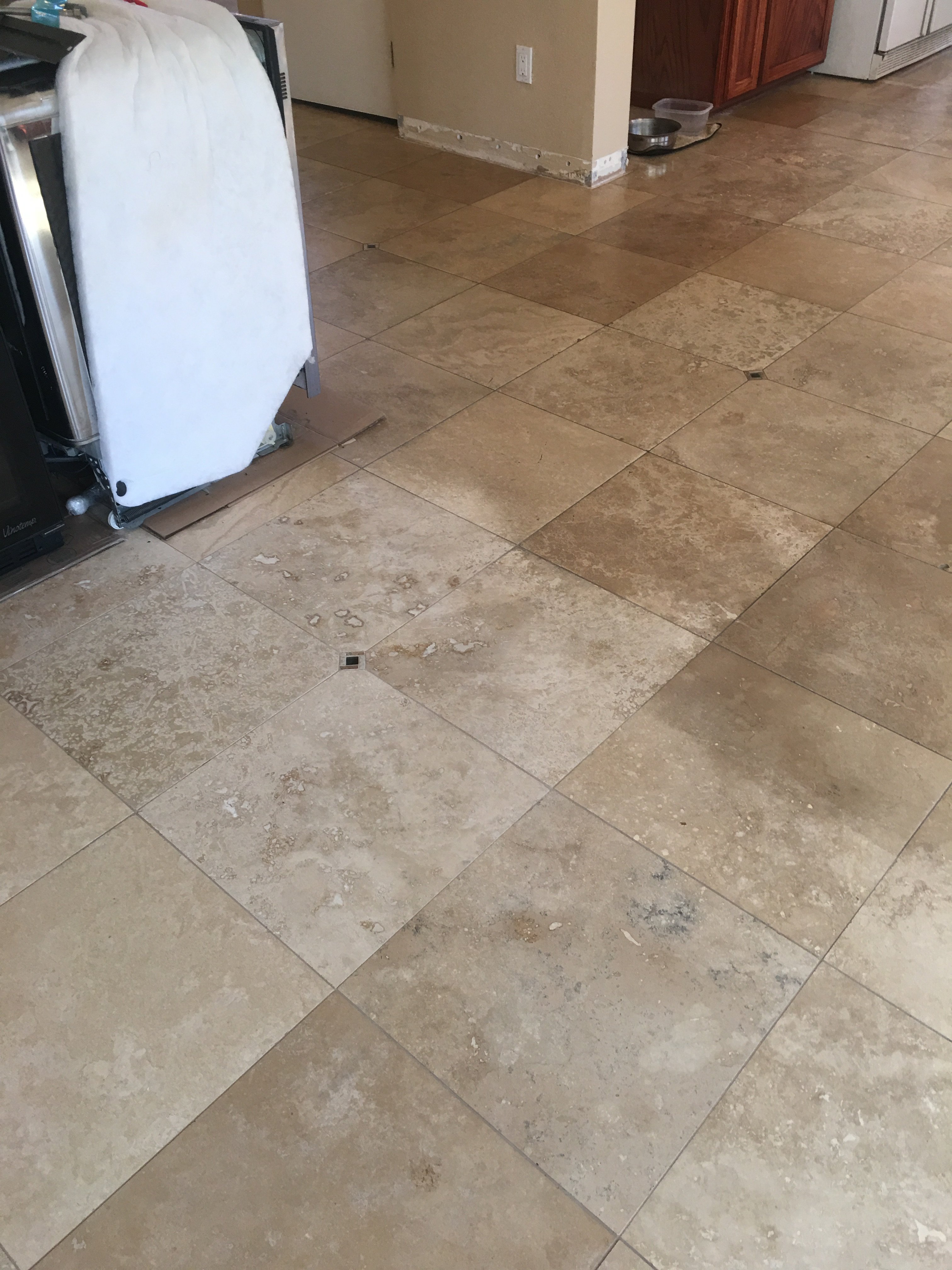

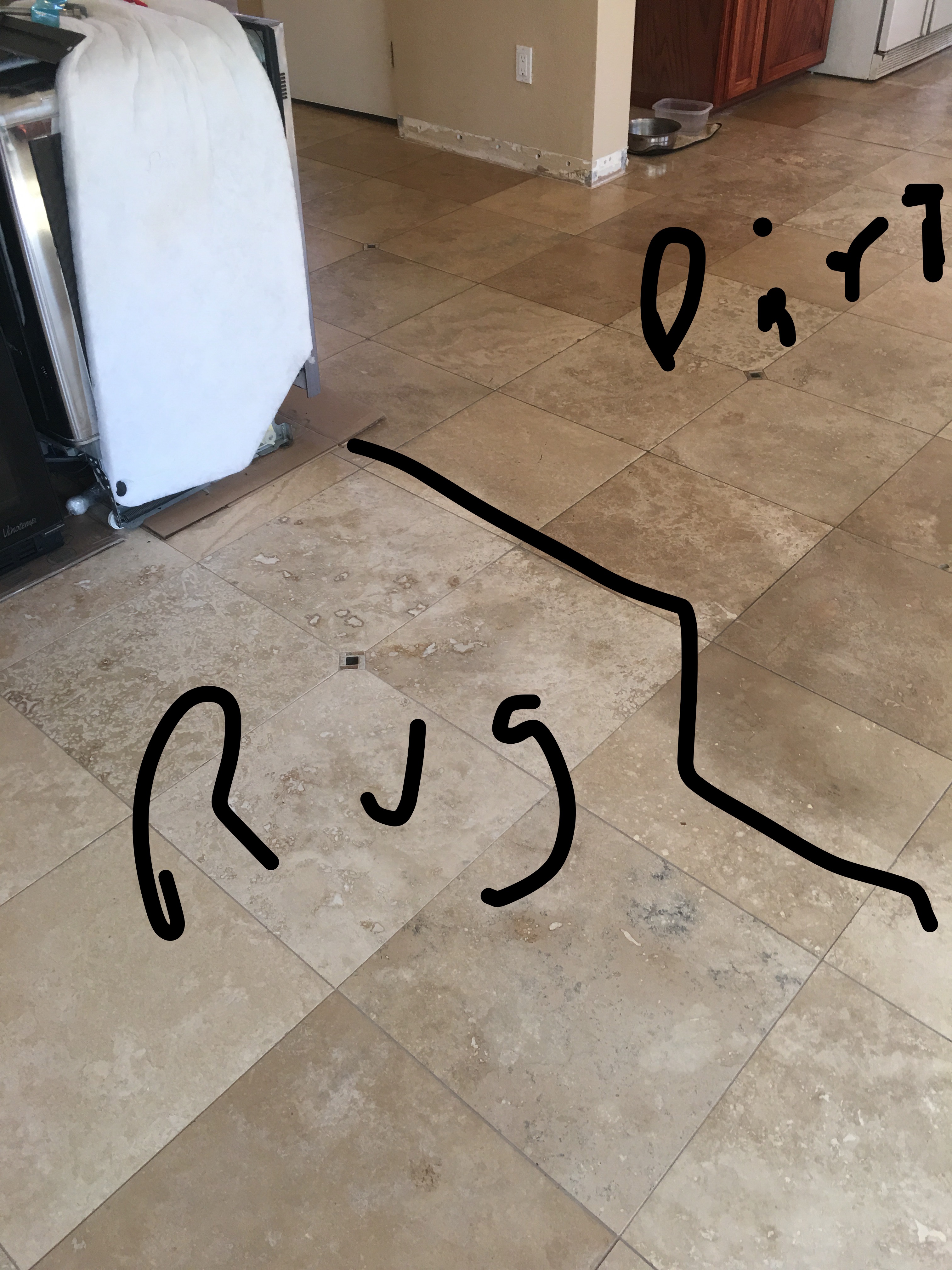

The lighter darker area is where a rug was
There also a topical on the flooring to.

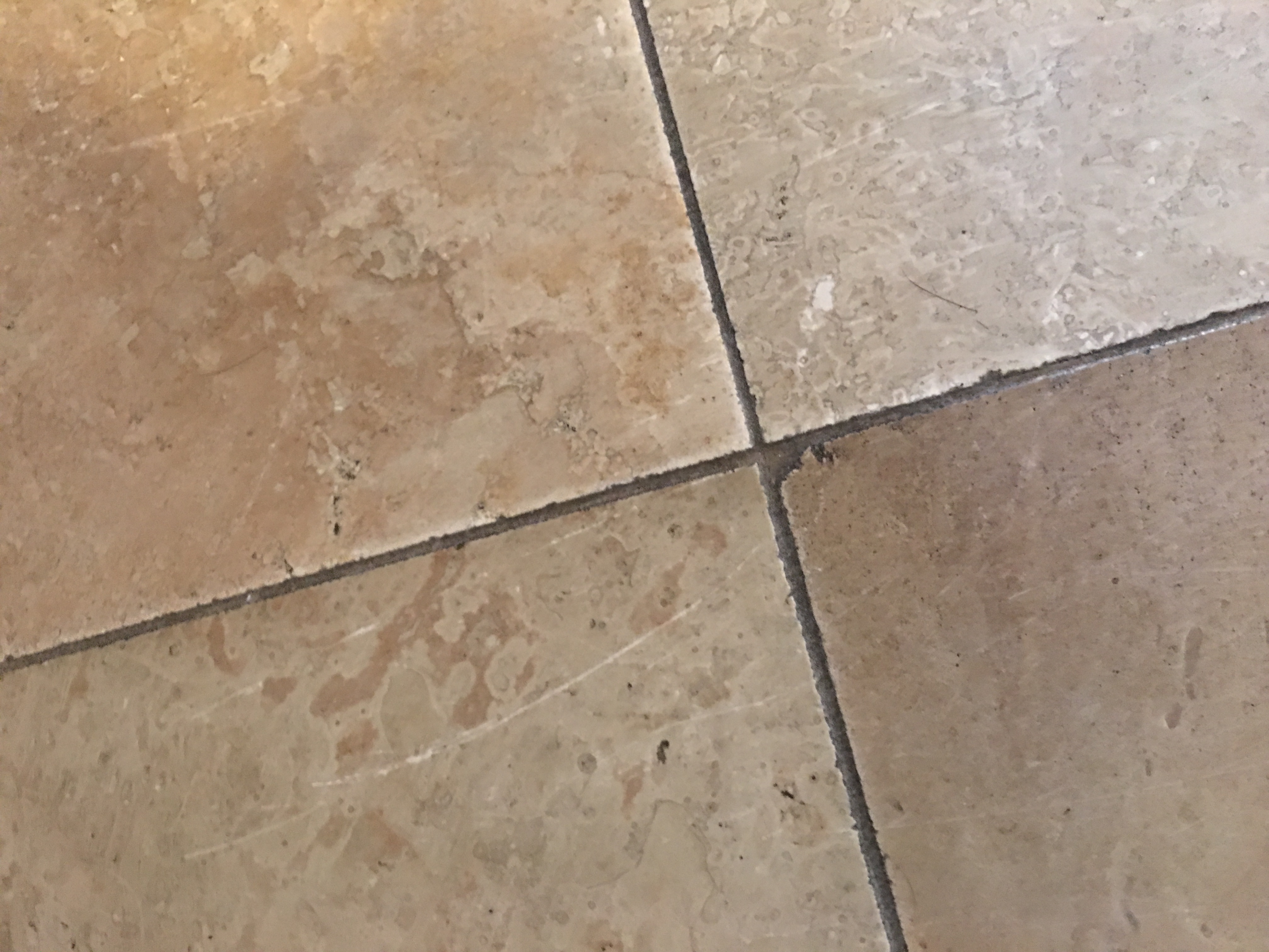

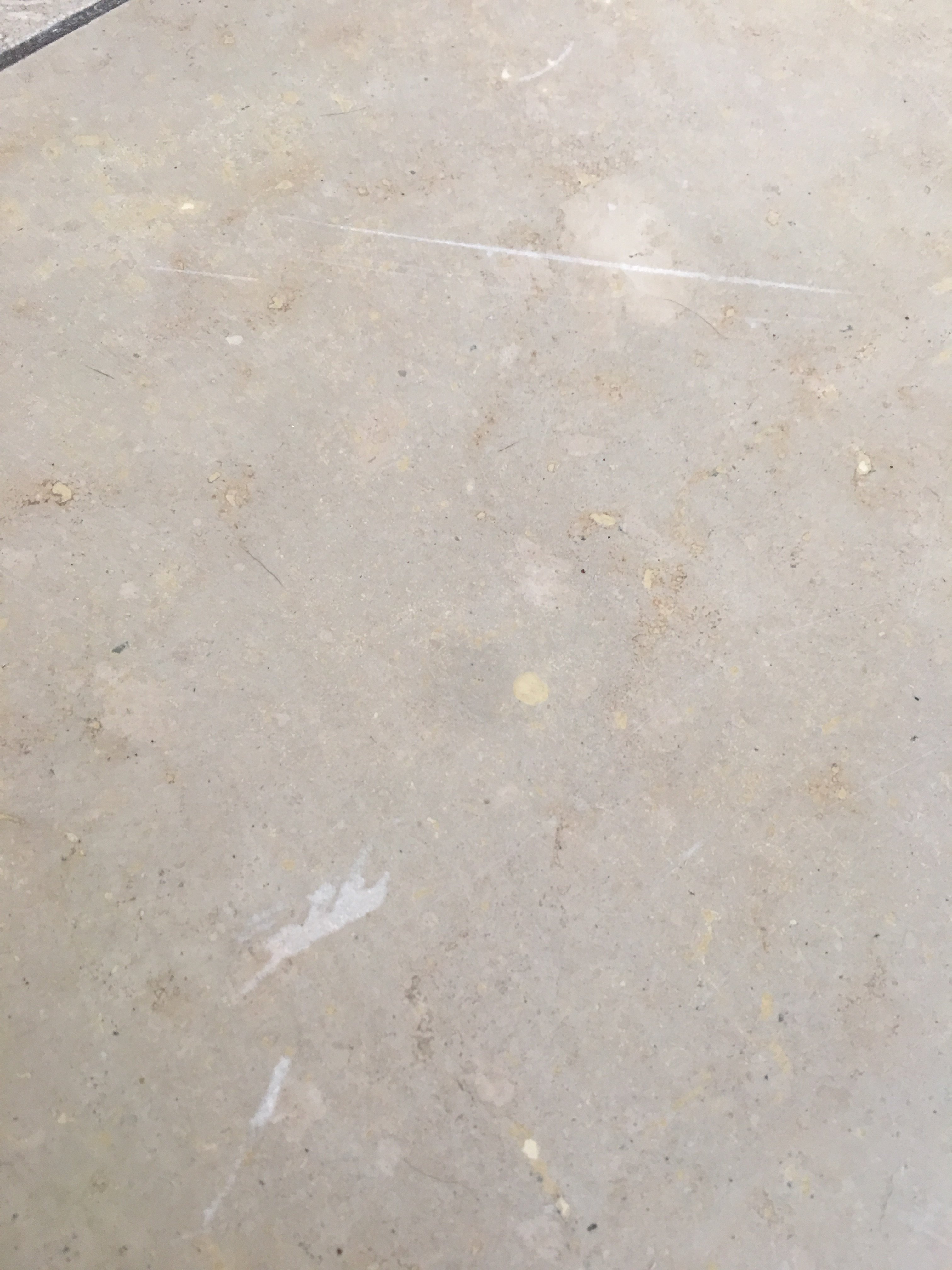

This last picture is where a scratched with
My finger nail and topical peaked off.

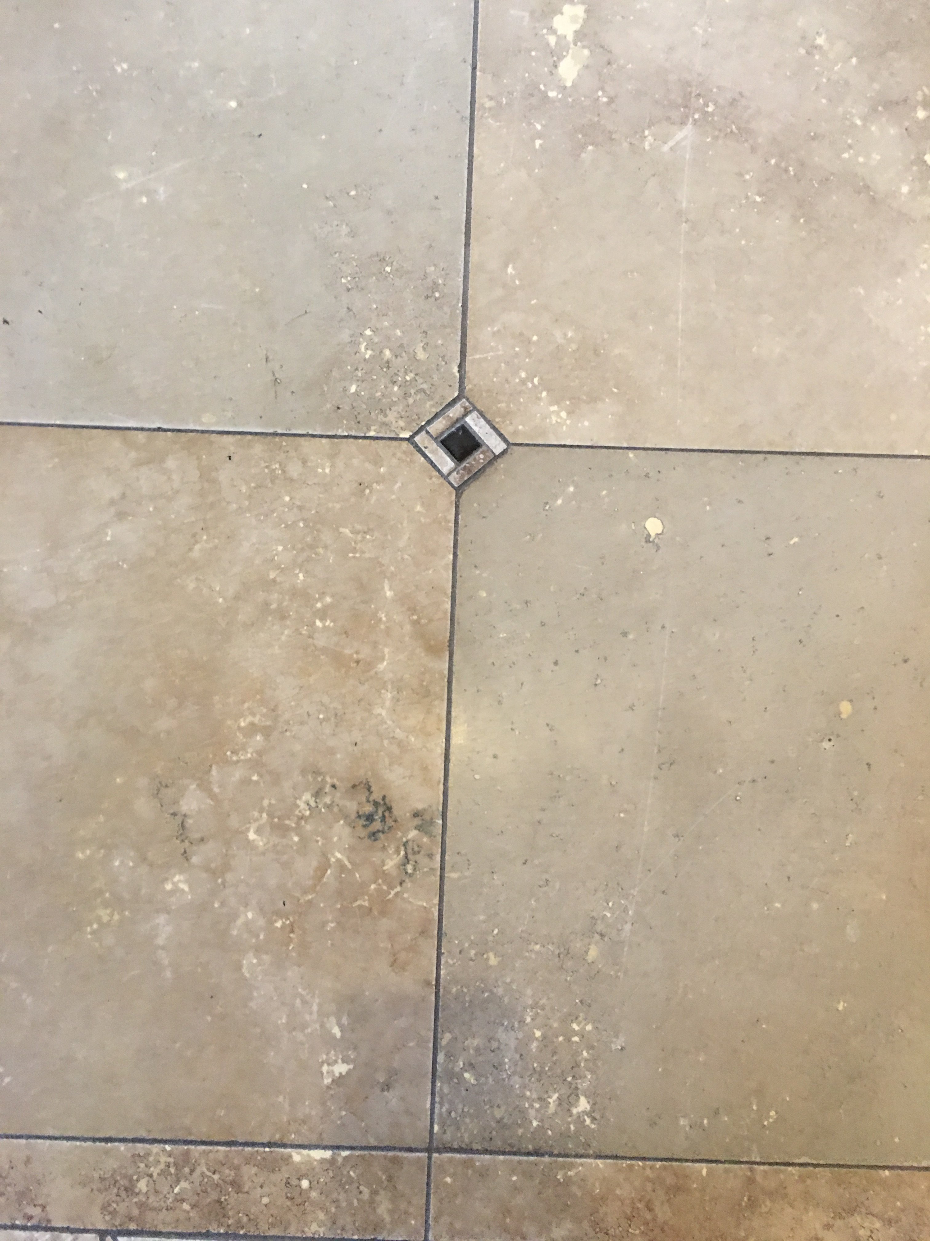

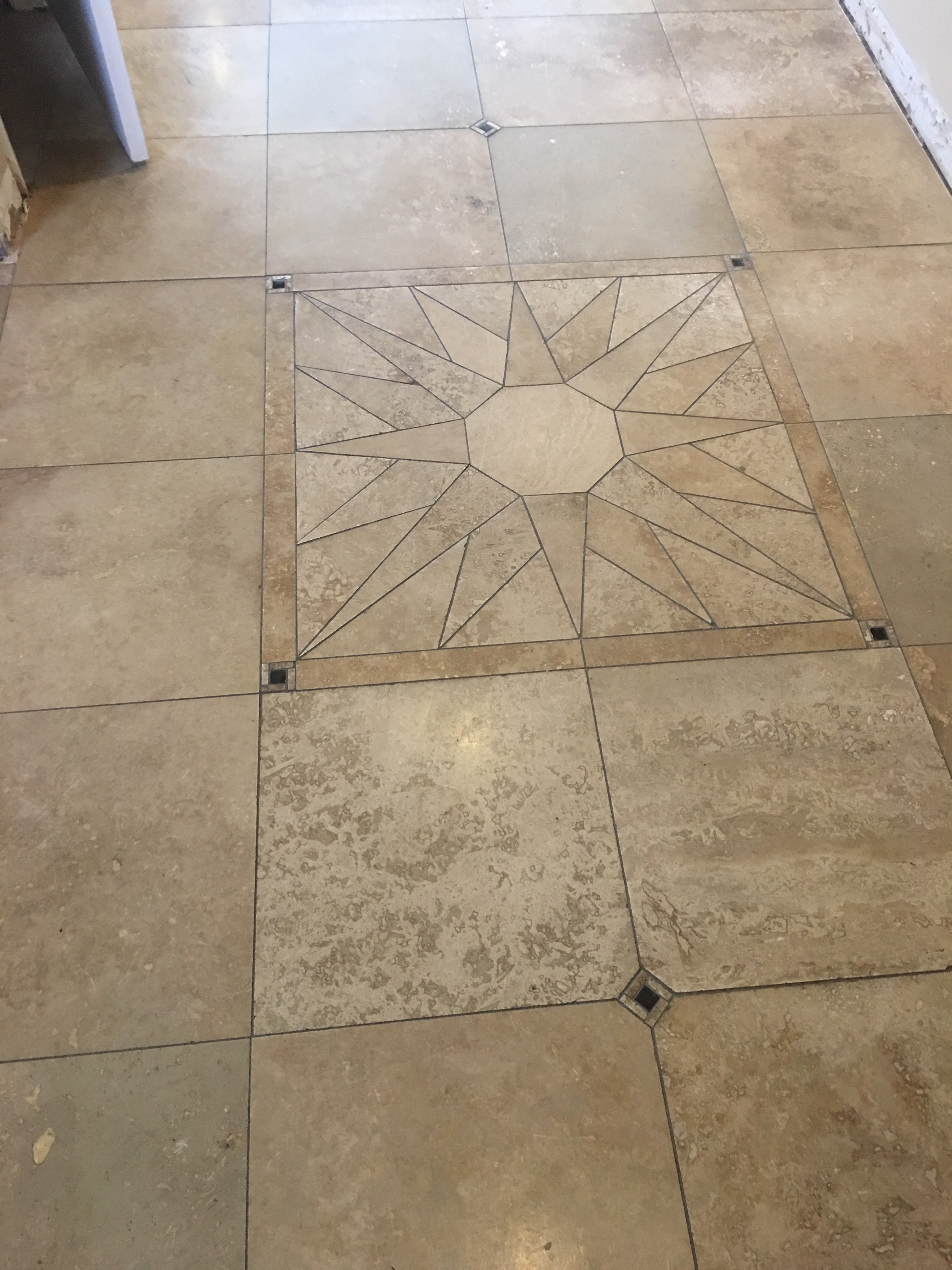

These little inlays are not level with the way of the Floor

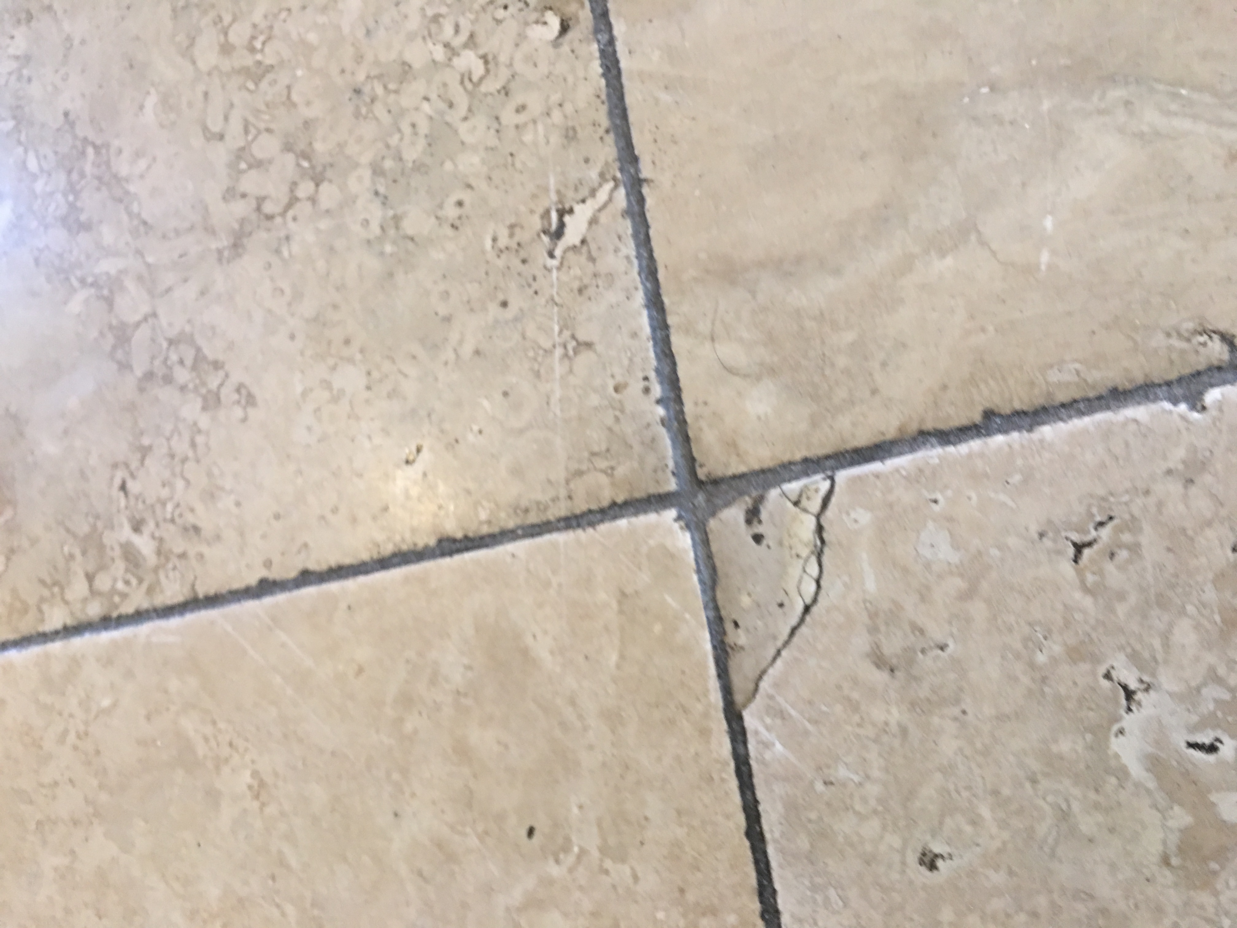

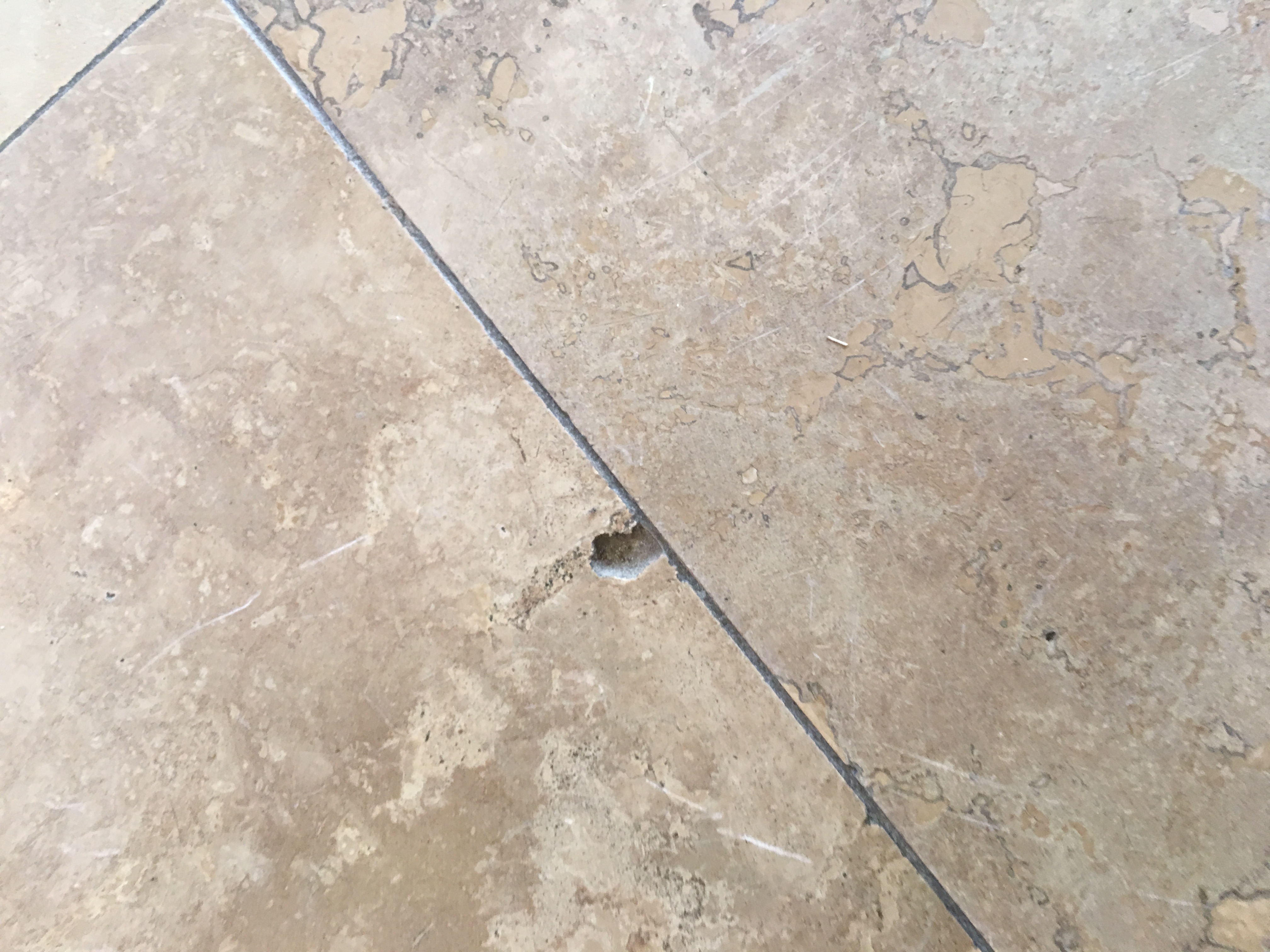

The floor needs repairs and repairs and has scratches that are deeper then the topical.
I believe she wants it clean and honed and polished about 600 sq ft. It would need traverfill in some areas.
Not sure about all the chips and cracks.

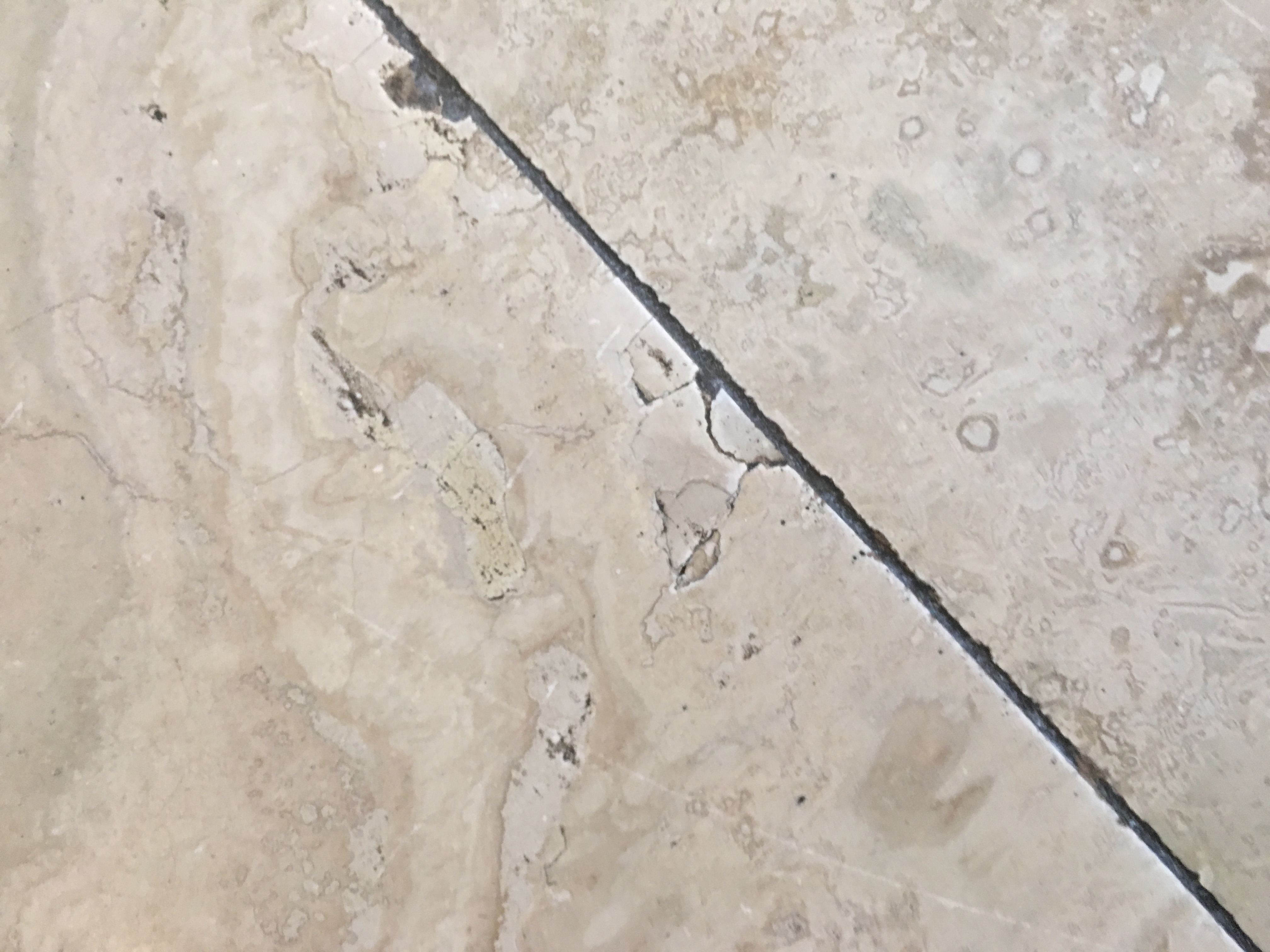

The whitish area are peel one of those I scratched with my thumb and it peeled off.

I'd love to have this job. Seariously. Lots of money to be made there. If it's peeling off with your fingernail...some heavy alkaline solution and a turbo and brushring might be enough to get it off. You might have to do it twice. Then see what the stone looks like under there. Then hone and polish. Ypu'll be doing even better if you can figure out how much they quoted for replacement.

The 220 is not a stripping pad, doing so would ruin it, loading it up with dry polymer. The inlays are going to ruin DIP pads too I'm betting unless gone around and done by hand. No thanks.
I would just chemically "hone" it by using a strong 02 based cleaner

You're want a lot more Tha $100 to fill all those hole and damage too.

Standard job. Strip- turbo(for the grout), resin hone, finish as customer goals
Not a fan of DIPs for cutting . It encourages and enhances orange peel and dishes soft spots, especially on lower cuts. And any shine derived from DIP only lacks durability of a resin cut. It is a choice however
