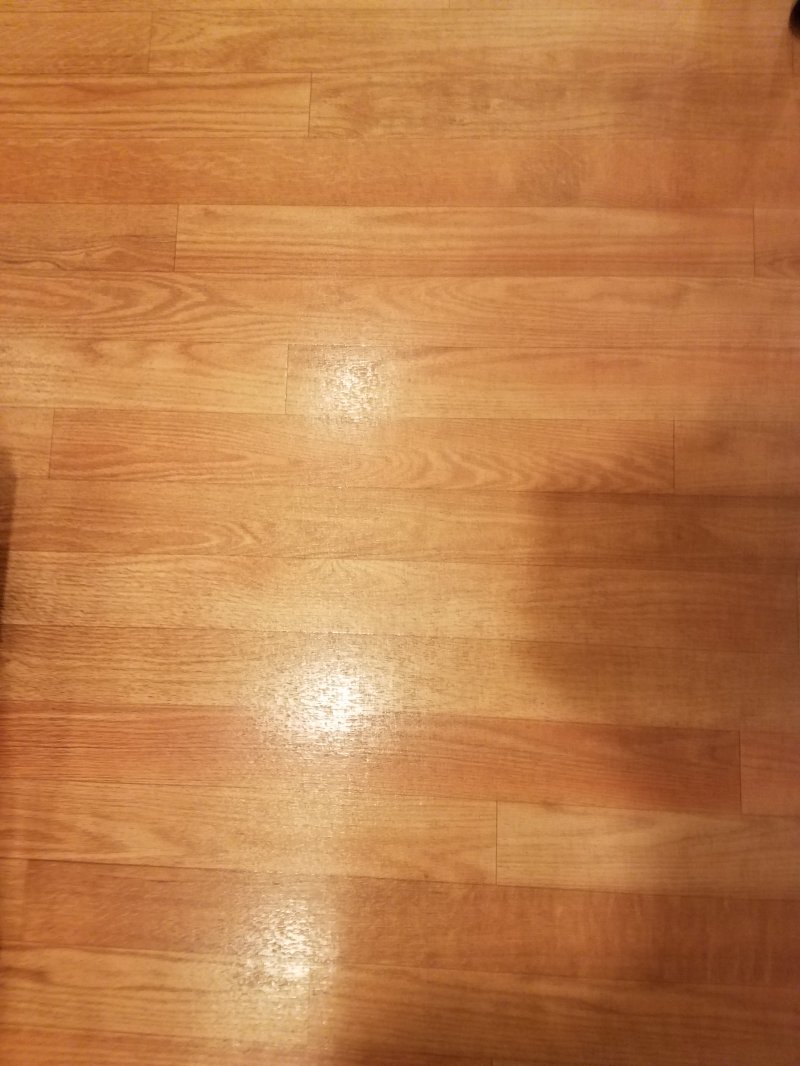

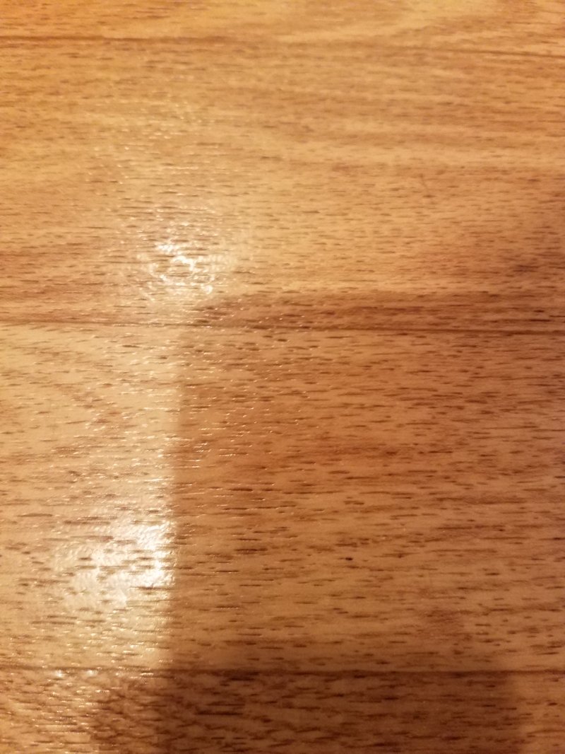

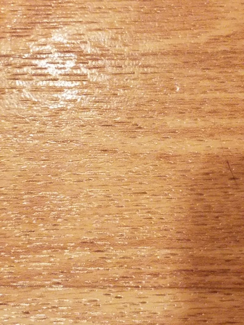

I cleaned some vinyl today that didn't clean as well as I wanted it to. I first spun a cotton bonnet with my 175 using Odoban to disinfect. Then rinsed with Hydrofoce Wood Fresh neutral cleaner using my Lindhaus. The floor had tiny pores that didn't want to release to grease in spots. Anyone have any suggestions as far as Chemical, Equipment and procedure?

If your talking about wood look vinyl plank you'll need either a stiff CRB or a tile and grout brush for your OP or 175.
Depending on what they cleaned (and cooked) with you can have some real sticky oil deposits in the "grain". A citrus booster is usually needed too
Scrubadubba then use your glided wand or hard surface wand or even a spinner to blast it loose
Make sure it's not a laminate or you'll be buying that floor.
14,087
I don't understand why you're being so gentle on that vinyl floor. Like Mikey said, flush it out with your tm at a decent water pressure of about 700psi of 150-170f water

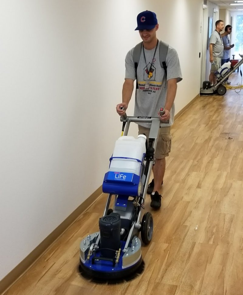

This cordless Orbot did wonders at MF..

Looks like a longer battery life than the other one out there. I think the other has a 2 hour battery life. The Orbot has a three. Pretty cool. My toy list is filling up again.
