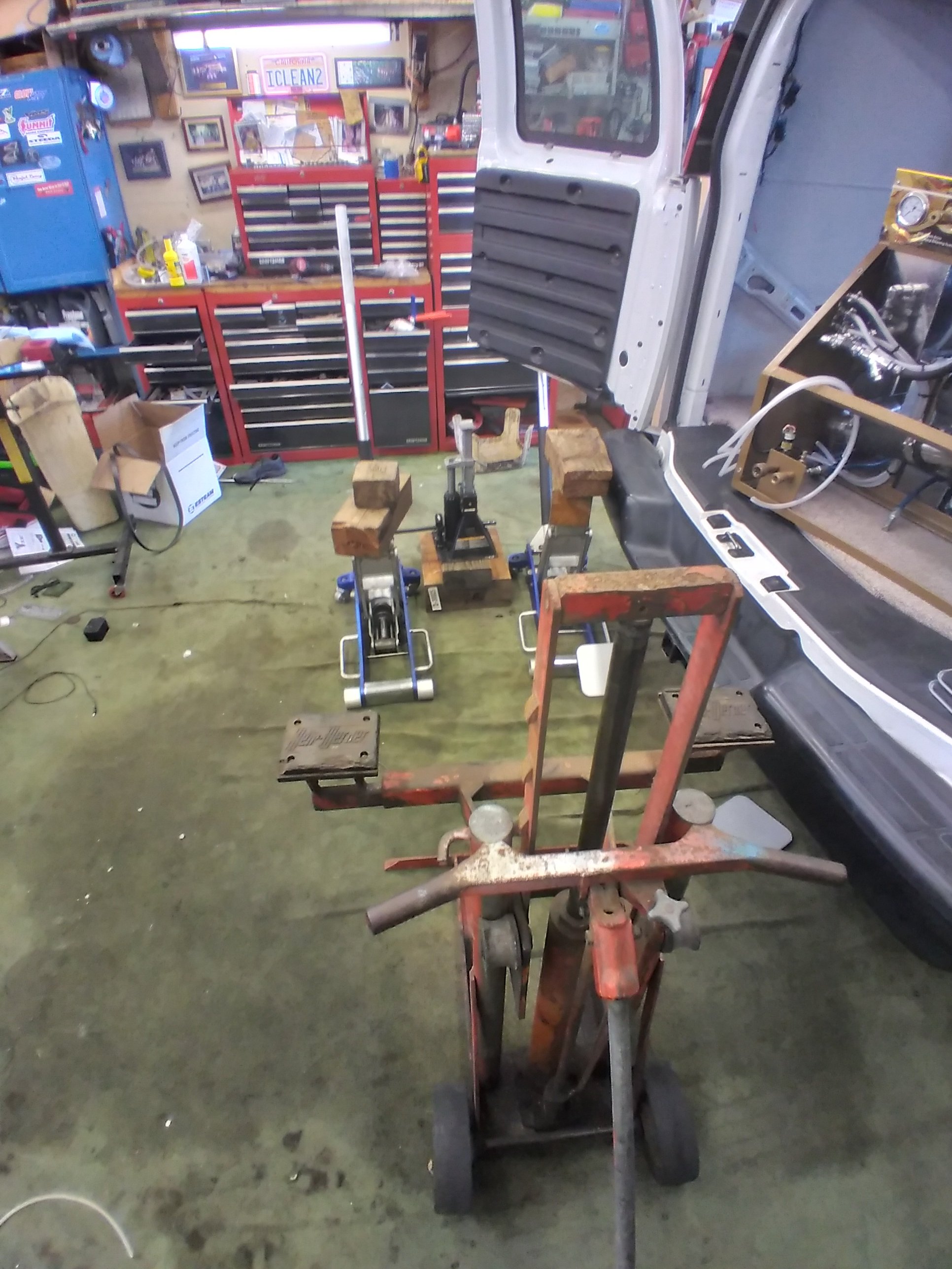

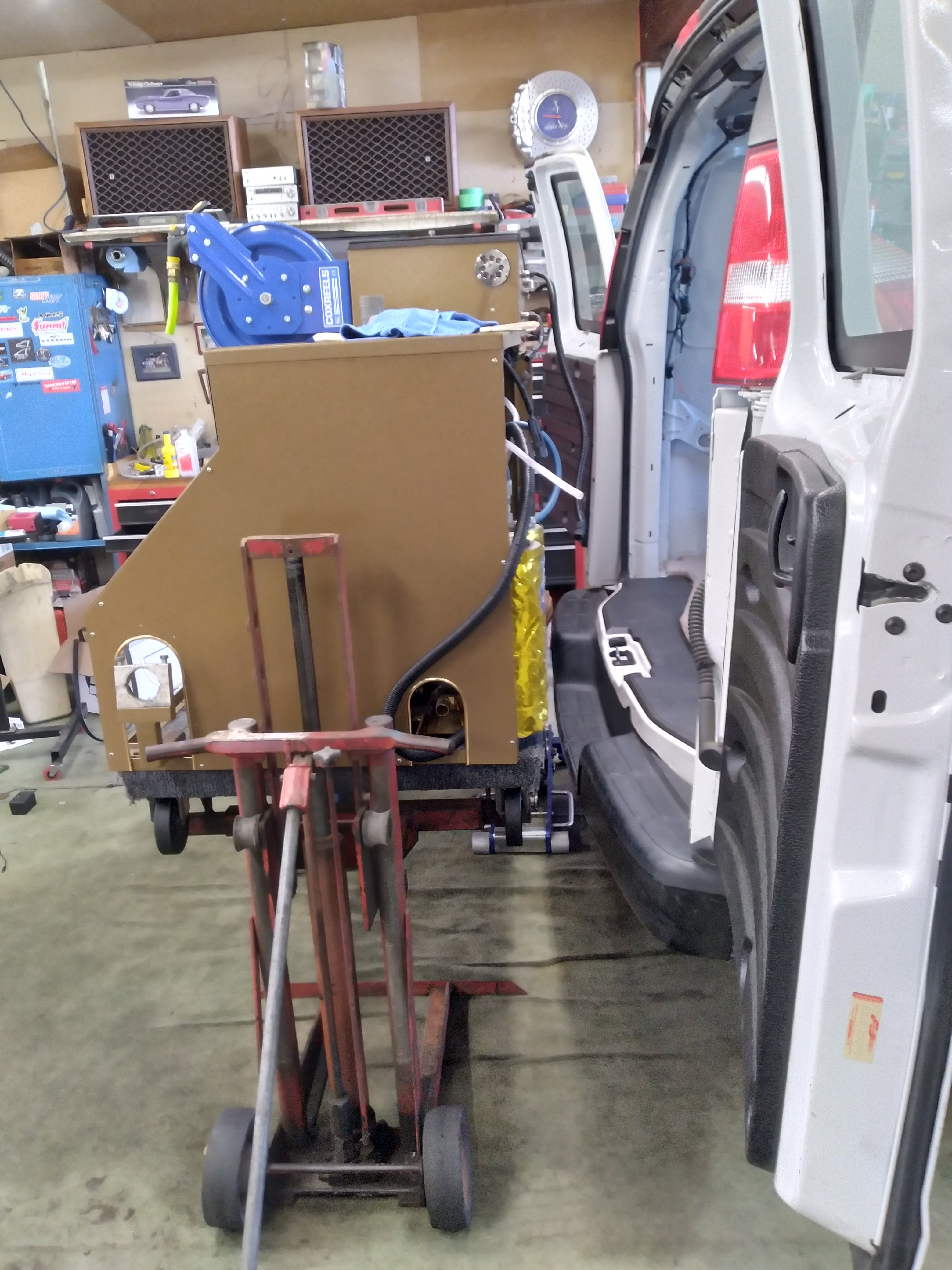

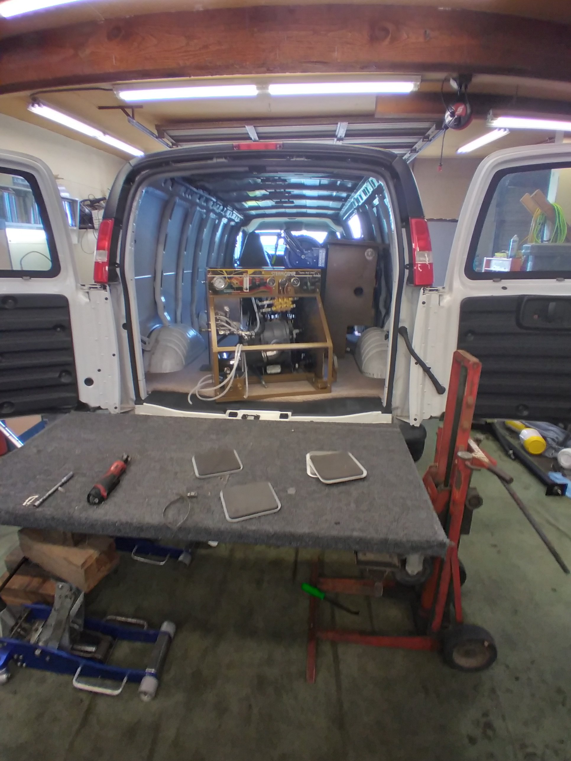

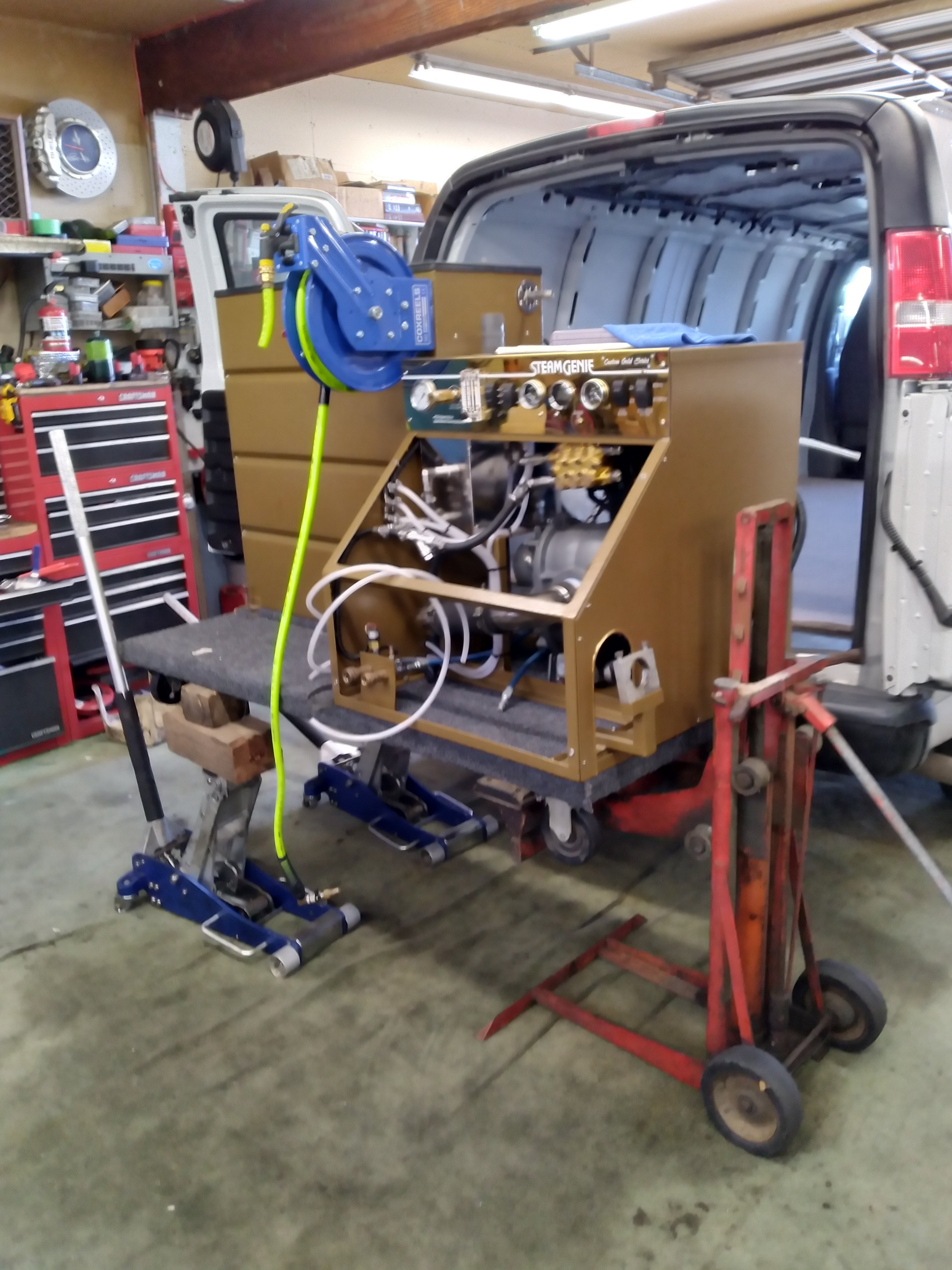

Lift it onto a stack of heavy duty blue skids with a sheet of plywood on top. Move the truckmount on skids with a pallet jack to the van. Slide the mount into the van with small diameter metal pipes acting as roller bearings. Think everything through before you act and it’ll work great.
