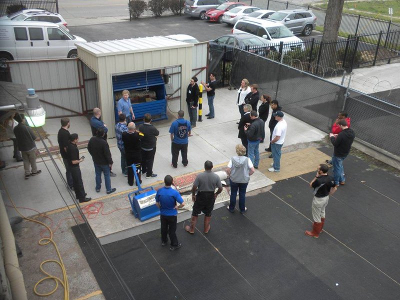

Robert Mann had an excellent set-up for his tumblers. I'm surprised u didn't take photos of it when we were there.. I'll try to find those photos--but they might be on my laptop that crashed.

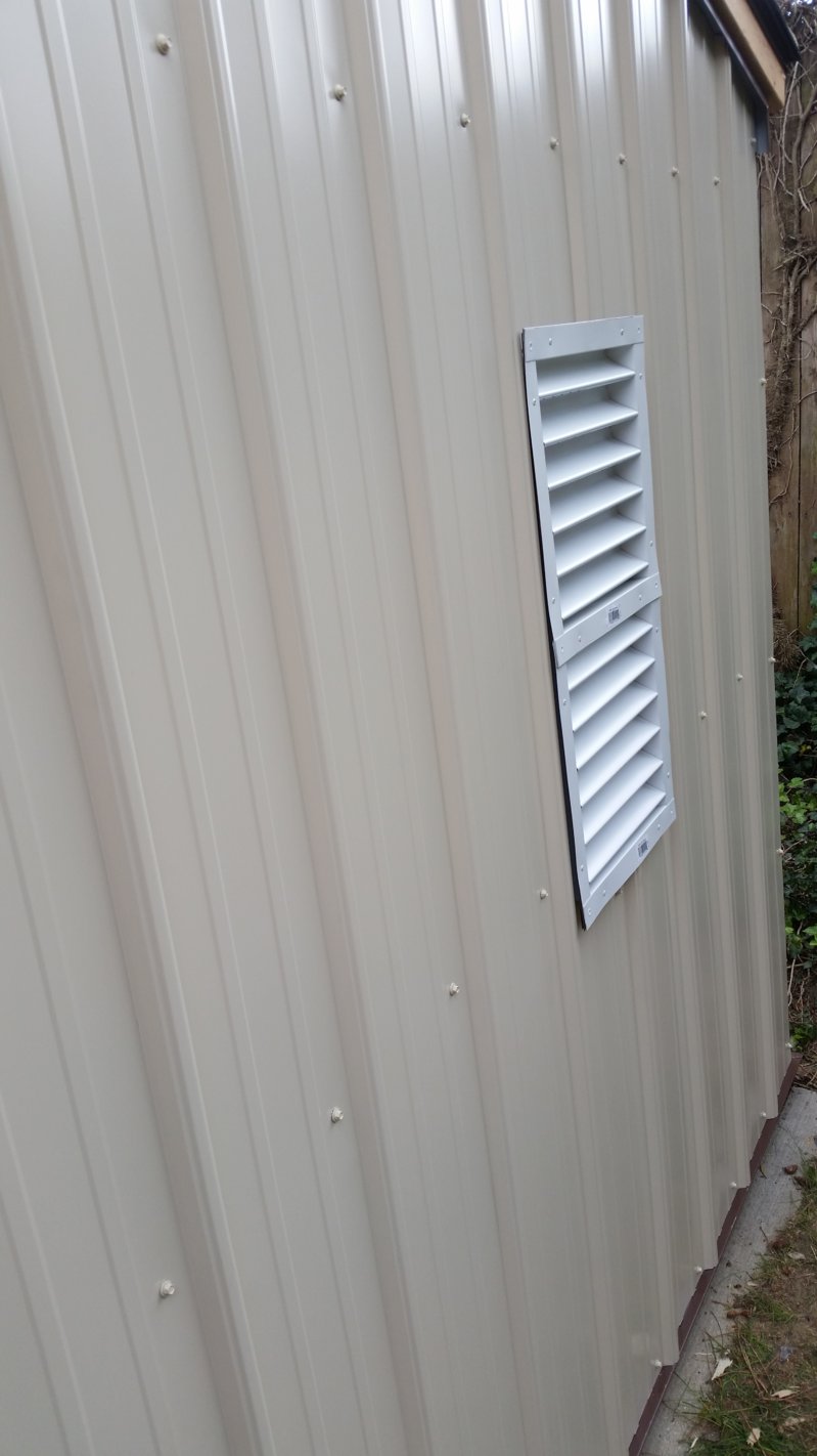

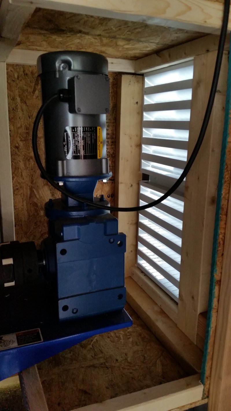

Protect the intake air coming into the motor fan from the dust. I built a box around it and vented the side of the shed. Others have installed ductwork on the top of the motor to a fresh air make up outside the room. In the end, also do what Bryan suggested as well. Here is an example using my set up: 20150825_130500.jpg 20150825_130509.jpg

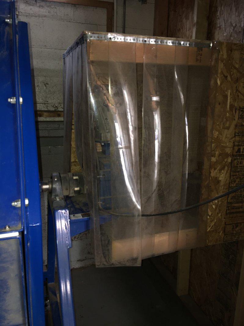

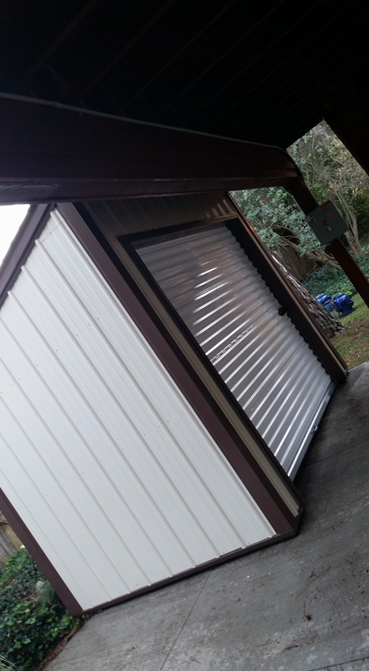

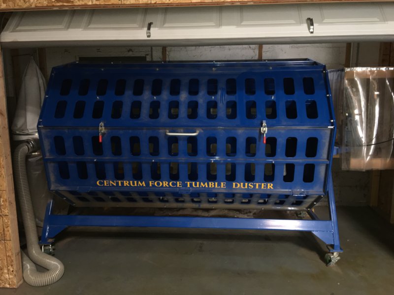

Our tumbler is on wheels and we enclosed the motor with plastic strips so
we could roll it out and clean the floor.
The dust vac is nice so the roll up door can be immediately opened after tumbling but not a necessity.
Not much to know.

Sorry Now I see the vac. Any advantages to having it in with the Tumbler, never seen that set up.

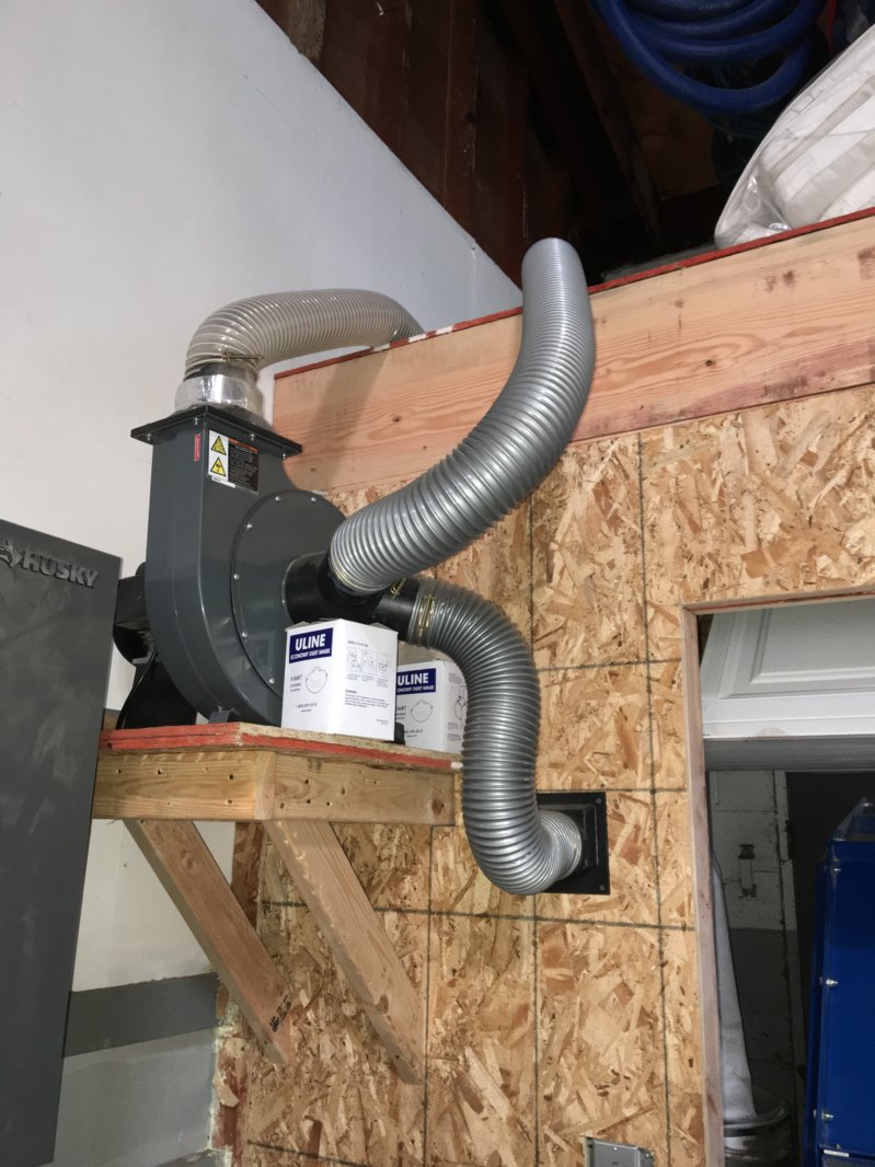

This is at Robert Mann's. You can see that the motor is outside the room as is the dust collection device

Our dust mover was inside the box for 30 years. Basically a furnace squirrel cage fan that fed an external catch bag. We only changed because the catch bag system was old, unwieldy and needed repair, and woodshop vacs are such an easy to live with replacement.
