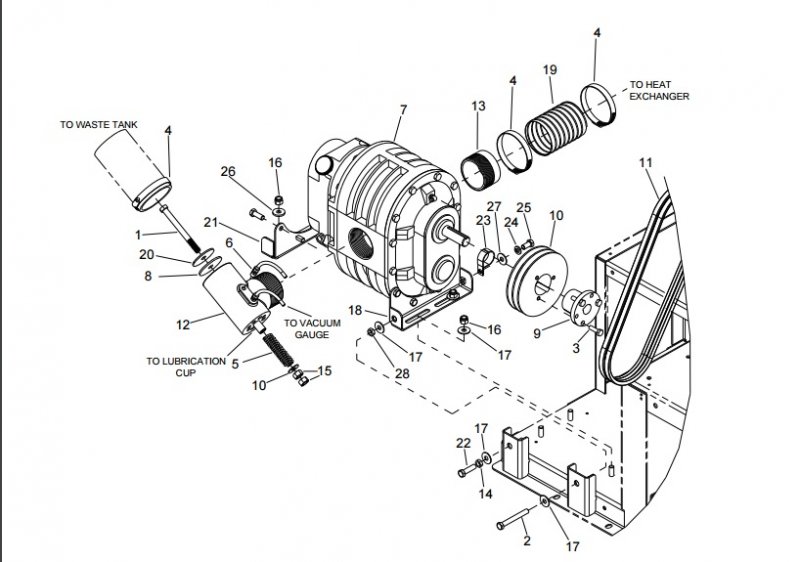

Example: On this prochem legend you can see the relief is directly on the inlet side of the blower....the blower is protected from clogs anywhere else in the system
Many, if not most, are not done this way but it is still the most correct way to do it as it provides the most protection to the blower

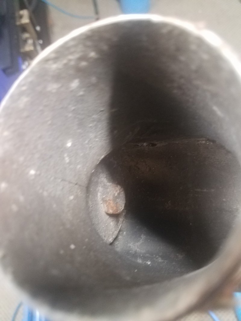

Actually it would be close to impossible on a prochem.. Just a bolt and a washer.. Unless you think the head of that big ass bolt is going to snap off at 15hg..
