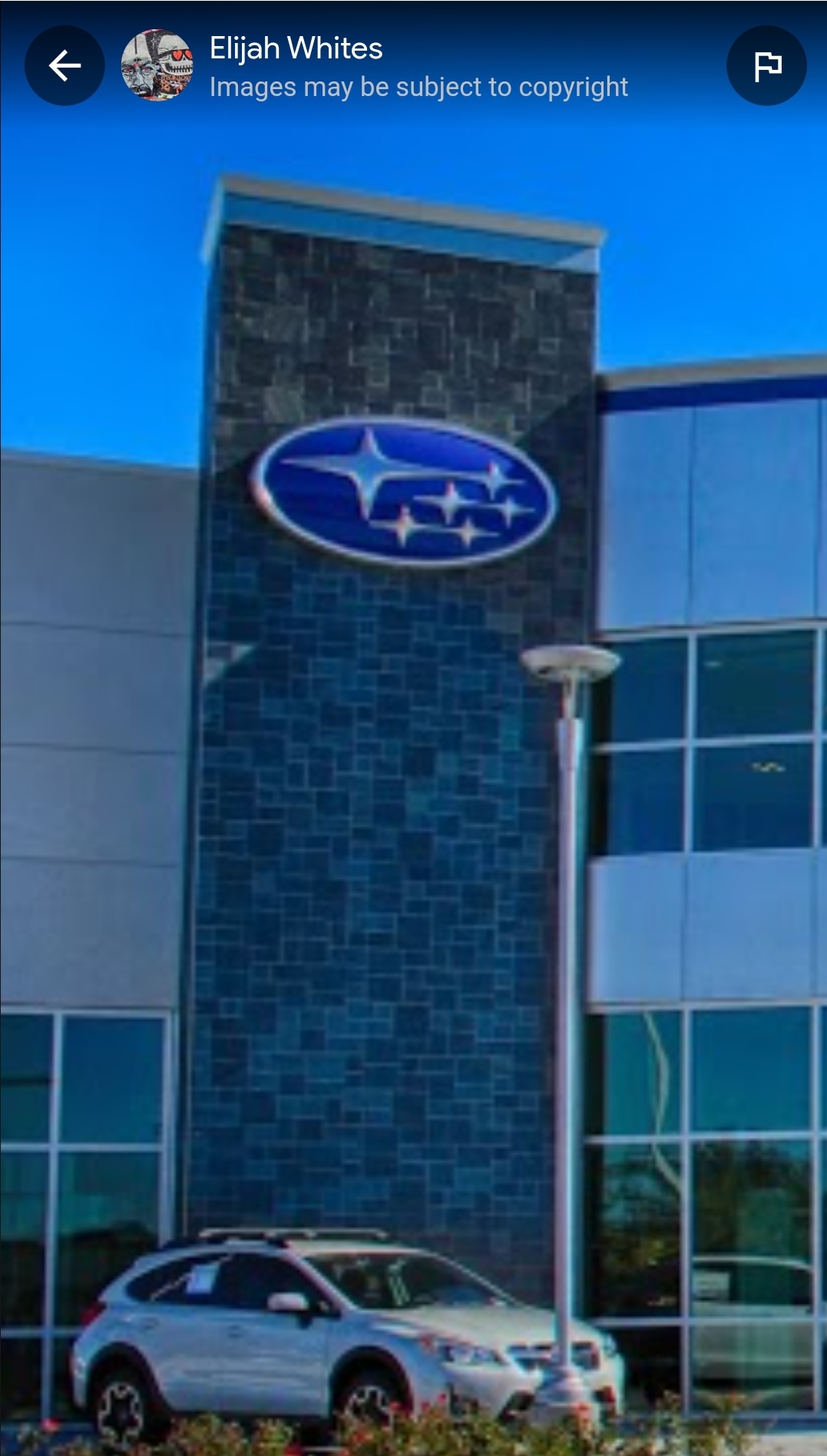

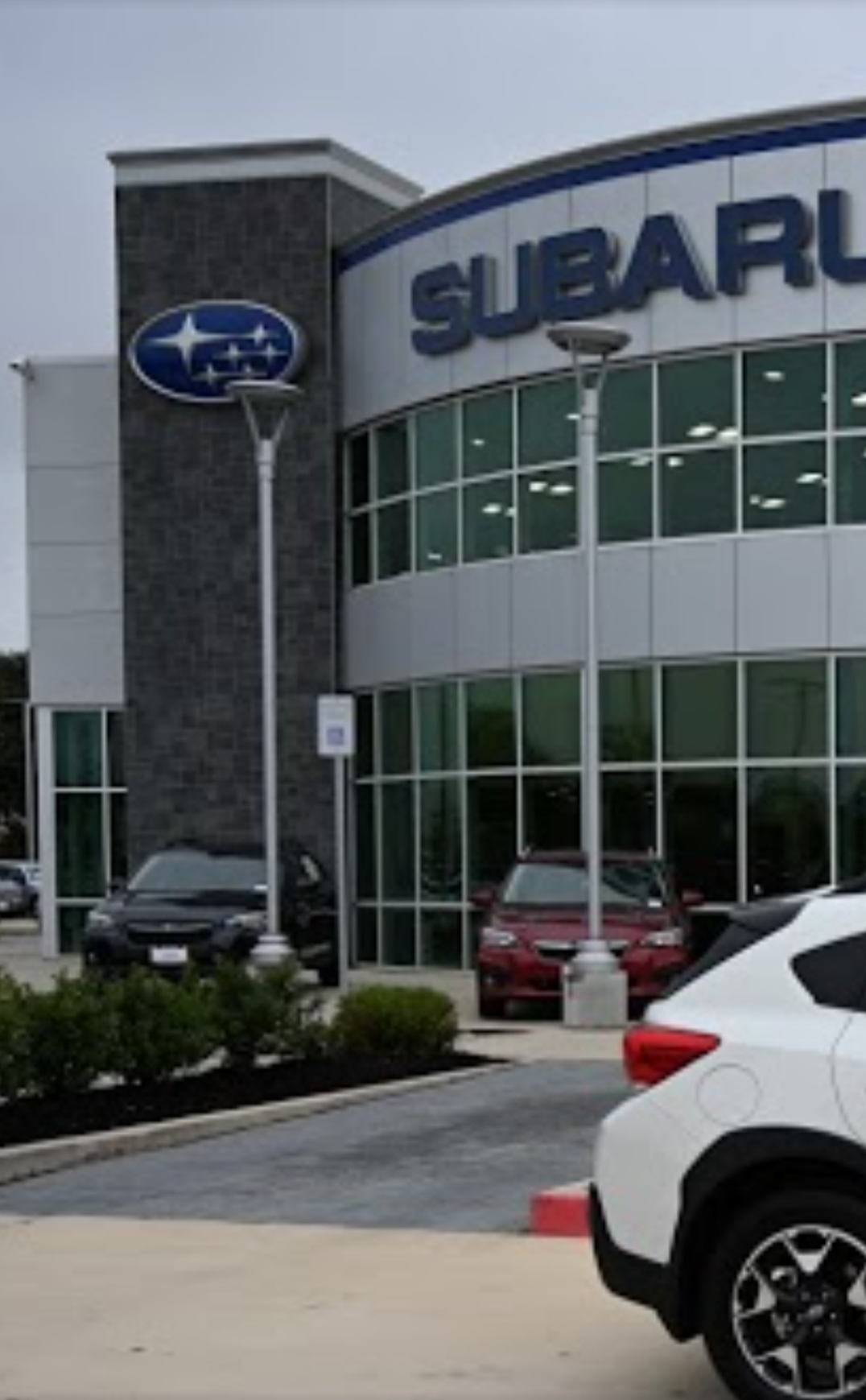

I have a guy that is wanting efflorescence removal on his slate wall at his dealership. I'm familiar with efflorescence removal, and sealing. What I'm not familiar with is quoting vertical surfaces/time required to clean and seal. Anybody want to butt in on what they might charge for this? Would it be better to do a sq/ft or hourly price? I will be masking off all surrounding areas as to the nature of efflorescence removal and wanting to protect their property. Here's the job friends. P.s. they have a sky jack that we will be allowed to use.. it will be essentially 2 sides. The other 2 are small biscuits.

You don't have to itemize line items. You can do your computations, come up with what you feel the job is worth and just put a total.
You can put verbiage like "the total includes labor & materials necessary to complete the project."

I think Mike's point is that the efflorescence will come back until the water issue is solved. A silicone water repellent would enhance water runoff and limit efflorescence if the moisture is indeed coming from the surface from runoff and not from a moisture problem behind the tile. I believe Stone Pro or Stone Tech have such a product which you could add to the ticket.
115,924
Dry Treat's Stain Proof is regarded as one of, if not THE best penetrative sealer to block the mineral travel if you really want to take this on.
I would offer no warranty what so ever. Mother Nature is too unpredictable.

Where is this located?
Dfw, Tx. I'm almost certain the water is not coming from behind the tile as there is a cap on the "monolith" as seen in photos, and they would have bigger problems if it is coming from the interior of the building, why I think it must be rain water as well as the way the efflorescence is forming on the tile. I was going to offer 1 year warranty after I sealed it but maybe that's not going to be such a great idea. I might just have a conversation about continued maintenance if he is not ok with a no warranty policy on the sealer.

Pictures are not clear enough to see. 2 options to remove are chemical or mechanical. on vertical gravity work against you, so i would media blast clean if needed
Dry treat is some stinky sealer, expensive also, so you better factor that in if you go that route. we did an entire limestone pool deck with dry treat sk-40 after grinding to repitch standing water to secondary catches
I would also be asking if he wants to keep the natural look or if he wants to enhance.
