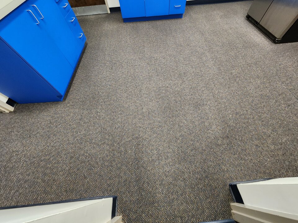

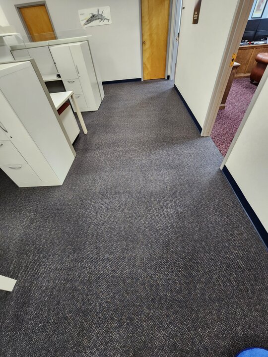

I cleaned a factory office using vlm method recently and tried out Commercial Magic, which is Vacaway's high pH encap. I have never used a high pH vlm cleaning agent before. It caused this whitish streaking or discoloration effect that I have never seen. Aggressive raking improved it but didn't completely correct it. I fully hydrated the carpet fibers and scrubbed with a tan fiber pad, then went over the area again with a premoistened microfiber bonnet, all using a 175...
We've cleaned for this company 3 times now and they really like us, I never heard anything from the owner after this recent job, and I've always told him to contact me if they have any issues at all. So I am guessing the white discoloration went away after we left. Could this just be some type of white foam effect that takes a while to dissipate? Or...?

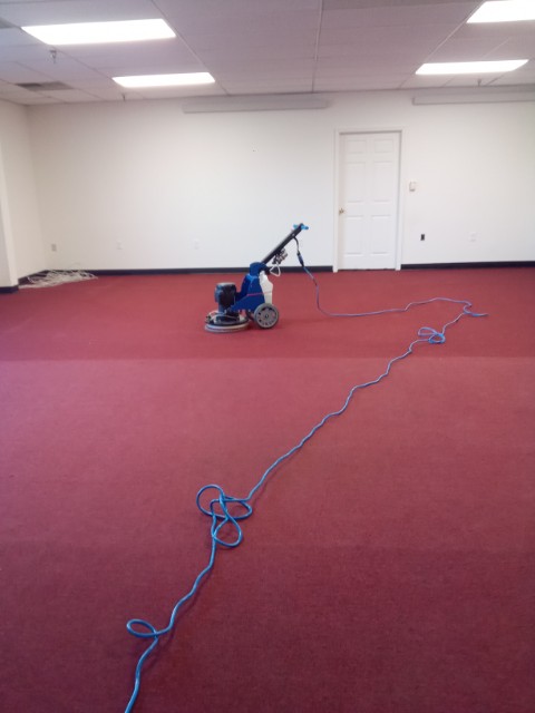

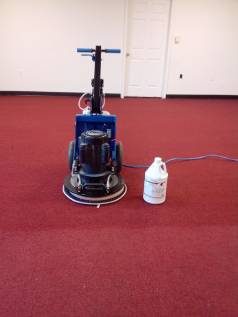

Not sure what caused that but VacAway Commercial Magic is not the cause
Commercial Magic is a fantastic crystallizing encap
I mostly use it on trashed carpet usually found in rental apartments
But I did use it on that CGD and no streaks or discoloration

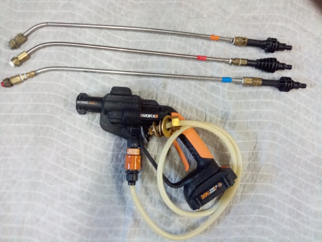

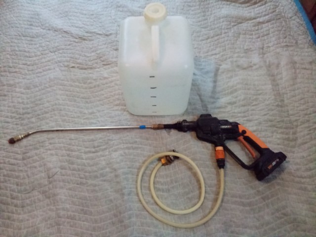

What size jet was on the multi sprayer
I don't think you wetted the carpet enough
You would need a 8004 or larger
By the time your bonnet hit it, it was almost or already dry
If you can't get a OP with sprayer buy a WORX Sprayer. It's the best sprayer for VLM. I use it on all my VLM residential work
It puts out enough solution to properly wet the carpet. You can use the wand that comes with it or replace it. I replaced the WORX wand with Multi Sprayer wands. You just need to get the short WORX extensions
You can buy the WORX Sprayer from WORX off ebay refurbished like new. Not sure what the price is now but probably around $75
