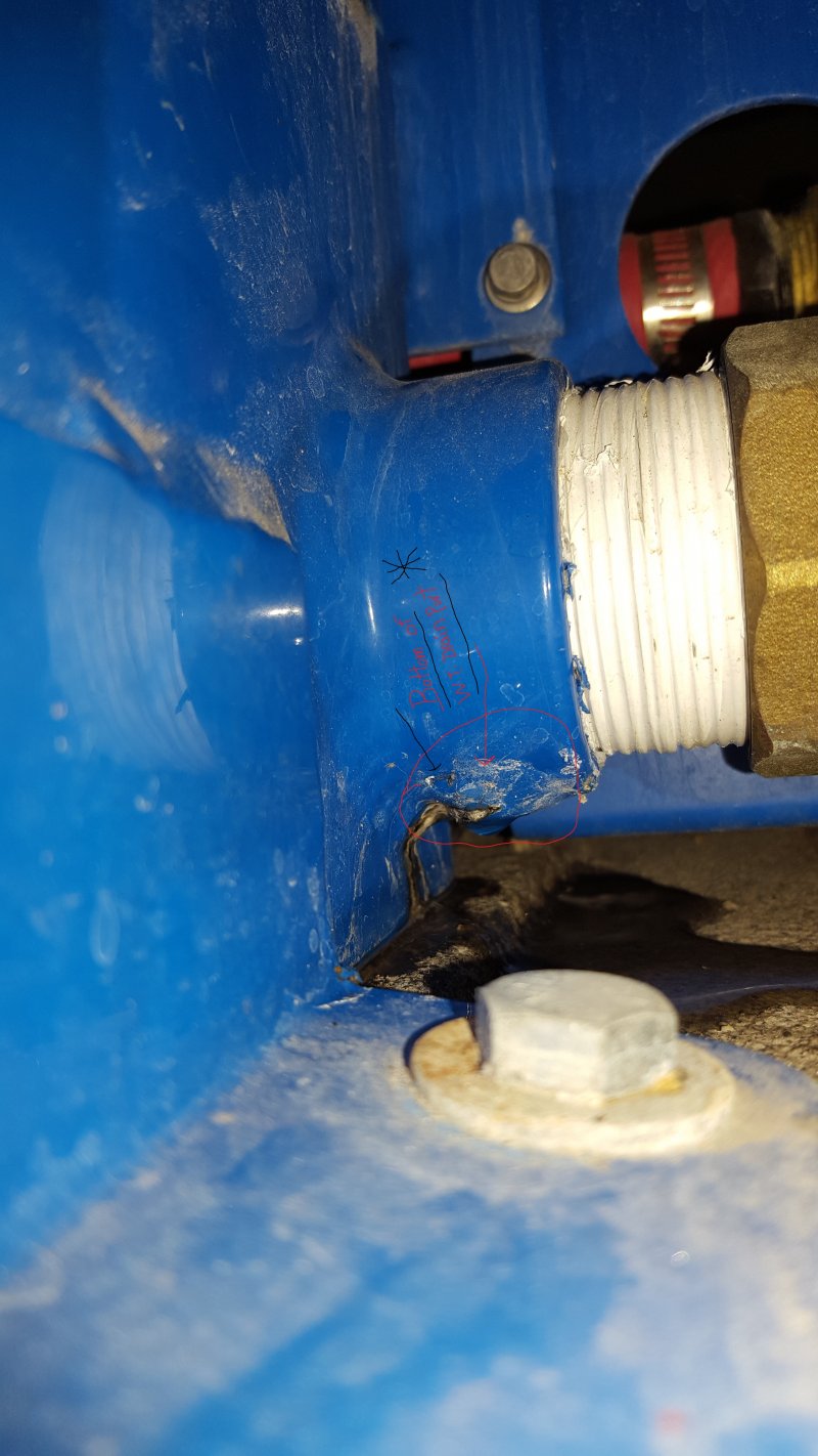

Our 2013 Hydramaster CDS unit began leaking from the "bung hole" under the waste tank discharge area. Our local service shop claims it is from corrosion in the aluminum. Seems a little odd a 4 year old unit that is well taken care of, dumped daily, and rinsed out weekly would have this kind of issue in such a short amount of time.
Anyone had this happen? We have an '08 CDS that runs day and night and never has had an issue like this. We bought 2 CDS units in 2013 and the other unit shows no sign of any corrosion. We are currently seeking to create a warranty claim, so we'll see how that goes. Sani-Bright Unit #14 Waste Tank  Bung Hole Port 072417 1 of 2.jpg
I agree 4 years on a tank I wouldn't think you'd have an issue. We've had aluminum tanks last nearly 20 years with a lot less care.
Could it be the pipe thread that goes into the tank cracked and caused corrosion? :headscratch:

Had that happen with my CDS. Not so fast. Exact same place.
Seems like a problem in design or manufacturing with their tanks to me.

A friend of mine had to weld 2 cds tanks for another cleaner, for corrosion also.. I know other people say to rinse out tanks daily..
I'd still like a sprinkler type setup for a waste tank cleanout.. My pops good friend who owned another cleaning company used a hose that he made to help rinse out the "fine silt" that would accumulate on the bottom of the tanks..

Why do they not make the tanks with a sloped bottom, so that all you have to do is rinse it with a garden hose? Flat bottom is not the way to do it..... then, nothing would accumulate.....

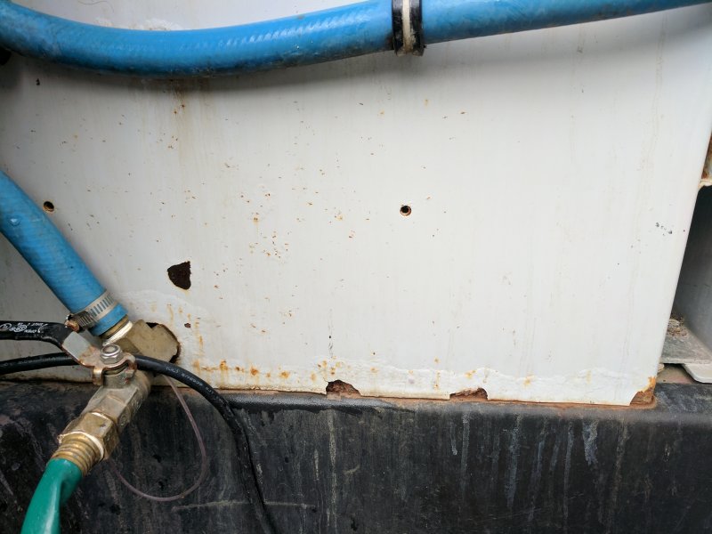

Grass ain't always greener though, this is the front of the water pond on my 18 month old pro1200. Like you it's cleaned fairly often but looks like shit for a unit less than two years old
Same thing happened to the finish on my prochem chemical rack . after 6 months was corroding wherever the slightest bit of moisture hit it. Same finish u have on that tank. Its a shame. You spend a ton of money on these things and should be able to hold up under any condition. A few months after buying, looks like crap.

Is that water pond powder coated?
I have never had anything powder coated that lasts more than 2 years. I cring every time a manufacturer puts powder coated as one of their features.

Jebus, is that the inside?
No right on the front of the water pond, my new rig with 160 hours is showing rust at the bottom also. It's very visible and looks like crap. My local interlink is looking into it
