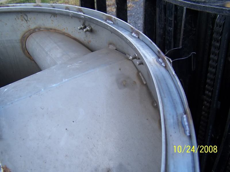

Waste tank lid seal.
116,045
I tired the rubber strip/glue kit from BlueLINE.
Didn't stick real well. Some areas the strip has moved.
I like how the new 7000s used Beatty's idea and put the seal on the tank rim instead of the lid.
Any ideas short of welding on how I could get a makeshift seal on my old tank?
I'm thinking of cutting a thin hose down the center and sliding it over the rim.
