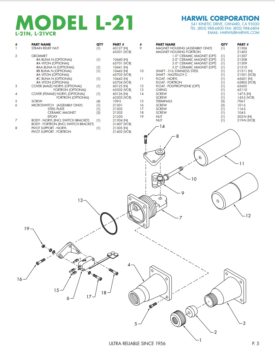

I didn't even look since afaik it is just a valve......but I will
also the harwil level switch you don't necessarily have to buy the whole thing
you'll probably have to pull the switch part number after disassembly unless going straight to harwil (or supplier in vid)

All the parts for both floats had been taken off, so I'm starting from scratch.
I was able to get the complete waste tank float valve and assembly from Jon Don, but I had to order from Jon Don and Magic Wand to get all the correct parts for the water box. Now I'm shopping for a fuel tap kit. I just ordered something off Ebay. I hope it works.
