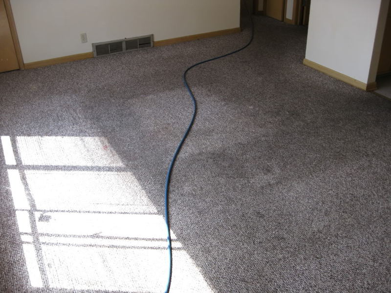

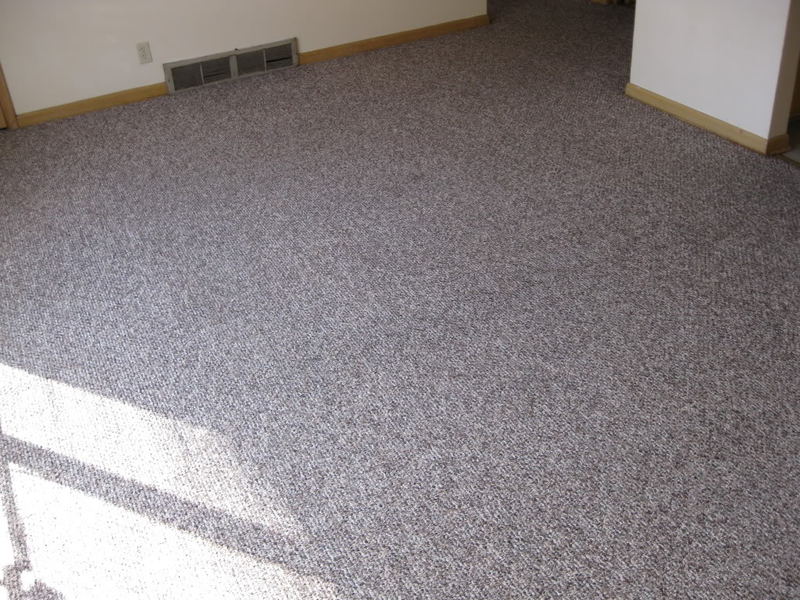

I moved my brother up here from Vegas last month. To help him start making some cash I put together a trailer with a 2100 in it that we rent out (him included if needed) He has been using it to help a local guy out with his apartments. I went out with him on Tuesday and we knocked out 21 3 bedroom apts in 6 hours (from the time the prespray went down until we turned the machine off)
I had been wanting to compare Powerstrike to Extreme Clean and boy did I get my chance. Now I will say I still love extreme clean and prefer the smell but at 12oz of powerstrike to 18 of extreme clean there was no comparrison (both had 4oz of energy added) We sprayed and sucked no pre-vac no scrub. Ran Steam Way formual A+ Set at 2gph Wand was a Prochem 4 Jet with 95015's and Slot Glide with the Steam Way breathing fire.
Here are pics (taken with my phone)of just one apartment (Just the living room) only 2 where not this bad

I am still learning and experimenting w/ my chemical preferences. I like what I see....something like that; I can't believe..I would have been thinking 16 ounces of Quake HD (12.8ph) + a couple oz. of a citrus booster to attack that crud. Looks great!! I am running a Steamway that I had rebuilt and easily will take off to 230 degrees so I have to have my helper check often since it has a new heating unit. What is the cost savings from the PowerStrike? Newbie here only dozen jobs under my belt, but have had great success so far!
