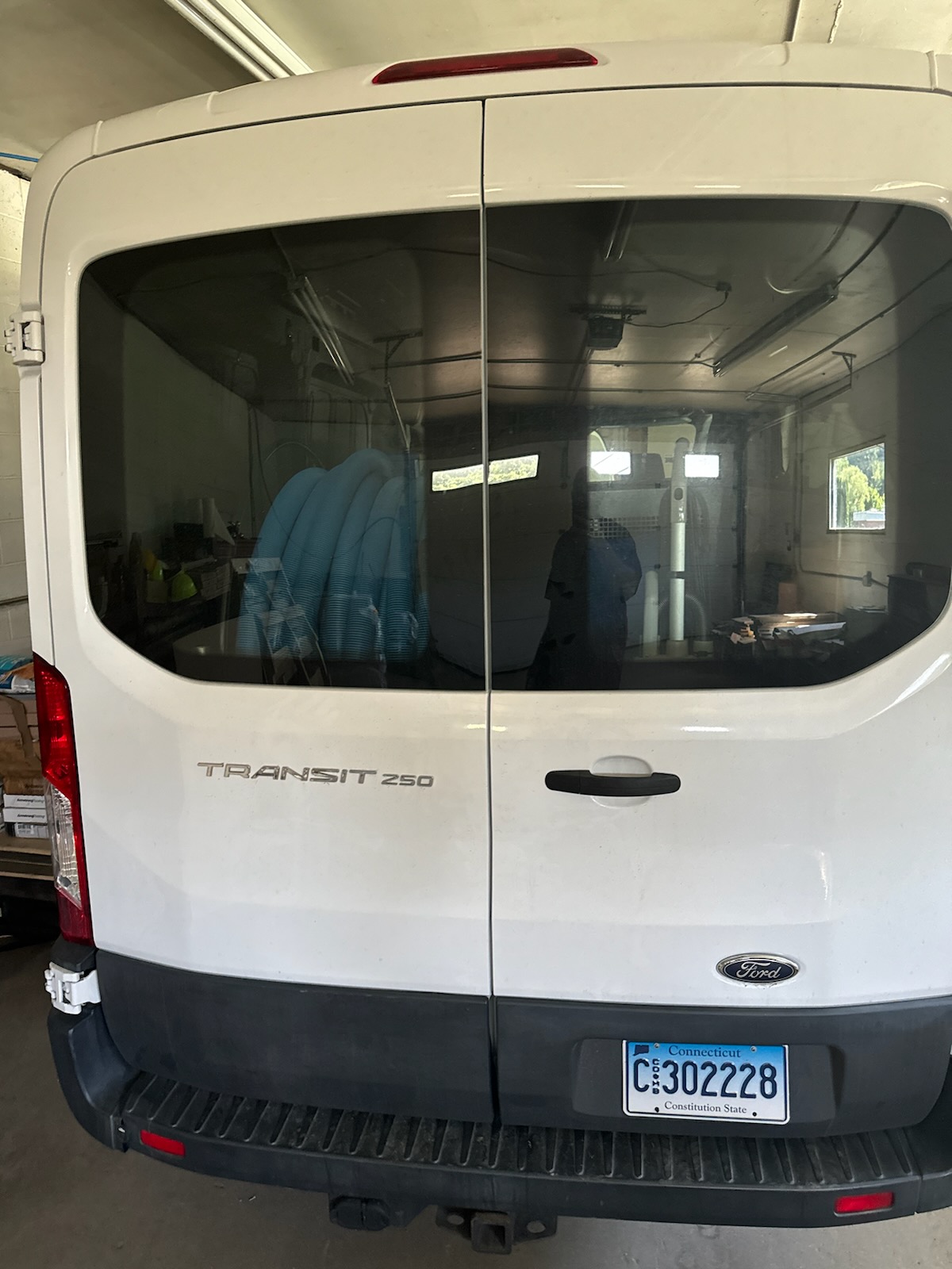

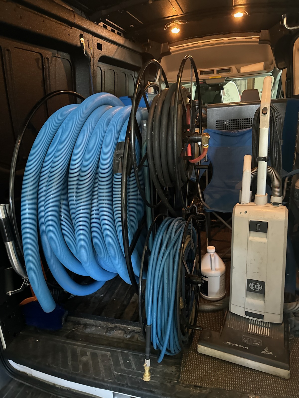

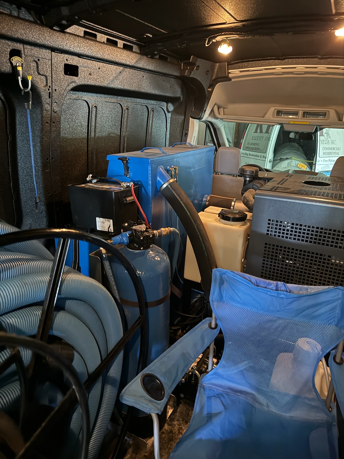

For that setup above, I would look for a tank that can be installed under the hose reels. A bunch of wasted space is in that area

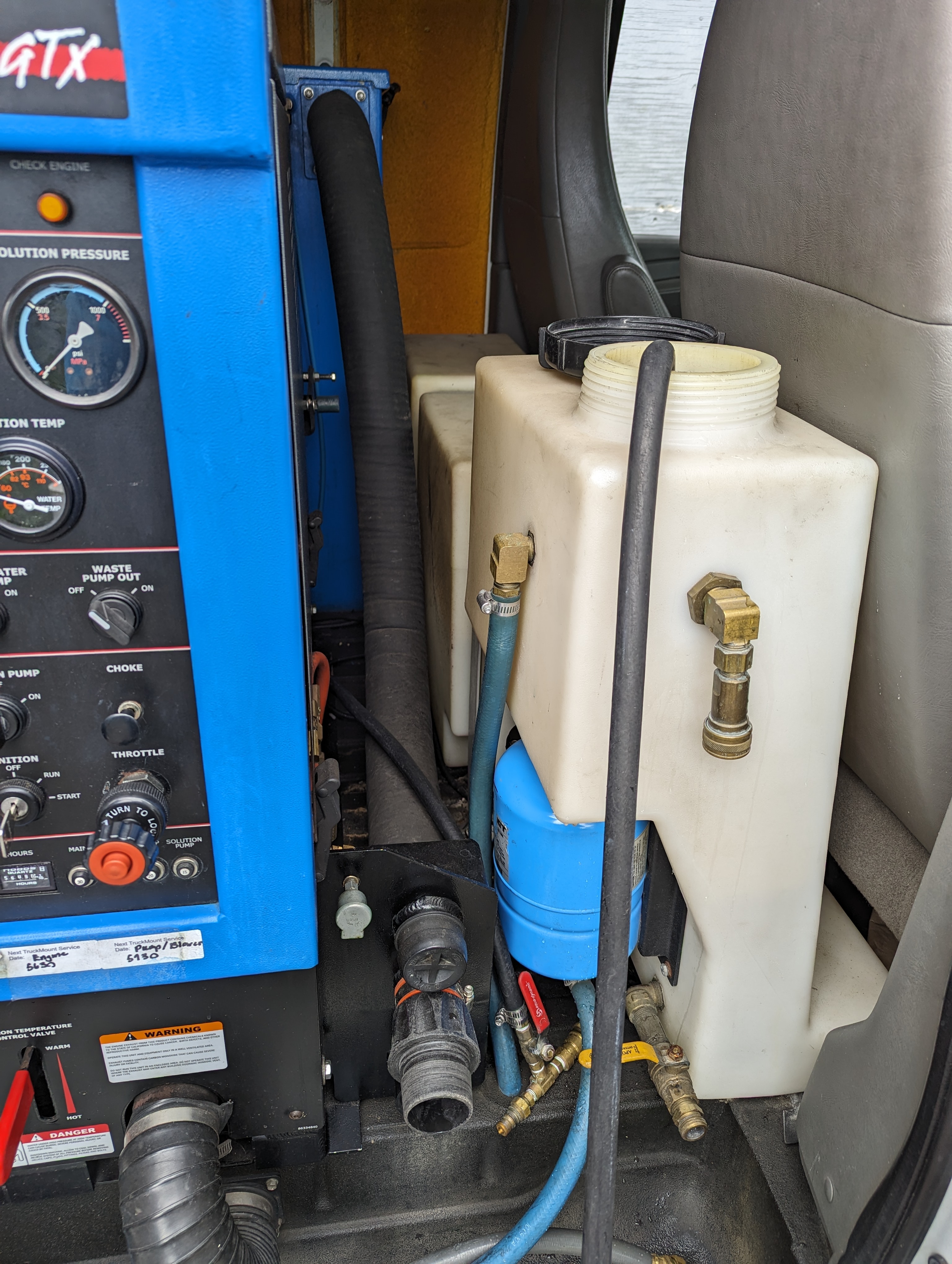

I was lucky enough when I bought my Apex, it came with a factory fresh water tank. I believe it's aprox 90 gallons. I can fill it from the top as I'm doing here, attach a hose to a fitting and it will stop when full and what nice, there is a overflow plumbed into the truck so that you can't overflow it. This is the first truck mount that I have had a decent sized fresh tank and loving it so far. We have good water access here, so not really necessary but it eliminates setting up a fresh hose every job.
