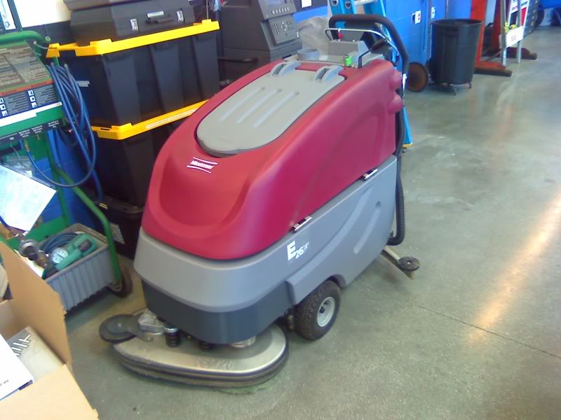

What can you Janitors tell me about this machine?
116,071
I have a Auto Dealership that bought one to maintain their new tile floors.
Will it work on grout that's normally recessed?

for the most part yea..
lets see the pics of the floor...
track down a pair of the bassine brushes for it...the brushes well get in better then a pad...
what else you wanna know?

Don't think the squeegee will pull the dirty solution from the grout linesI would fit in a piece of Aluminum pipe fitted with a hole glide that has 2 2 in hoses to a Y 2.5 to a vac booster tied into the onboard vac system

I have been using automatic walk-behind scrubbers for years and they never do much at all for grout. It doesn't matter if you use brushes, pads or how strong the chemicals are.
