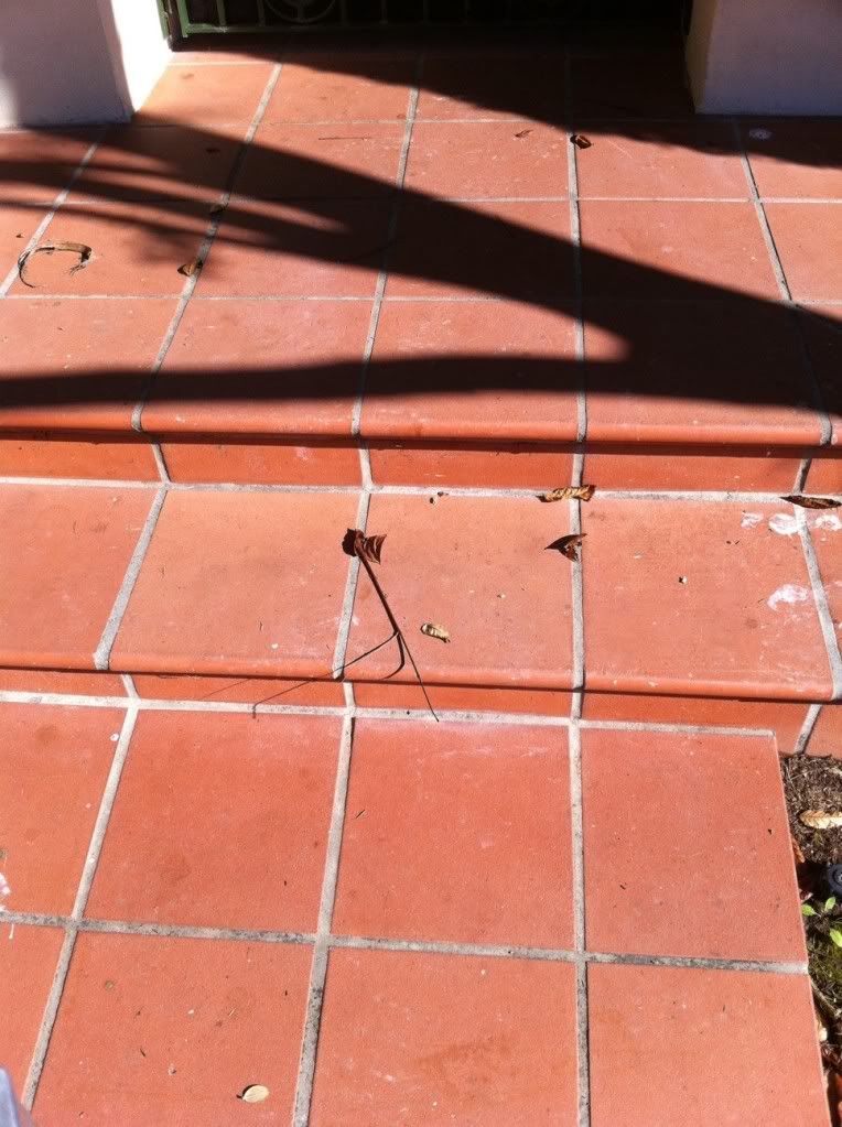

what chems and procedure would you use to clean and seal
jimmyolas
Feb 20, 2008
80
what chems and procedure would you use to clean and seal .
there is about 2500 sq ft and some of it has more algae, mildew in the grout .
need to clean and seal .
thanks , jimmy

I would clean with normal process for ceramic tile
Sweep
Apply an alkaline prespray - My choice is Viper Venom allow 10 minutes dwell time
Scrub worst grout lines with a grout brush
Agitate / rinse / extract with a spinning tool like SX-12 or Turbo
Allow time to dry. Could be accelerated with air movers
Seal with Hydroforce premium Stone and grout sealer or if they liked the look Revive Color Enhancing seal
Do not apply a topical sealer. It will wear unevenly and look blotchy after a while.

your presrpay will soak right into that stuff and dry doing little for cleaning. Most of the time just 2000psi and the turbo will do wonders. spray on some Glaze&seal wet look and call it a day.

I had good luck on one job that I mixed bleach with Powermax. It was mopped on, kept wet, scrubbed then turboed.
Albert
jimmyolas
Feb 20, 2008
80
This was priced and sold as a regukar cleaning and sealing of tile.
My approach is planned with viper venom , wieghted cimex and selective hand scrubbing
As needed. Then rinse , first seal grout then tile with paint roller
Using impregmator sealer , 1 coat or maybe 2
He was told it would be improved resusts not perfect
