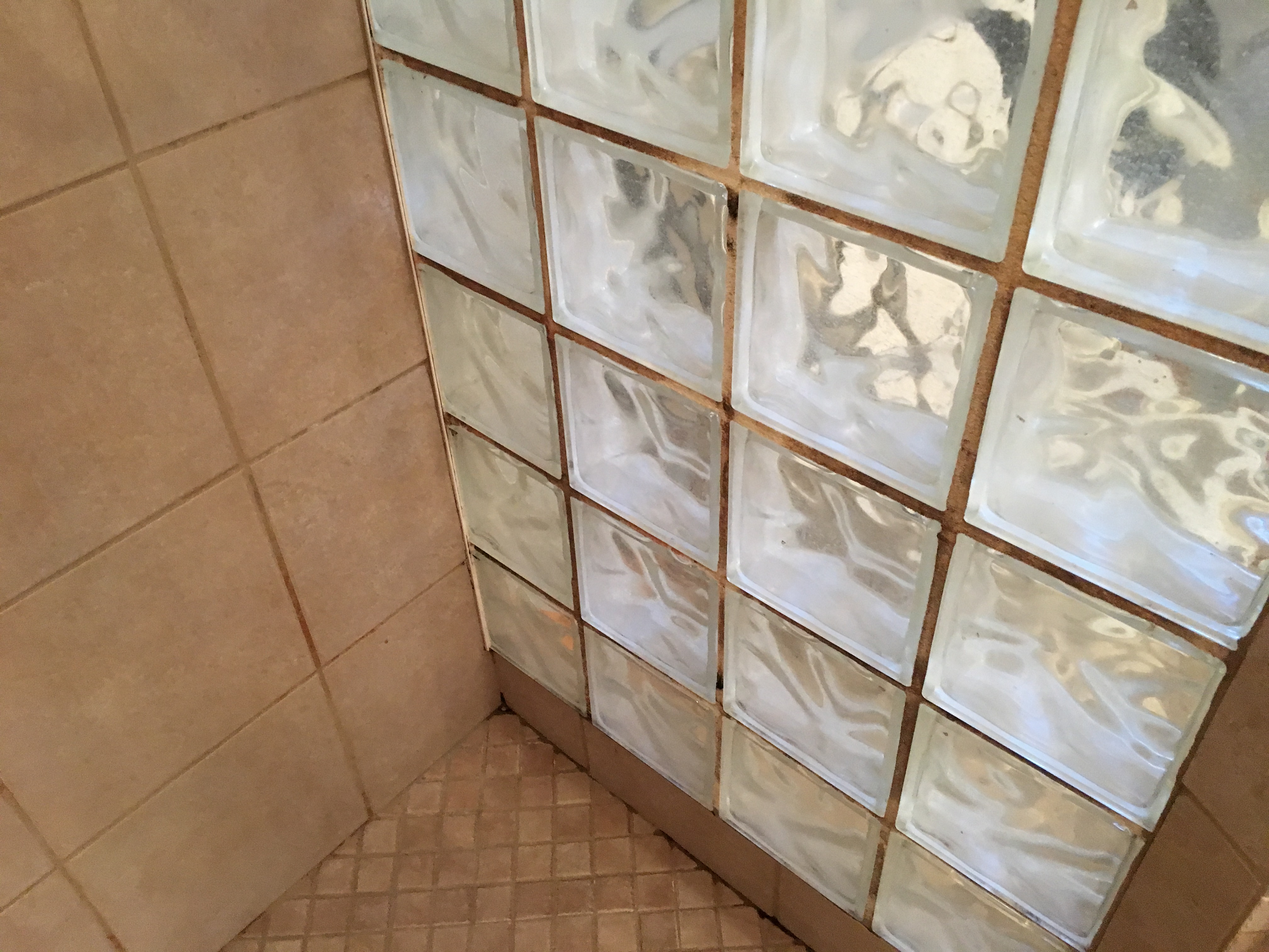

Sometimes the glass blocks aren't glass. There are plastic glass blocks...for some reason. Quick check before you throw acid on it.

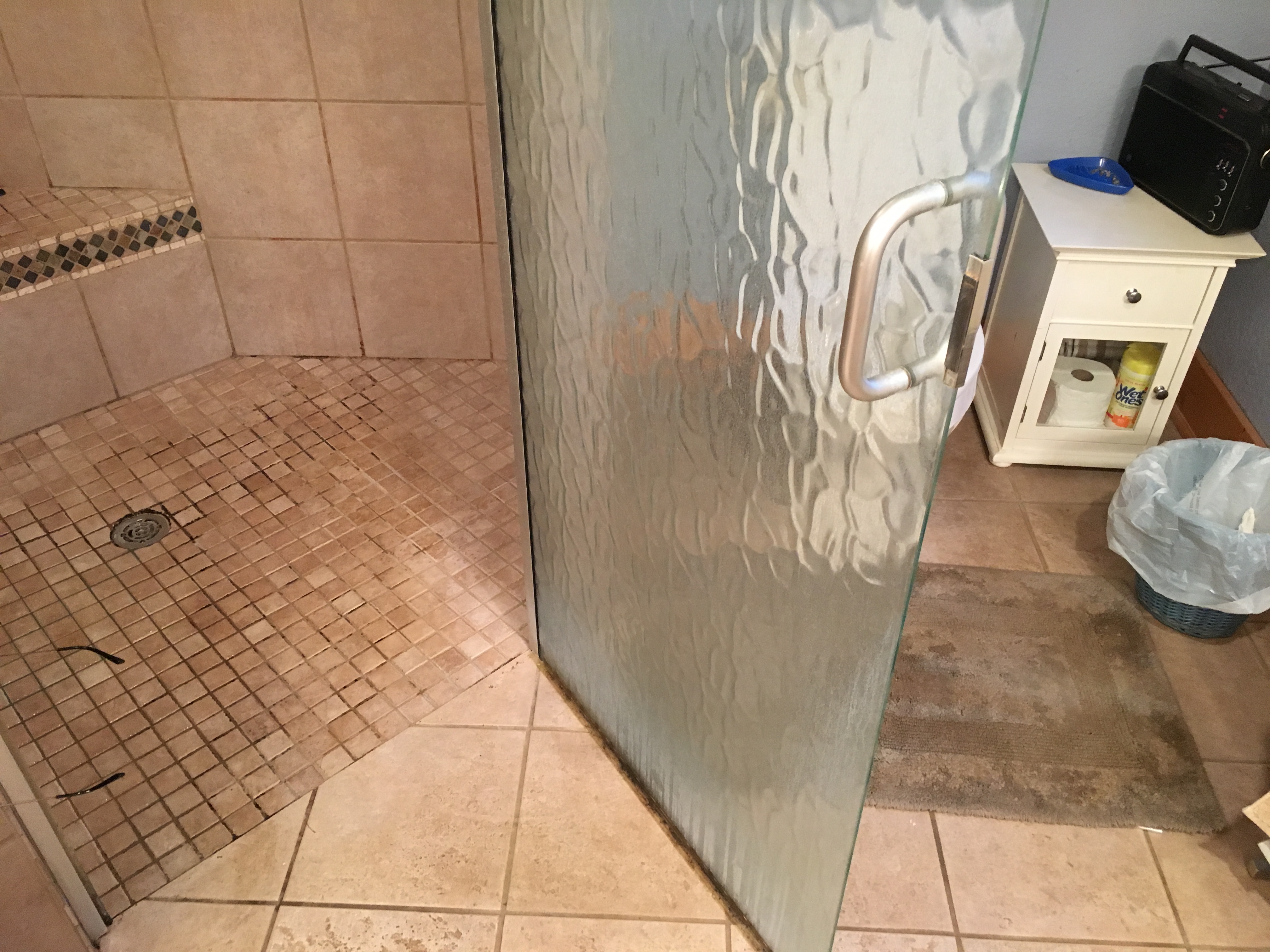

I've just placed the order of the water stain remover and the steel wool. I scheduled this job for the 10th of January, so I'll let you know how it goes. I don't know if you saw that tile also... This tile is 7years old and has never been sealed. So I"m gonna have some major mildew stain problems also

I just ordered some. How well does it work on the hard water spots on ceramic tile?
works great...take a white pad and scrub it in really good... ......then put some water in a spray bottle and wipe all the residue off...
for really large areas I use a small white pad and put the stone scrub on the tile......and then I use my Makita polisher with a white pad and scrub it in.......more aggressive and moves faster....
