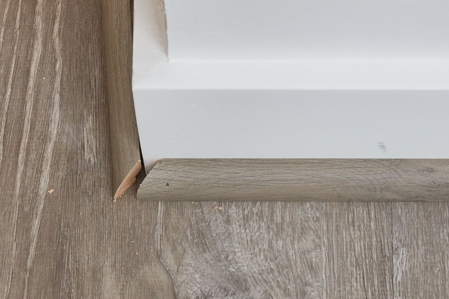

lay the LVP over the old hard surface and butt it up to the baseboard
then it wasn't installed right.

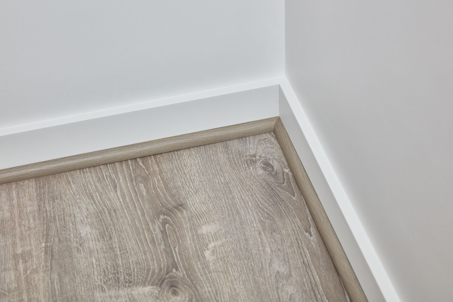

nothing wrong with 1/4 rnd, but thinner shoe mold looks better.

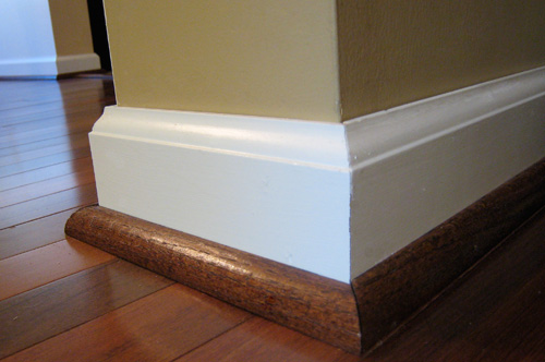

and if they want colonial doorstop for shoe, (what that first pic looks like to me) which I agree looks much nicer, additional cost's apply
(material is more expensive)
otherwise, MDF is trailer park crap as far as I'm concerned and it's not worth pulling.
Pulling base in general is can be a fool's errand too, due to all the snafus that can happen
(that you have no clue about until you've pulled a few thousand feet to know what you don't know)
Now, let me help you so you don't sound like a complete idiot

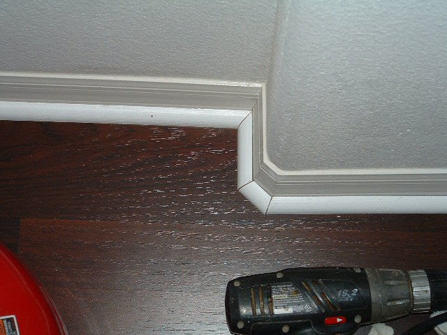

that's the only molding that's finished in your pics
That one's not finished.
Needs caulked and painted same as base mold to look good.
It would look fine then
that one's the wrong color .
Shoe should be same color as base.
That would stick out like a sore thumb regardless if profile'd shoe was used.
