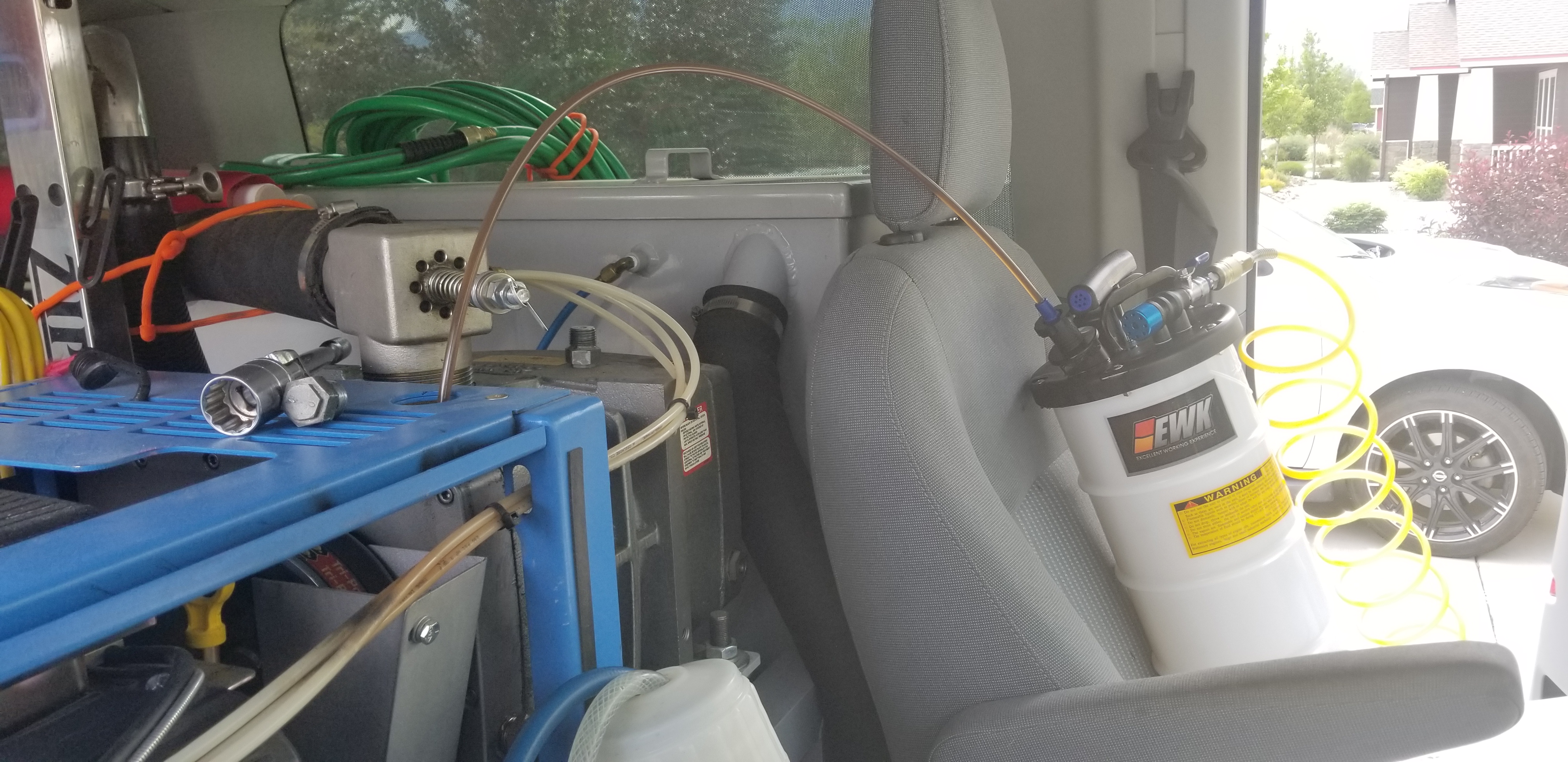

Drains a 3.5 quart blower in under five minutes

I just worry bout any sludgy oil at the bottom that possibly gets left behind with removing oil that way?
One of gearboxes on my vans has no sump plug so I remove the speedo sensor and drain oil through that instead of from the top

Id imagine you can do that every once in a while to give it good flushing.

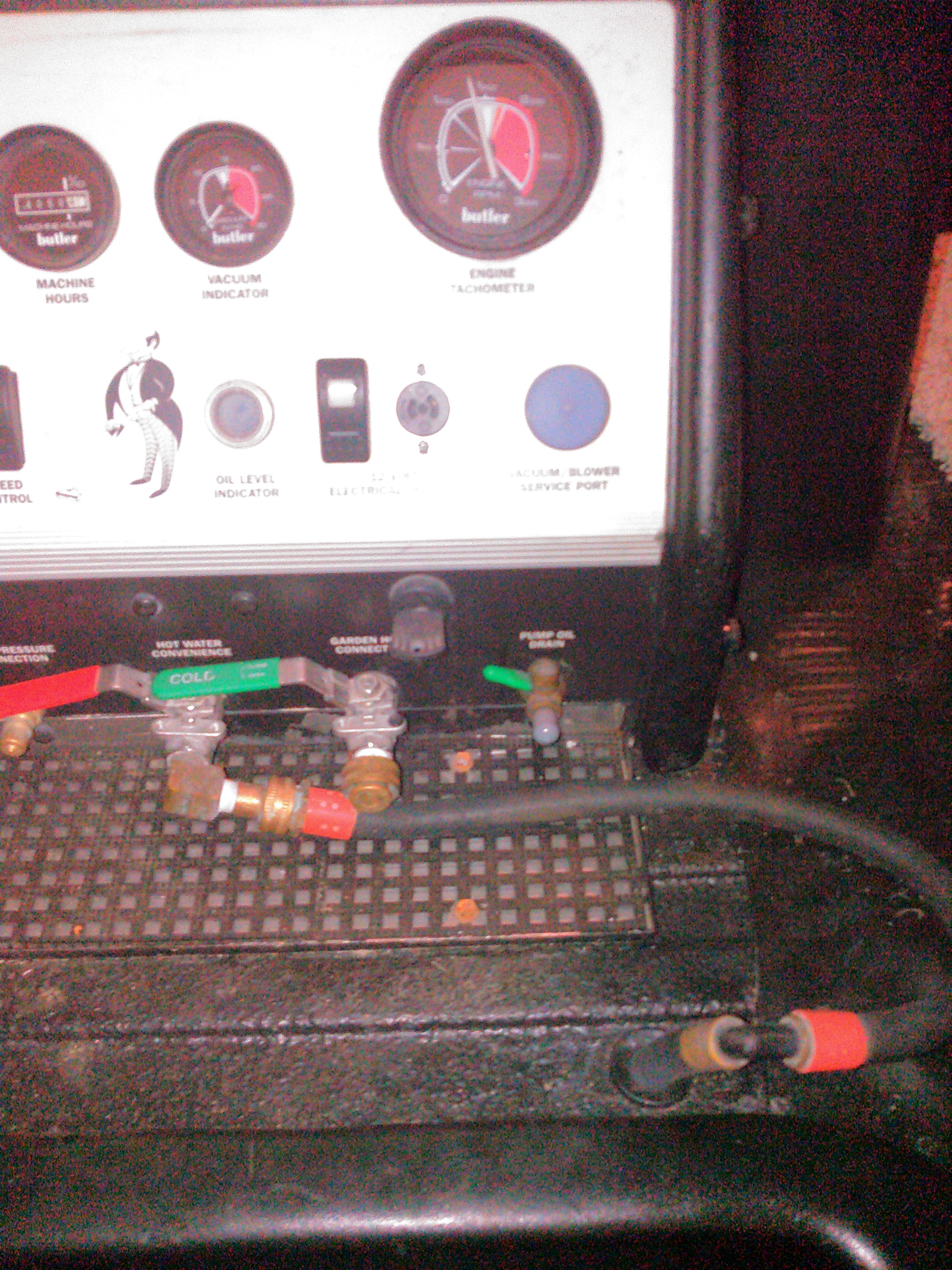

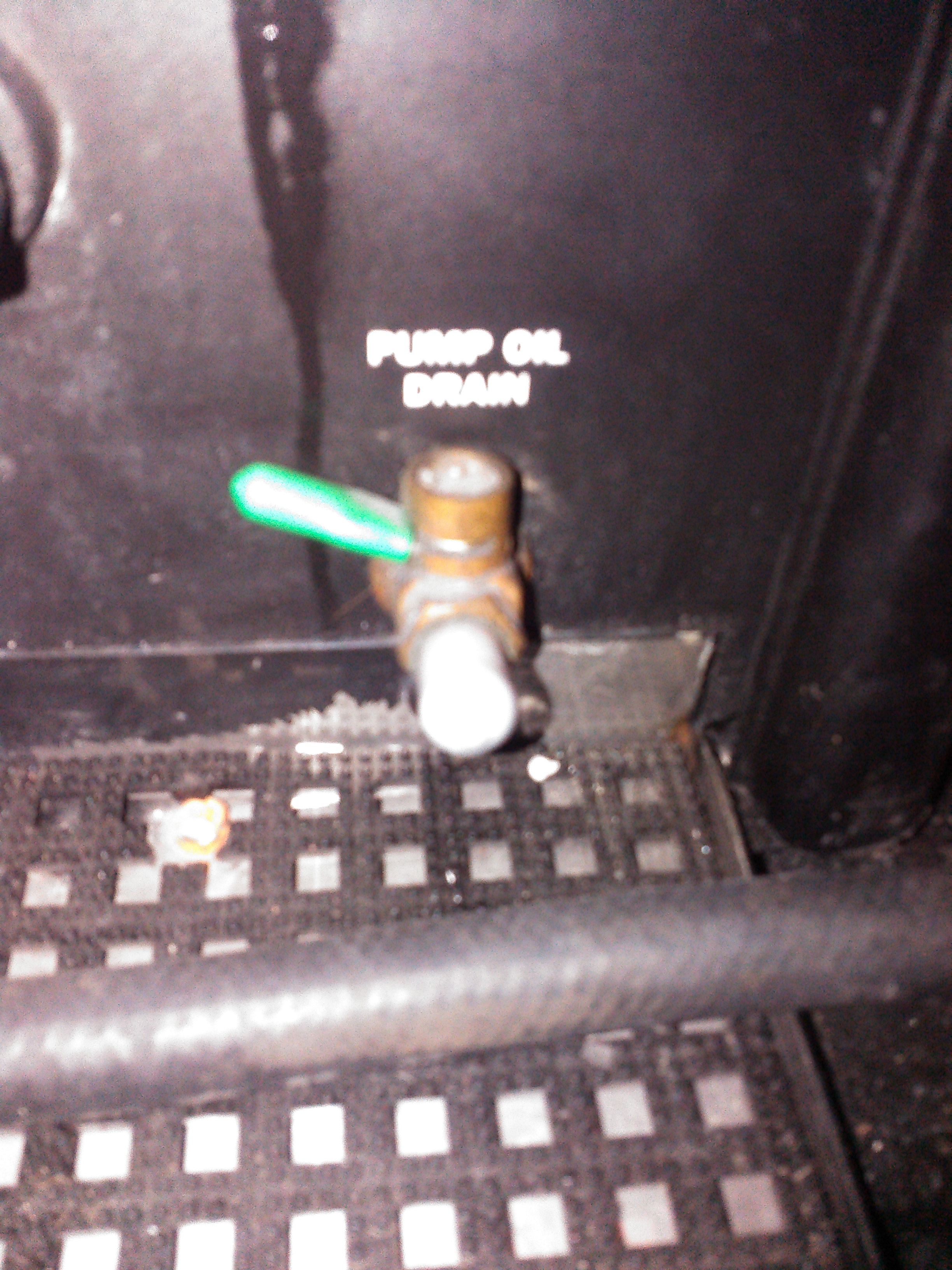

CDS units have drain hoses that exit behind the passenger seat. Anyone that has an older unit with a drain hose should check and replace if it gets stiff. It can crack and drain your blower while you're working.
