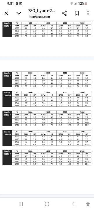

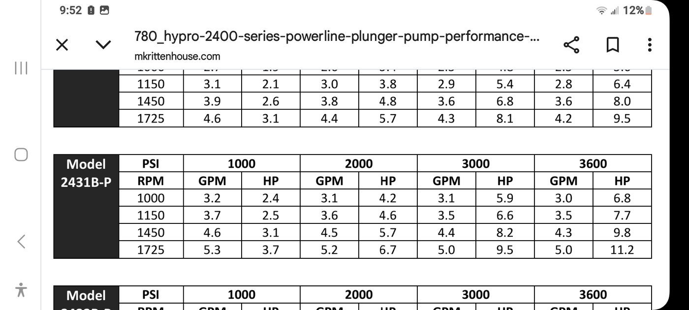

I would be more interested in frame & input shaft size (size compared to what i have)flow (gpm) and power requirements of the pump (bhp) seal type ie: nitrile,viton buetil etc and temperature rated you want a pump that your not operating at its maximum rating ie if you regularly run 1000 psi @ 3.5 gpm you would want a pump that is rated at 1750psi+@ somewhere around 5gpm at your operating rpm if this makes sense keep in mind that gpm changes and is rated at a specific rpm .if you run the pump slower it will pump less volume . I use hypro pumps heres performance charts for 2400series as an example of what im talking about

Thanks for the charts. I see how the pumps gpm and hp change according to engine rpm. What doesn't make sense to me is how, at a given rpm the gpm only changes by .1 or .2 when looking at 1000 psi or 2000 psi. I thought the restriction required to go up that much in pressure would necessarily reduce the flow of gpm much more than that?
And how does my current CDS setup max out at around 1000 psi if my General pump at 1450 rpms puts out 2500 psi? And my unloader valve the Pulsar 4 PA goes up to 2300 psi? I can't find charts on my pump such as the ones you shared for Hypro so maybe I am reading that wrong. But, I feel like I'm close to understanding how the rpm, gpm, and pressure relationship works but still missing something...
Its putting out the volume but when you set the pressure at the unloader/bypass regulator it is bypassing the unused water somewhere. Some machines bypasses and dumps back into the waterbox, and outers like my machine bypasses back into the inlet side of the pump. For instance, when you stop spraying soulition at the wand the pump doesn't stop pumping...... all the water is at that point being by passed somewhere some machines unload the pressure at the same time by allowing more water to bypass than the pump can produce thus lowering pressure. A demonstration of the would be set your machines pressure @ 450psi ,idle the machine and put a male quick connect in the end of your hose and allow it to dump on the ground youll see your pressure guage drop to near zero. More water is used that the pump can produce @ the set pressure
