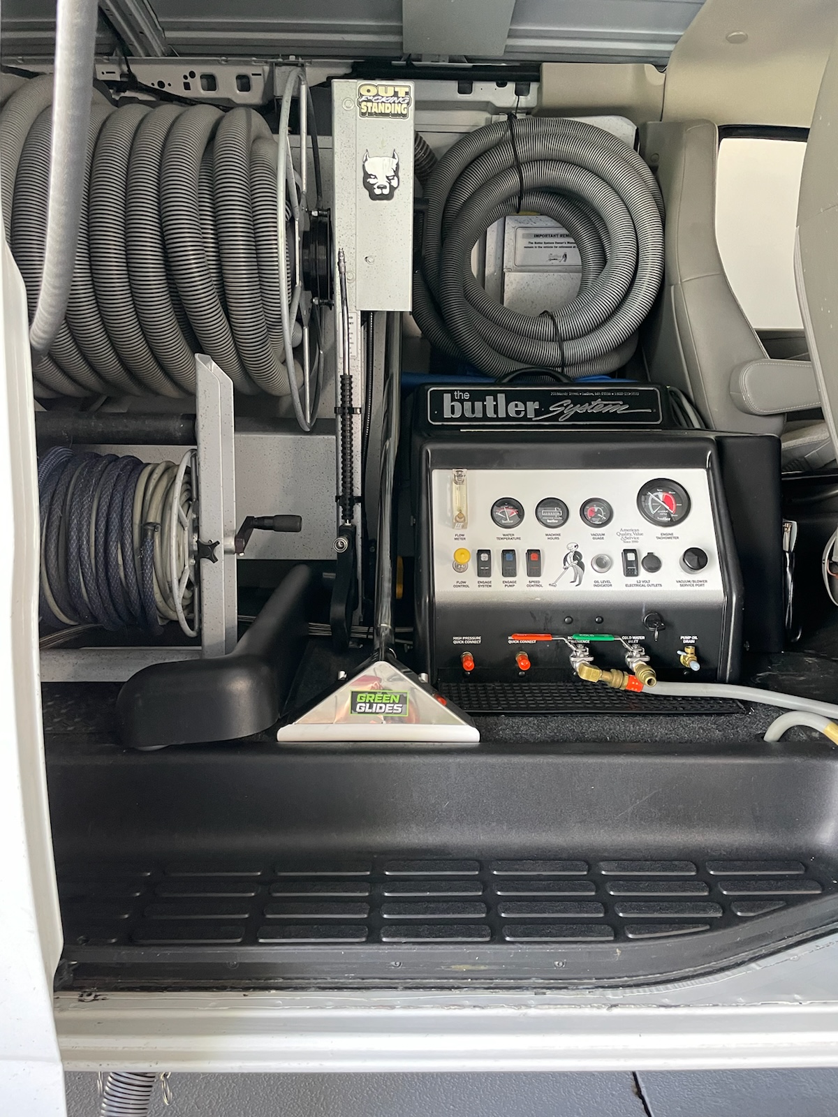

Why do we instinctively wish for more vacuum to solve our over wetting issues when we should be looking to use less water..
115,978
Giant truck mounts, 4 to the door, mega wands, with mega flow..
In the long come to mega complaints of slow drawing and wicking.
Why isn't it just instinctual that we turn down the water and use agitation, dwell time and better chemistry to please our customers...
I can't believe the results I'm getting with my 4 flow wand, and some balance.. IMG_20240523_141647.jpg

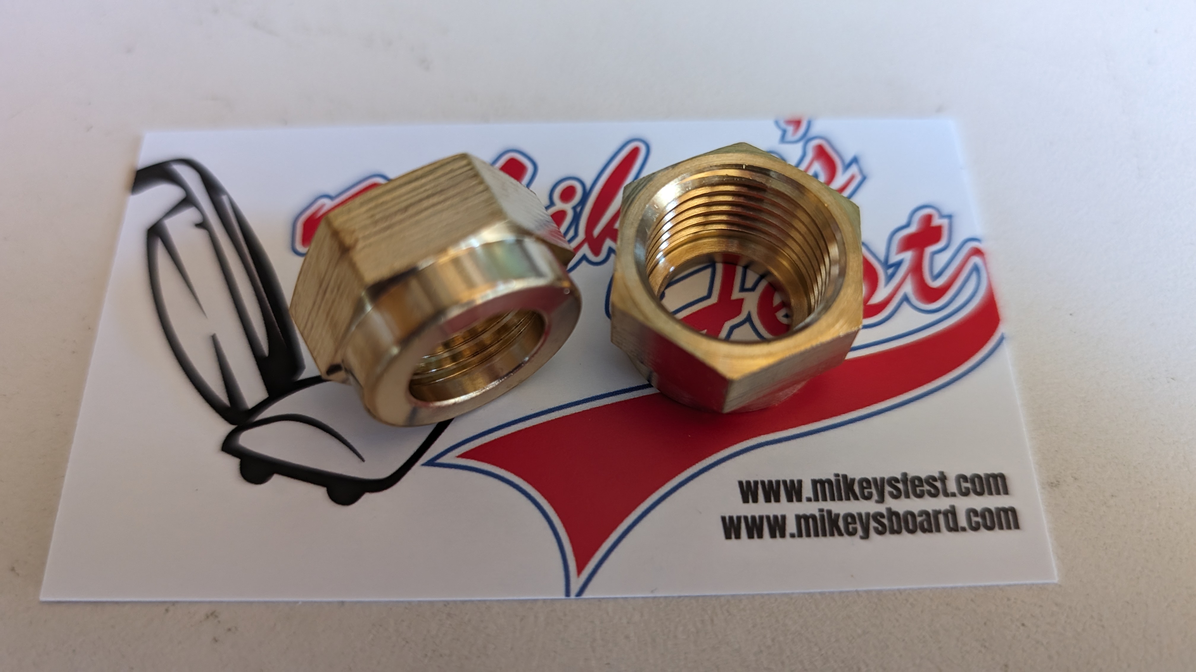

Makes me wonder if your four flow hard surface wand isn't putting out twice of what it should, I'll send you some '01s to see if that doesn't fix your problem
Thanks Mike I appreciate the help. I got my portable running so now I can get back to figuring out hard surface rinsing. A two flow might allow my portable vacs to keep up with it better, flow rate has to be in proportion to suction?
