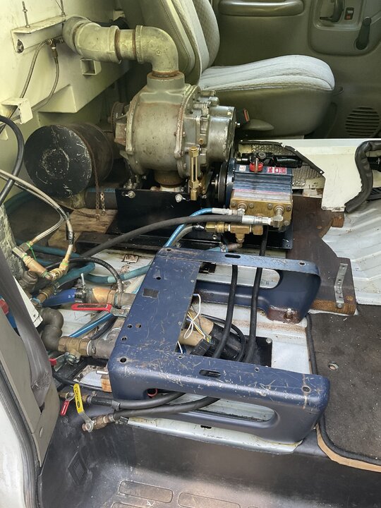

The Cat 5 pump on my old Vortex would draw water from the belly tank. Once in a while it would lose prime but that was usually do to a loose hose connection on the draw side.
So, if a Cat 5 can draw water from a belly tank maybe all high pressure pumps can draw water from belly or saddle tank.
Now, I'm wondering if the fresh water demand pumps the industry has been pushing all these decades are totally unnecessary and were just added for overall expense and complexity for something that was never an issue to begin with.
Your thoughts?
