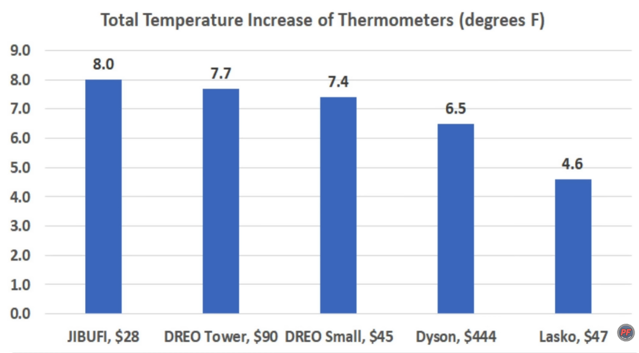

Well I mean we have actual data from plenty of sources almost all quality 1500 watt heaters will provide a very close increase in temperature. See screenshot from project farm electric heater test. Patron heater linked would be very similar to my test results I noted above which kept the van about 10-12 degrees above ambient in my testing last year. So when you are 24F cutting it close, 22F and below would be no bueno for 1500w electric heater.
I would note that if $125 solved my issue over the same priced diesel heater without the install time and fuel that takes I would jump on it, but I don't think the data supports that.
Source for data in image:
View: https://www.youtube.com/watch?v=ND2mrzPnBic

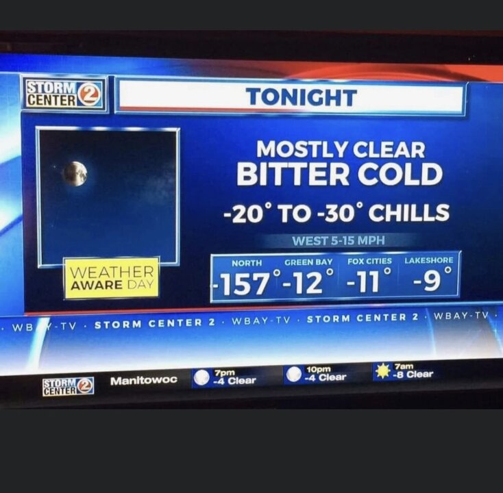

Going by that logic, most northern companies would be shut down for the entire winter. I have personally cleaned in -20 degree actual temperatures and a lot of our crews even colder. Not fun but it is possible to do it. My rule of thumb is you have to have the hot water flowing within 60 seconds of it hitting the ground.
Also, wind chill does not impact your equipment. It refers to how the actual temperature along with the wind feels on your skin. 35 degrees outside with 25 mph winds create a wind chill of about 23 degrees. You may feel it but it will not freeze your equipment.
Very interesting to know. I had no idea cleaning was done at those temperatures. That doesn't sound fun but damn I am impressed that can be done.
