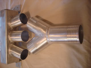

These are my mounted Ys both 2" and 2.5", designed to be your new "hook up" point at the machine, easily bolted to floor or side of machine.

This is my new 2.5" Super Y shown next to the vac manifold, it's 2.5" on all three sides.

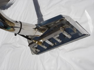

Now I have added a 5 jet manifold (most wands come with 4) and 5 GreenGlides check valve jet extensions, and 5 11002 jets.
This manifold places the jets at a 45º to the carpet.
Next I add a thermoplastic solution line.
Here is the assembly free standing:

danggggg looks nice....whats the vac manifold??
also i needs at least a 3 jet for that stupid work master one...
yea 2 jets on a 14" wand, what were they smokin'?
The vac manifold is better illustrated in the V/AT thread, it's for connecting 3 two inch hoses to two 2.5" hoses.

yea i then saw that over there and felt stupid....soooo got any ideas for that manifold??? i tried making my own but ehhh stuck out to far and got to close to the wand...wouldnt work...
btw that glide is working out slick...i kinda like to be able to take it off if needs be

What's the make up of the solution line. It isn't one of those cheap psi ones that the Sux12 comes with is it? The wand looks great and how easy it looks to fix.
