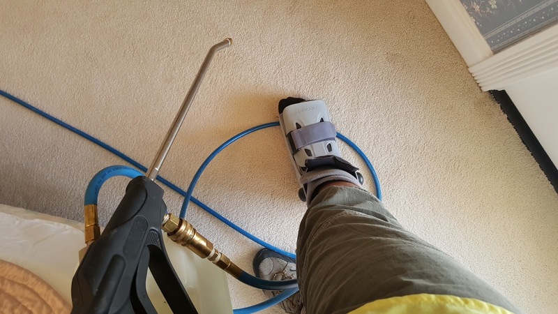

I'm no @Mark Saiger , more of a @Mikey P with a broken foot cleaner...
I'm no poser..
