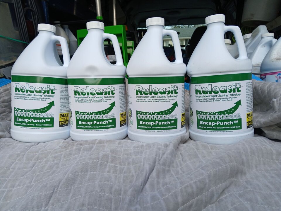

I'm getting excellent results using Releasit Hydrox and Encap Punch on Residential and my Apt Complex
I ordered two cases of Encap Punch but for the second time in 6 weeks Fed Ex damaged something I ordered so I only got one
Yes I know. Nobody cares

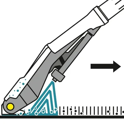

Look at the picture if pictures help with the diagonal jets . Sorry, I couldn't find a video showing how the water is extracted. You seem to be one of those guys that needs picture and video to comprehend

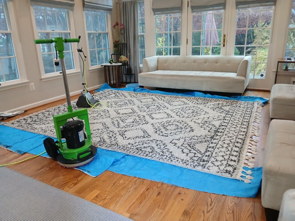

Can I add 4 oz of Odorcide Fresh Scent to Hydrox or Encap Punch and clean with. In one of your videos you say 1/2 or 1 oz can be added
I'm using Hydrox a lot lately at my Apt Complex, on Residential Carpet, on Furniture, and Area Rugs and getting excellent results
That Area Rug was trashed. Customer wanted to see if it could be saved. Yes it was saved with Hydrox using the VLM Method and dry in 1-2 Hours
