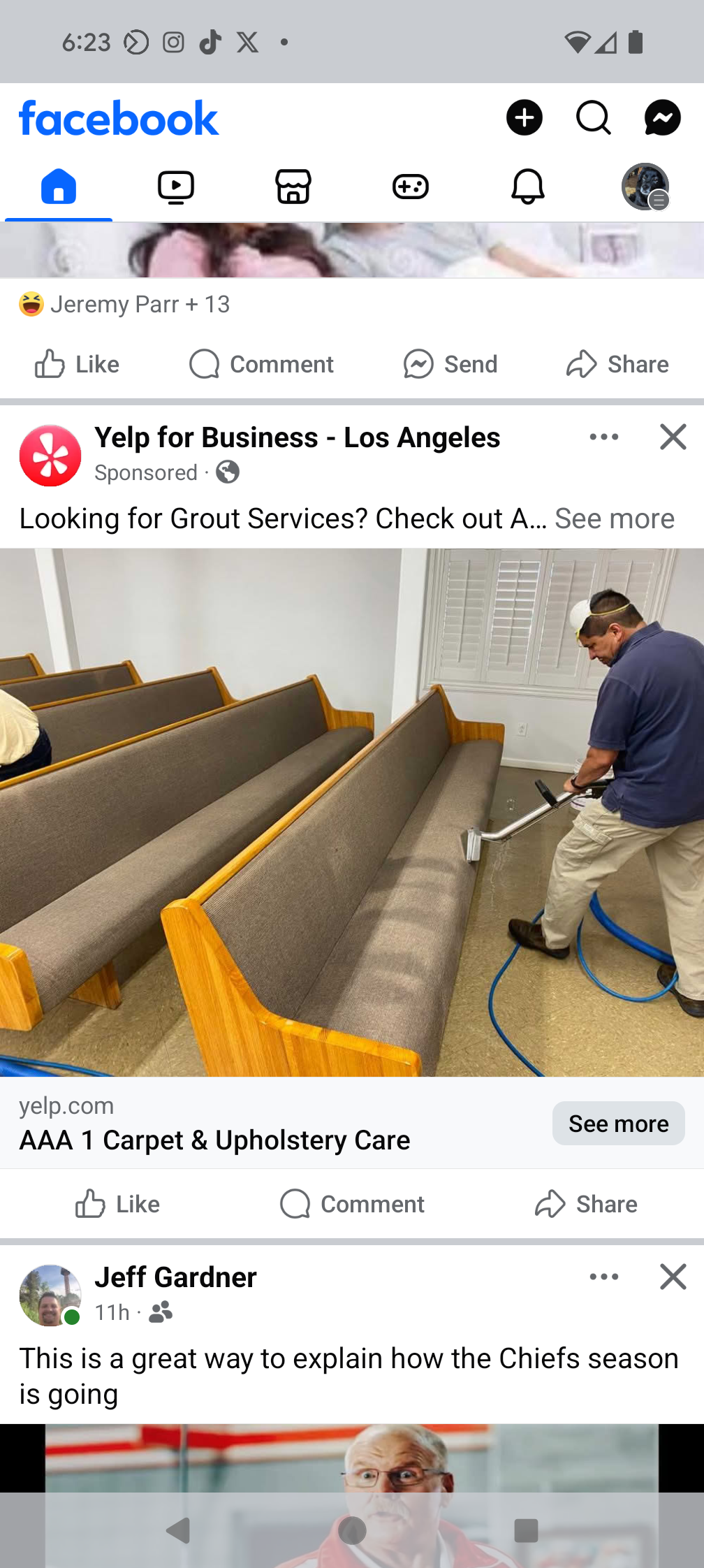

11,491
I think I found you a customer Doah!
