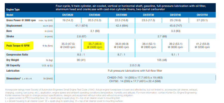

Full throttle on these units is not full RPM
2600rpm for the 3 and 4cyl engines
2800-3000rpm for the air cooled engines

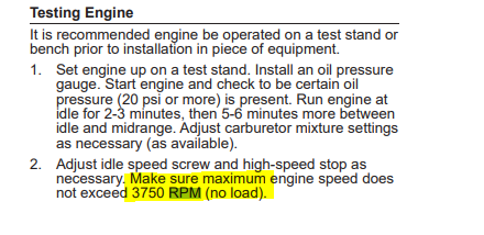

Which is closer to full RPM? 3000 RPM when max RPM is 3750 or 2000 RPM when max RPM is 5000?

I don't understand your logic on that. 3000rpm isn't max rpm.
My point to you was these engines have plenty of room to pull more power and air to cool it down. Why are the air cooled tm engines set at 3000max when my zero turn mower is set at 3300?
Most of the headaches I've had with the 6 truckmounts I've owned could've been prevented

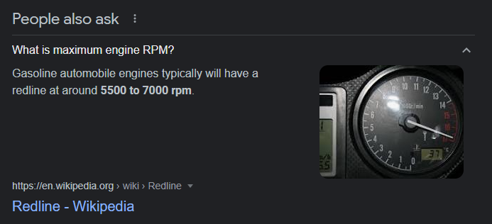

The point is it's running at a much higher percentage of max RPM. 80+% in the example. Industrial engines (most) are specd for power at a much lower rpm. Also the sweet spot isn't usually at peak rpm (curve starts to flatten)
Cars generally aren't run continually in the upper rpm range of 5k+ (80% of redline)

Your zero turn mower isn't spinning a blower and pump as well...
All of that has to be taken in consideration when calculation when figuring out what RPM to spin the motor. And as Fred said, these motors are already spinning over 80% and peak hp/torque is never at max rpm 🤷‍♂️

I have always read that air cooled engines are designed to run at close to max and run cooler then.
3000 RPM is fairly close to max. As I was telling Matt yesterday over text messaging, you also have to factor in RPM of the blower and pump. He suggested changing pulley sizes, however if you do that, you are lowering the RPM of the blower which will also lower the CFM, and lower the heat. Same goes for the pump. Would you rather run your motor at max RPM 100% of the time which will create more wear and tear on the motor, or have more CFM and more heat? 🤷‍♂️

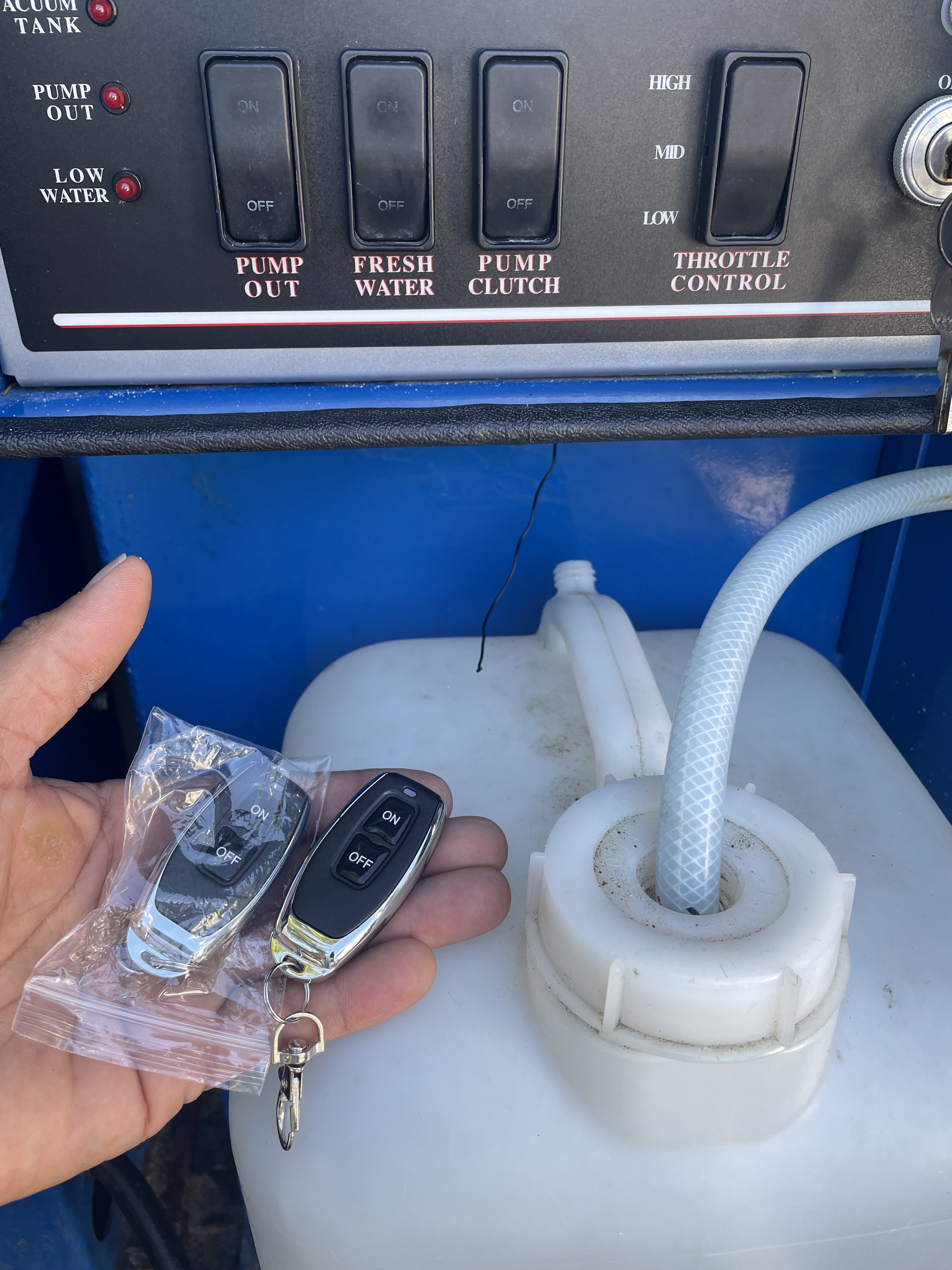

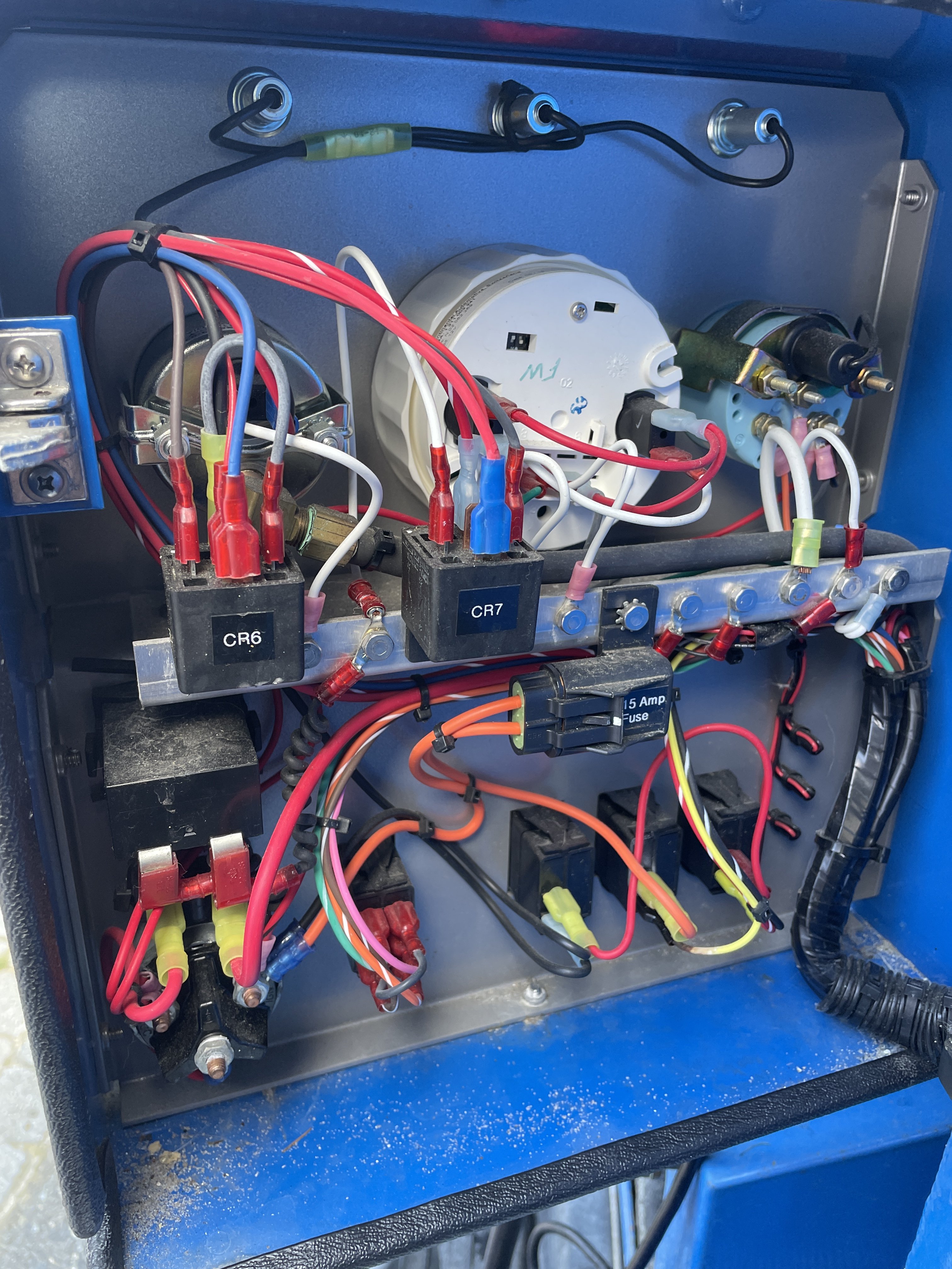

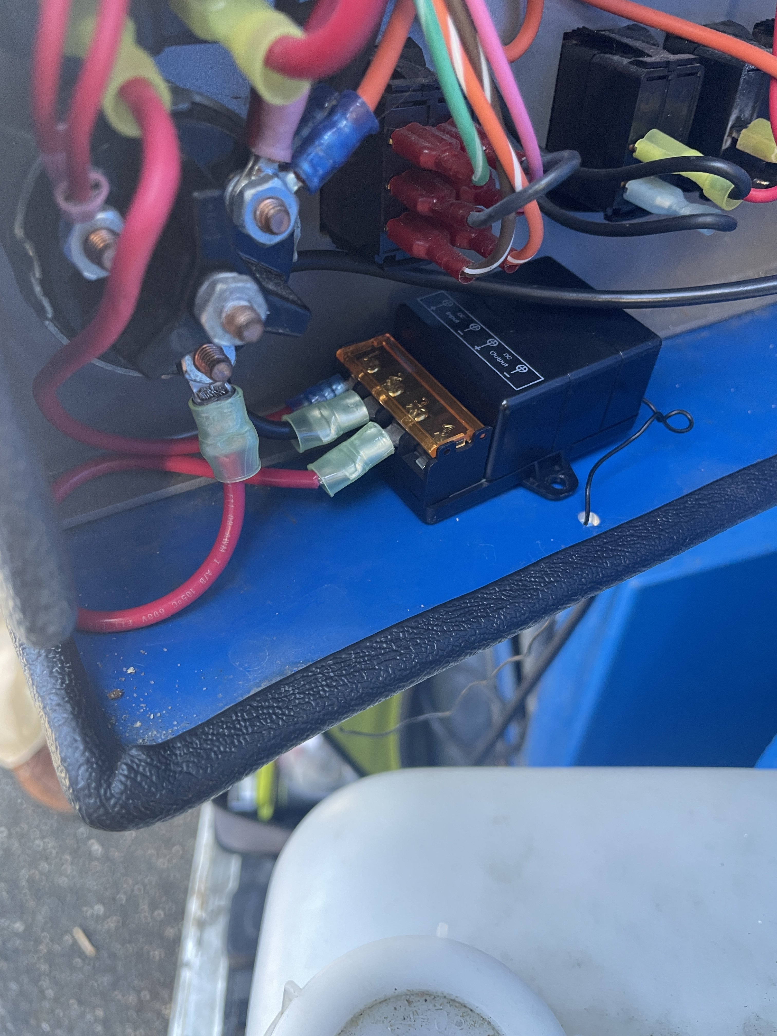

All Done.
Before
After
Remotes with the antenna dangling
Running
Totally stoked.

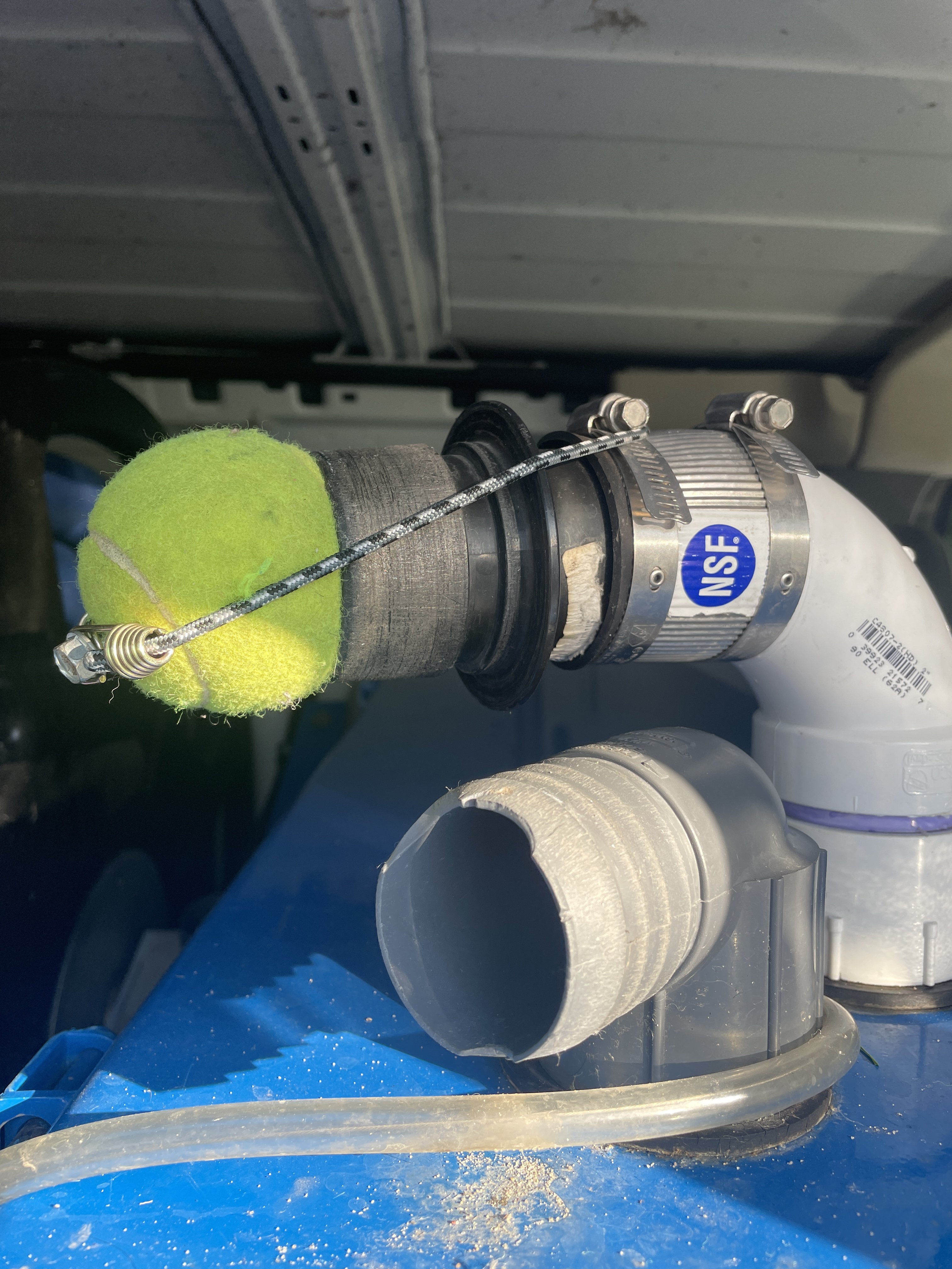

Loving this option after a couple days. First time I restarted remotely I had no suction. the tennis ball fell out of port 2 when machine off. Never liked the ports on this machine and had to customize from the start. My old Thermalwave has nice ports welded on and have rubber cap that I don't need to play around with. On this machine, not the case. I will find one soon, but for the last 6 years just been plugging with a piece of wood or a tennis ball.
Here is the quick fix. Now im set, and looks so high tech lol
