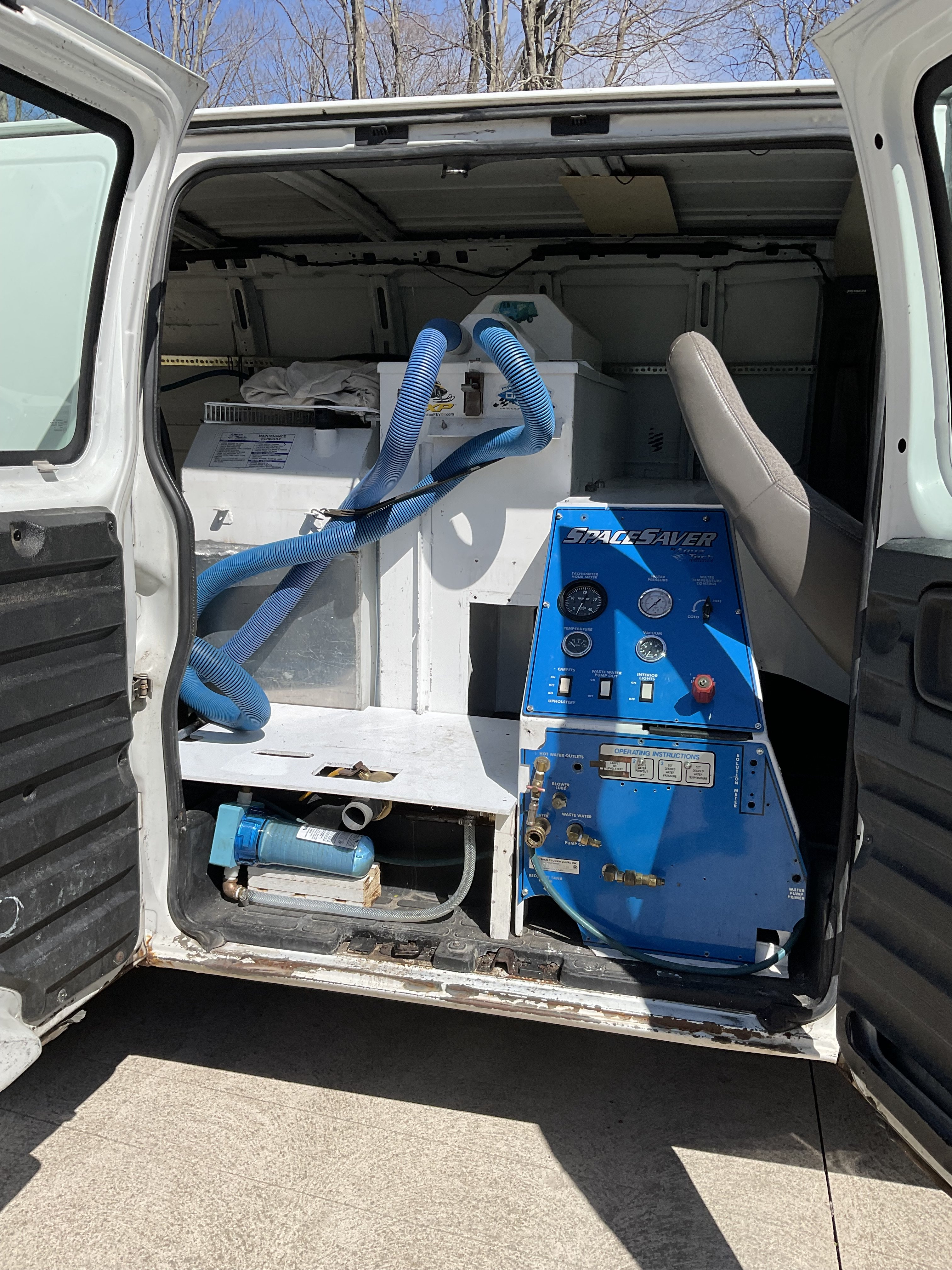

I’m taking it to the forklift later this week to move it. Rubber mats underneath are getting pulled up.
The waste tank was behind it but I think I’m gonna move it to the left side of the machine for better mounting space and ease of access to the rear and right side of the machine.
The van needs a power steering fluid reservoir, a tuneup, and a new rear door
As for the tm, the water pump needs tlc, and the 185f thermal relief valve needs replaced. 🤞. Once I get it completed, we’ll see what other issues it might have

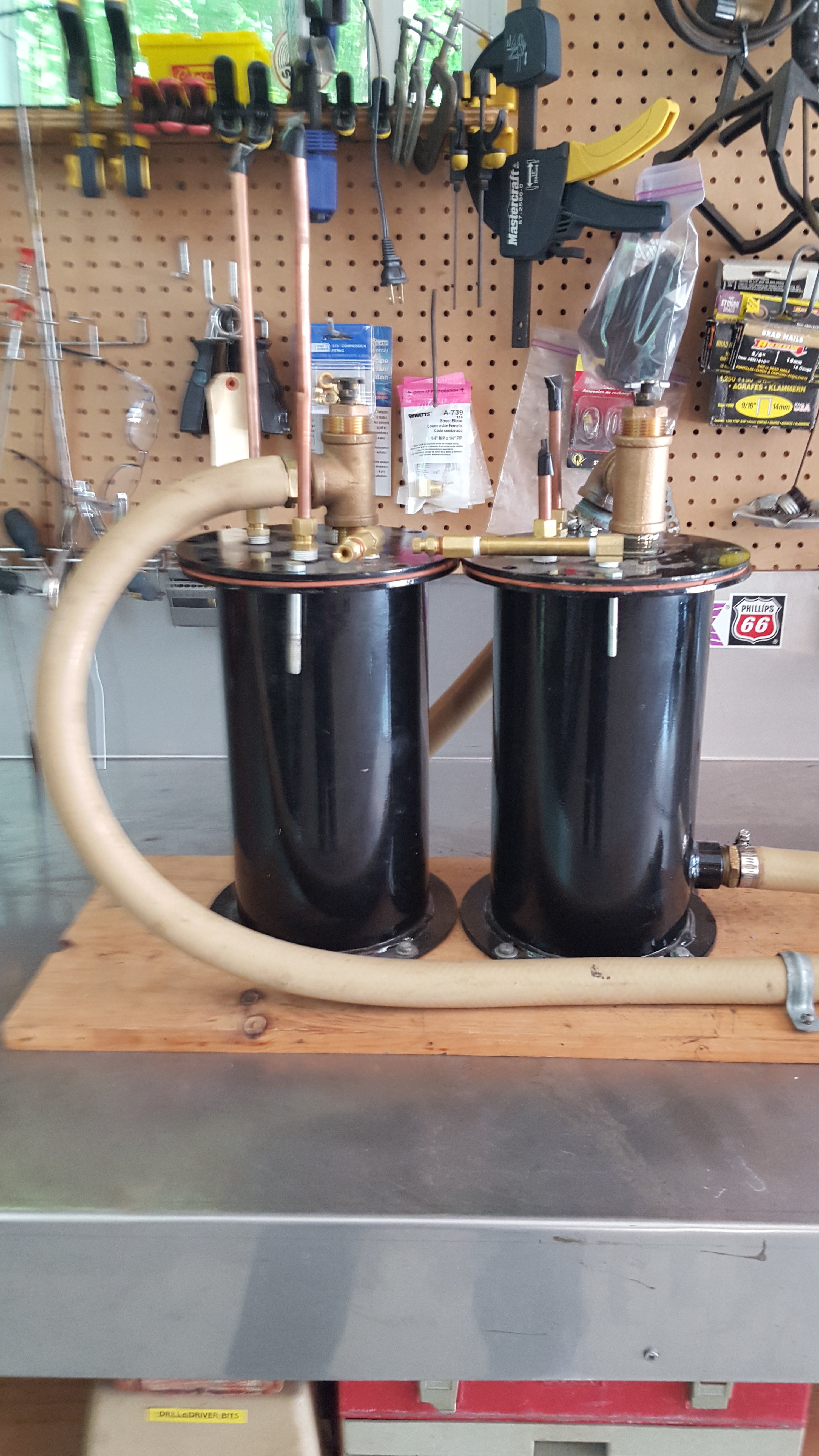

Doing a little adjusting
The coolant heat exchanger was just a last minute slap on. I never had time to properly mount it. So here’s the before and after. I bought the wrong color paint for it to 😒

That plate of metal looks like crap.
I’ll clean that up and make it more flush with the mounting plate

On my setup, I put a 1” tee athe high point of the exchangers, and can fill with a funnel, then cap the tee. There are petcocks on the two exchangers that can be used to bleed air also.

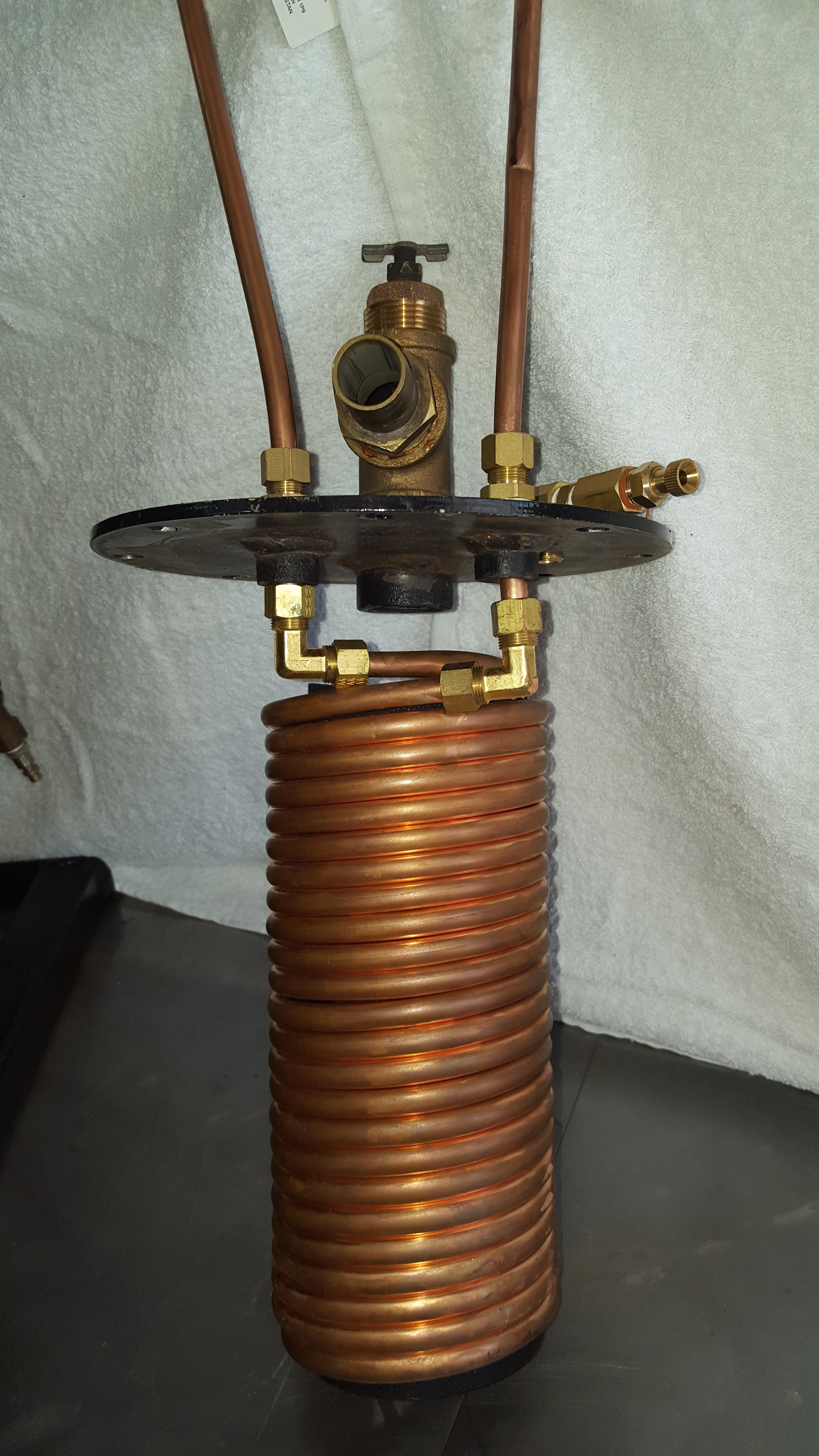

I would think most of the clutch drive units may have been designed off this brand.
These are from my AquaTech manufactured in Kelowna BC. Cleanco bought out the company years ago.
I rebuilt these years ago, and have never installed them yet. I had the coils wrapped by a company in Toronto.

Looks like a solid design. Just keep the pressure under 1200psi since the coils are copper. But two coolant heat exchangers should give you constant, reliable heat
