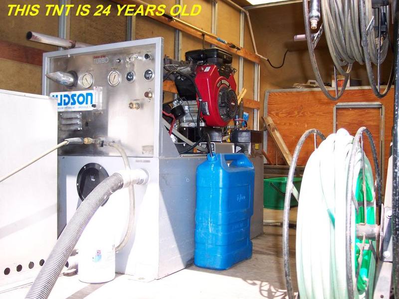

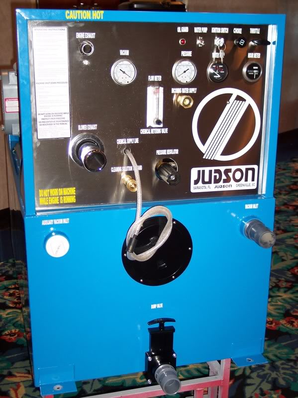

Seeing that the post is about simple design truck mounts, and that the post that Brian Luddy put in the clean room with photographs of the unit that you are talking about has been moved. I'm now going to post some pictures of the unit that you are talking about that was at MikeFest.
I'm also going to post some picture's of the Judson TNT, that has to be the world's most simplest designed truck mount. The TNT stated production in late 1973 and is still in production today, this makes it the oldest machine still in production.
We have hundreds of TNT's still running after 34 years. I guess what makes the TNT last so long is that it's all stainless steel, has the most common parts and is the easiest to repair.

Les, I got a feeling you're gonna be selling a lot of these. What type of chemical injection system does it use?

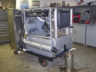

Personally, I've always taken pains to make the systems as small as possible, without clutter. This system, for instance, a "Predator 36", has a footprint that's only 20" wide and 62 inches long, including the recovery tank.
This one's a bit rough. The background wasn't cut away. But you can see that it's even smaller... It's just 57" long. And it has "no" recovery tank. The "CP" stands for "continuous pump out". So, it simply pumps out (at 50 GPM) continuously. Great for floods... or large jobs, in addition to standard ones...
This is an older style frame. These systems are built on the open frame design, that allows easy access to everything underneath and has the motor slide mount...
These days, with gasoline prices at such a high rate, I feel more than ever that the "CP" systems like Predator CP's and Predator Unleashed! make a lot of sense.

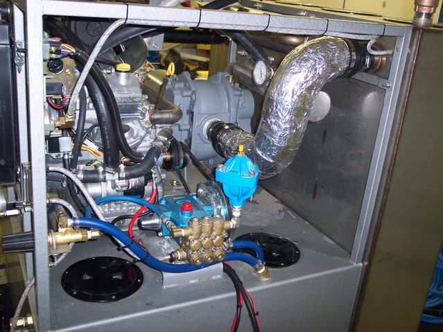

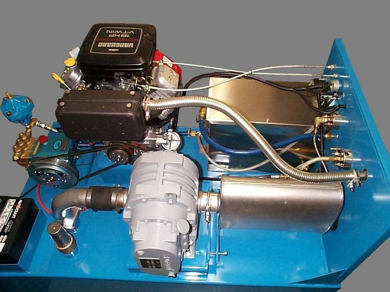

Questions for Leslie and/or Larry:
On the hypro pump, 3rd pic down from top, it is plumbed using all four (2 inflow and 2 outflow) connections but in the 5th pic down 1 inflow and 1 outflow are capped off. Why is that?
On the advertising flyer above is says the recommended RPMs for that 18hp Vanguard is 2900. I have a 21hp and I was told never to go over 1700 RPMs. I know if I run higher I will get more heat and better suction. Any thoughts on this?
